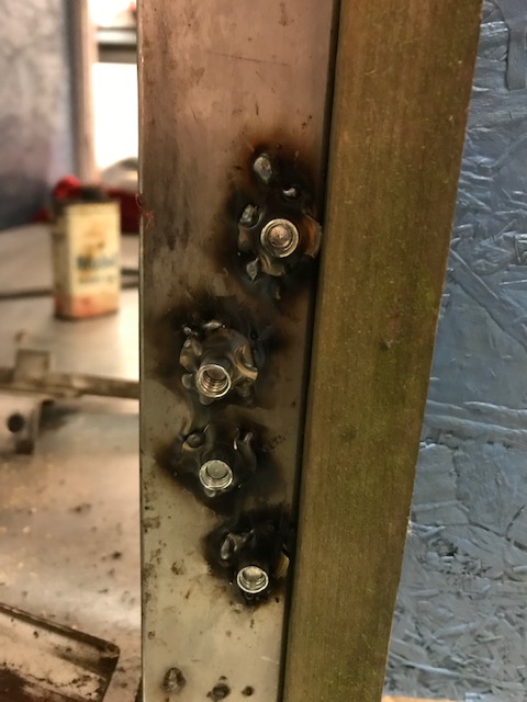

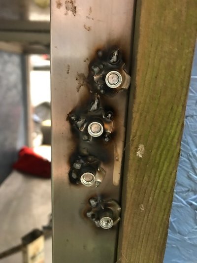

    Ok so Tee nuts looked like a great suggestion and worked well i have tugged on these nuts and they are not budging, not pretty but doesn't need to be.

  10. MoreWellie Member

    I know that you have done this now but.....
    just in case a similar application comes up in future, have a search for rivnuts
  11. Snowy90
    Snowy90 Member
    Messages:
    156
    Location:
    Poor Part of Surrey
    Good call, i did think about rivnuts but the door was already fitted and up against it in terms of time.
  12. Paul.
    Paul. Moderator Staff Member
    Messages:
    6,389
    Location:
    Northampton. UK
    If you have to do this again turn your welder up, hit it hot and fast, it will look much neater and give a smaller tack,

    indy4x Forum Supporter
    Messages:
    1,651
    Location:
    Pontypool, South Wales. UK
    Too late for this thread but I have used nyloc nuts as captive nuts in the past. As is to be expected the nyloc bit doesn't like the heat from welding but no problems with the bolt sticking to the melted plastic
    Just to add, the nylocs were not a conscious choice, all I had
    Hopefuldave likes this.
  14. Snowy90
    Snowy90 Member
    Messages:
    156
    Location:
    Poor Part of Surrey
    I must admit i did try the nyloc before i got the T nuts didnt melt the plastic but couldn't get decent penetration might be the coating, or just shy as scared i would fuse the bolt.
  15. Snowy90
    Snowy90 Member
    Messages:
    156
    Location:
    Poor Part of Surrey
    I used 1 min s will try that next time!
