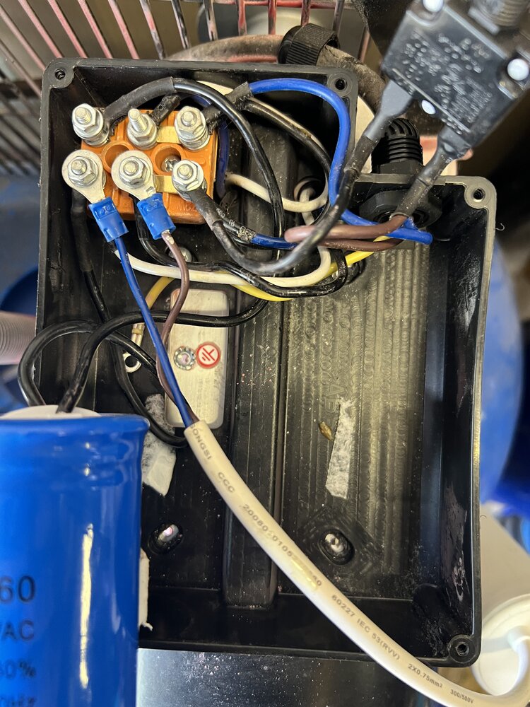

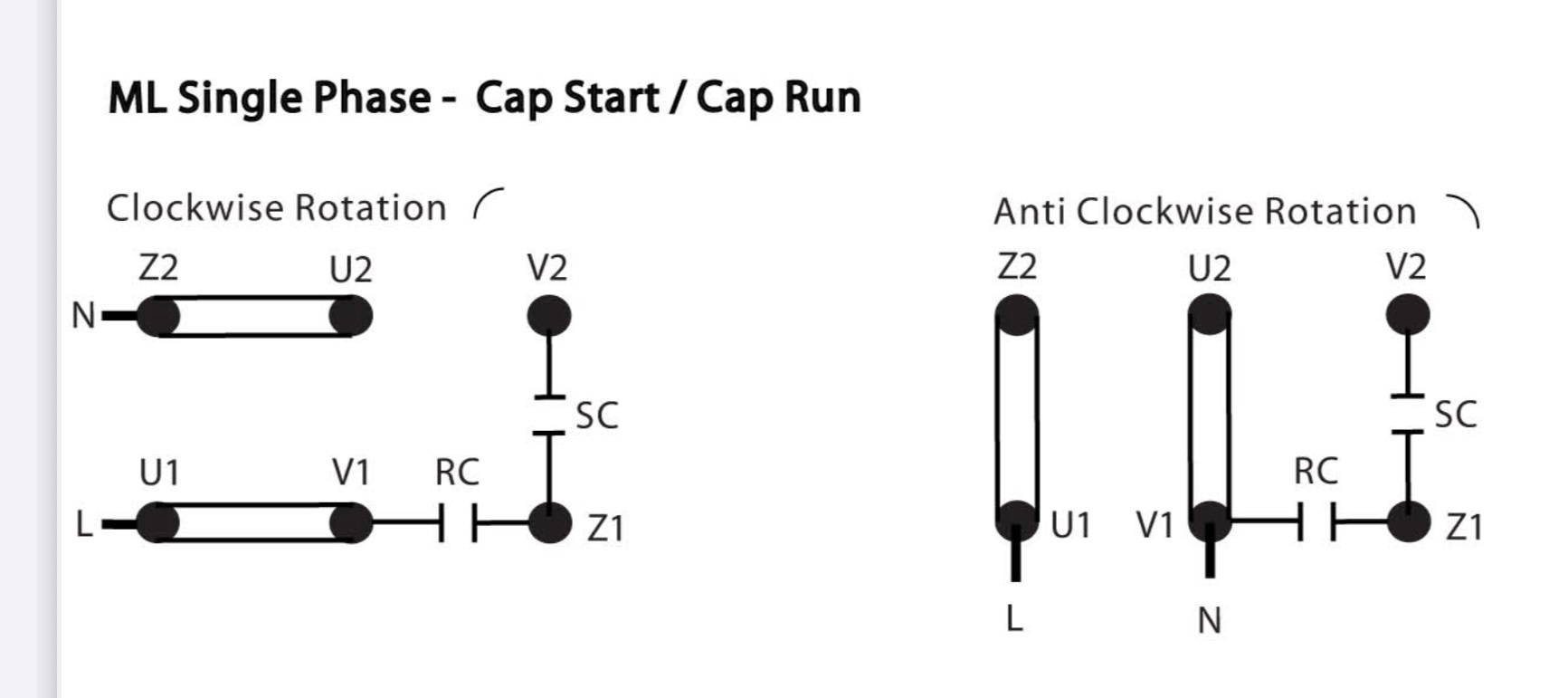

Hi does anyone have (or can take a photo) of the wiring connections for the capacitors/motor
My compressor stopped - made humming noise when switching on and then popped breaker at consumer unit.
From searches it was likely to be the capacitor - bought new and fitted - thought I had copied wiring, but now doesn’t even hum.
So thinking I’ve connected something wrong - should have taken a before photo
This is area I’m looking for in the photo.
