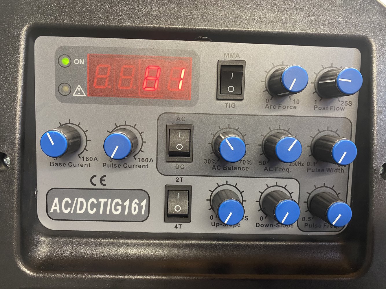

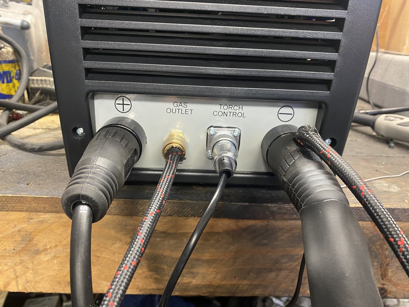

on ac there is no polarity so doesent matter what side leads are in toNo you don't, you just flick the switch from DC to AC.
All TIG welding has the torch on the Negative.
edit Welcome to the forum MickeyW![]()
Unless you have a machine with modern features like cap shaping and balance controls... in which case yes it does matter...on ac there is no polarity so doesent matter what side leads are in to
ah rite enaffUnless you have a machine with modern features like cap shaping and balance controls... in which case yes it does matter...
