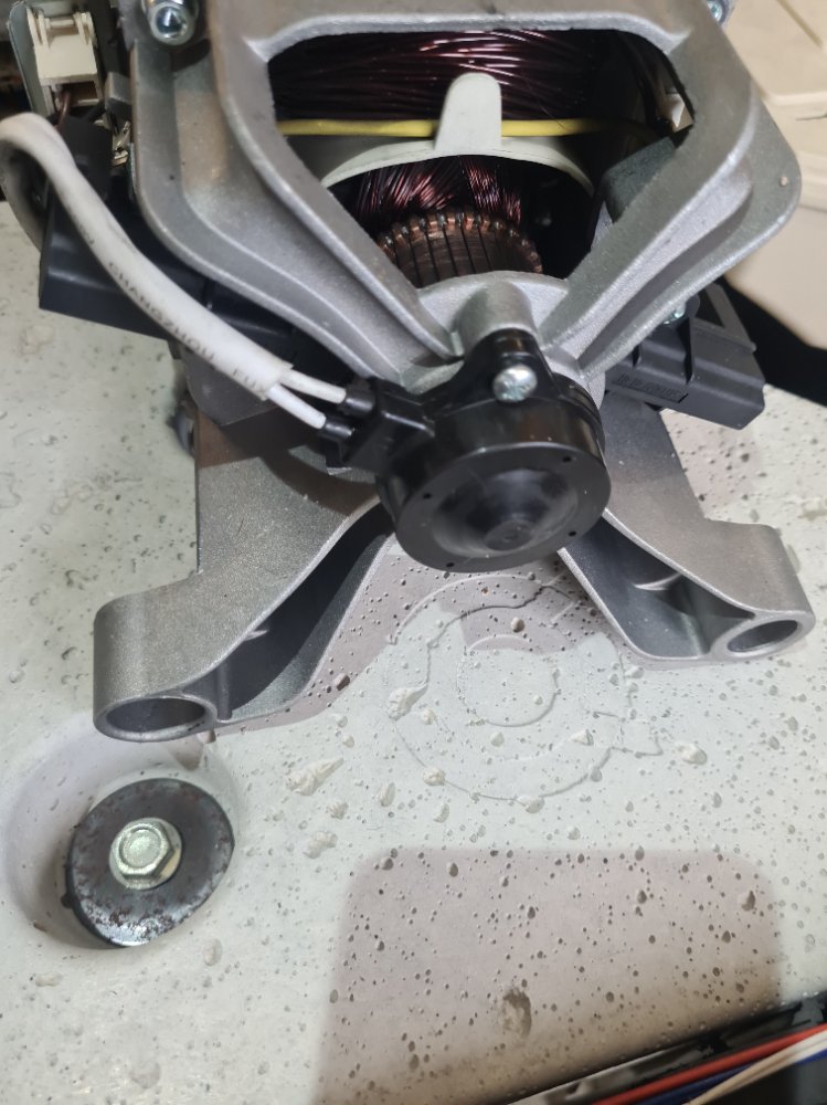

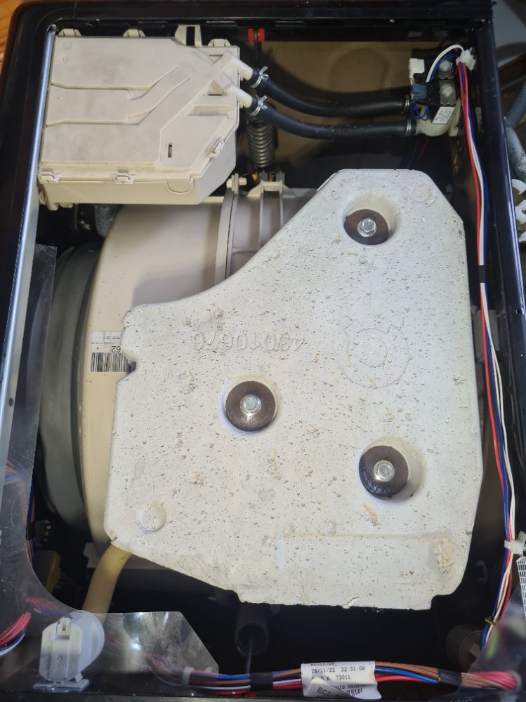

I have a candy washing machine,
Towards the end of the wash it has started violently vibrating and jumping around then stops with an E08 error code.
My missus had googled the problem and said it was probably the motor brushes either worn out or sticking.
I removed the motor and checked/cleaned the brushes which looked fine.
Didn't help.
I then googled myself and found some suggestions that it might be the motor speed sensor.
I have not been able to identify the speed sensor on the parts diagram but I reckon its the ABS type thing mounted on the rear of the motor.
Couldn't find one separately so I bought a complete motor and the machine still has the same problem.
There are 2 shock-absorber things holding the drum but they seem ok (only checked by hand)
Any other ideas before it goes to the scrap and I just get a new one?
