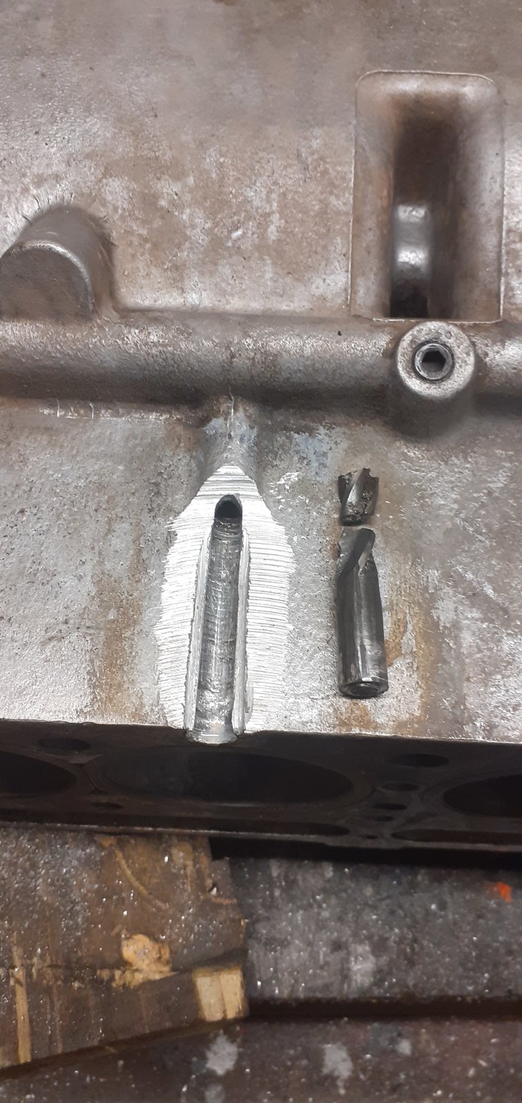

mike os just a little insane..... Messages 9,777 Location North Wales Dec 27, 2020 #61 Life lesson... reserve carbide for when there really is little other option
Spark plug Member Messages 4,061 Location Durham, England Dec 27, 2020 #62 Yes you can spark erode tungsten carbide, a place I used to work had 6 wire EDM’s running 24/7 cutting carbide discs to make form tools for making the fins for car radiators and intercoolers.
Brad93 Member Messages 19,430 Location Essex, United Kingdom Dec 27, 2020 #63 You could of used a portable edm drilling machine. Would of spark eroded that out fairly easily.
