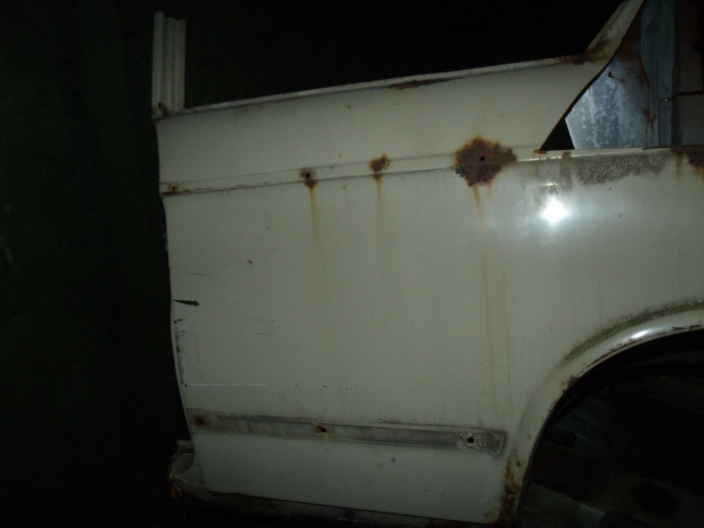

Your in luck Dean. That bit on the scrap shell is ok. Well, when I say OK !! I mean, it's better than yours !! ;-)
Some surface rust on the waistline trim holes, but on the whole very good. I'll cut it out for you this weekend, weather permitting, as it is outside. I'll drop you a PM to discuss the postage.
The pic was taken in the dark, so it isn't great, but you can see what you need.

There is a good passenger side chassis rail, which I have removed complete, a spare wheel tub in pretty good condition, a good condition round light rear panel already removed and the early centre nostrils to adapt a later front panel, if needed. I have these advertised for sale. There are still two decent inner wings attached, one good strut tower and one in need of minor repair and a bit of odd floor in good condition.
To be honest mate, I was just going to scrap it. I would much prefer someone to make use of the metal that is left, if it is of use. I have cut it in half, so it would be pretty easy to take away with a pick up TBH !!!! I might advertise it as a freebie and see what happens. After I get your bit of course ;-)

Just wanted to say cheers in advance to B1N9S for the scrap piece he's sending me to repair this area. Top bloke.
If anyone else has any scrap 02 pieces they don't mind parting with, please let me know. I do need the same area for the other (drivers) side, amongst a few other pieces, so please let me know.
