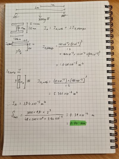

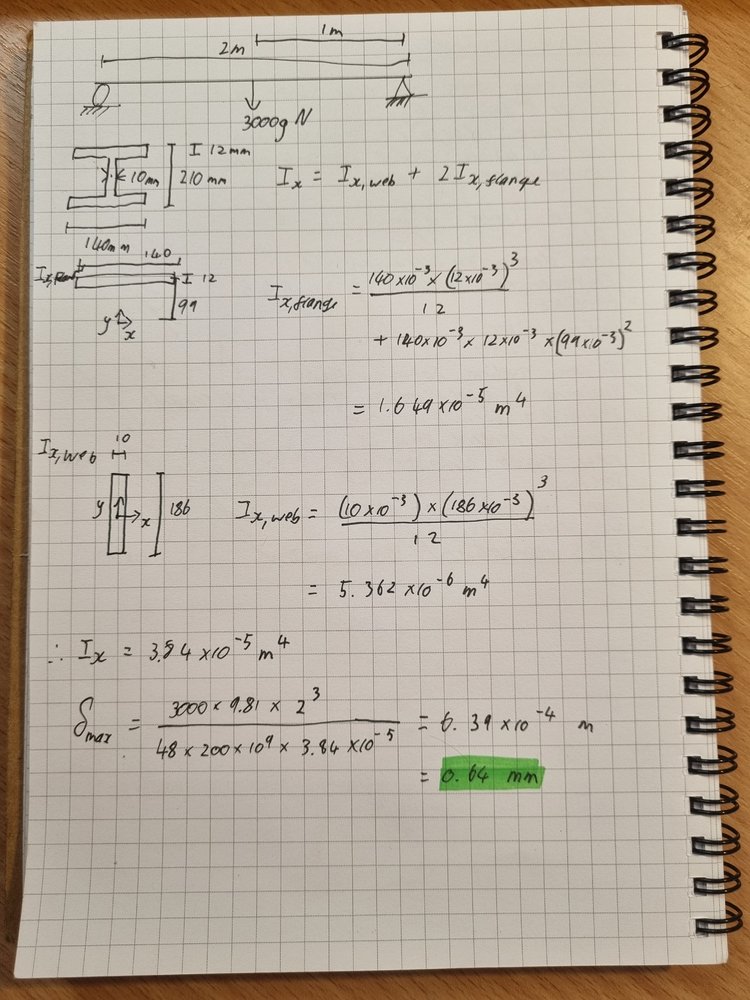

Thanks for all the effort Even if you are 50% out it should be fineJust out of curiosity I tried to work it out on paper, I make the deflection 0.64mm for a 3 tonne load in the centre, which is less than I was expecting so I probably made a mistake.
Excuse the handwriting, I haven't held a pen all year.
That does assume the Youngs modulus of the steel is 200GPa, the ends are simply supported, the load is static, there's no flaws or defects, the cows are spherical and in a vacuum, etc etc. Don't crush yourself following the advice of someone on the internet pretending to be an engineer.![]()
As long as you tighten the bolts until they strip, then back them off a quarter turn , you will be fineThanks for all the effort Even if you are 50% out it should be fine![]()
Brilliant! I thought it looked far better than the modern ones rated at much higher loads!Hi fizzy with the beam dimensions you have provided and a free span of 2000mm a 3000Kg [29430N] load will produce a maximum stress in the beam of somewhere around 40N/mm*. If this beam is loaded to a permissible stress level of around 180N/mm* it will carry around 13000Kg [125530N]. If your beam in a reasonable condition it should be trouble free as a lifting support. Good luck and work safely.
