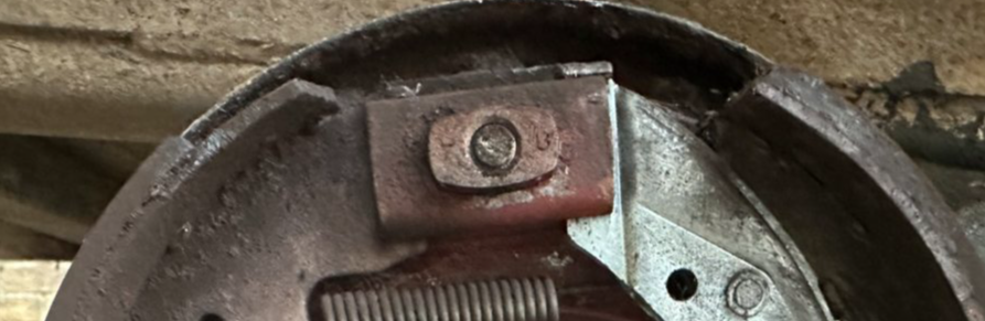

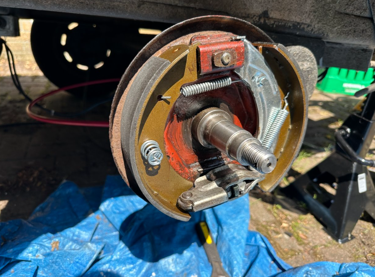

I would check while drums off that the cable is free, at both the brake and where it enters the outer casing under the trailer. Id also make sure the adjuster top of picture bolt head on the back of the back plate is free. If all good, box it up and adjust as per video
