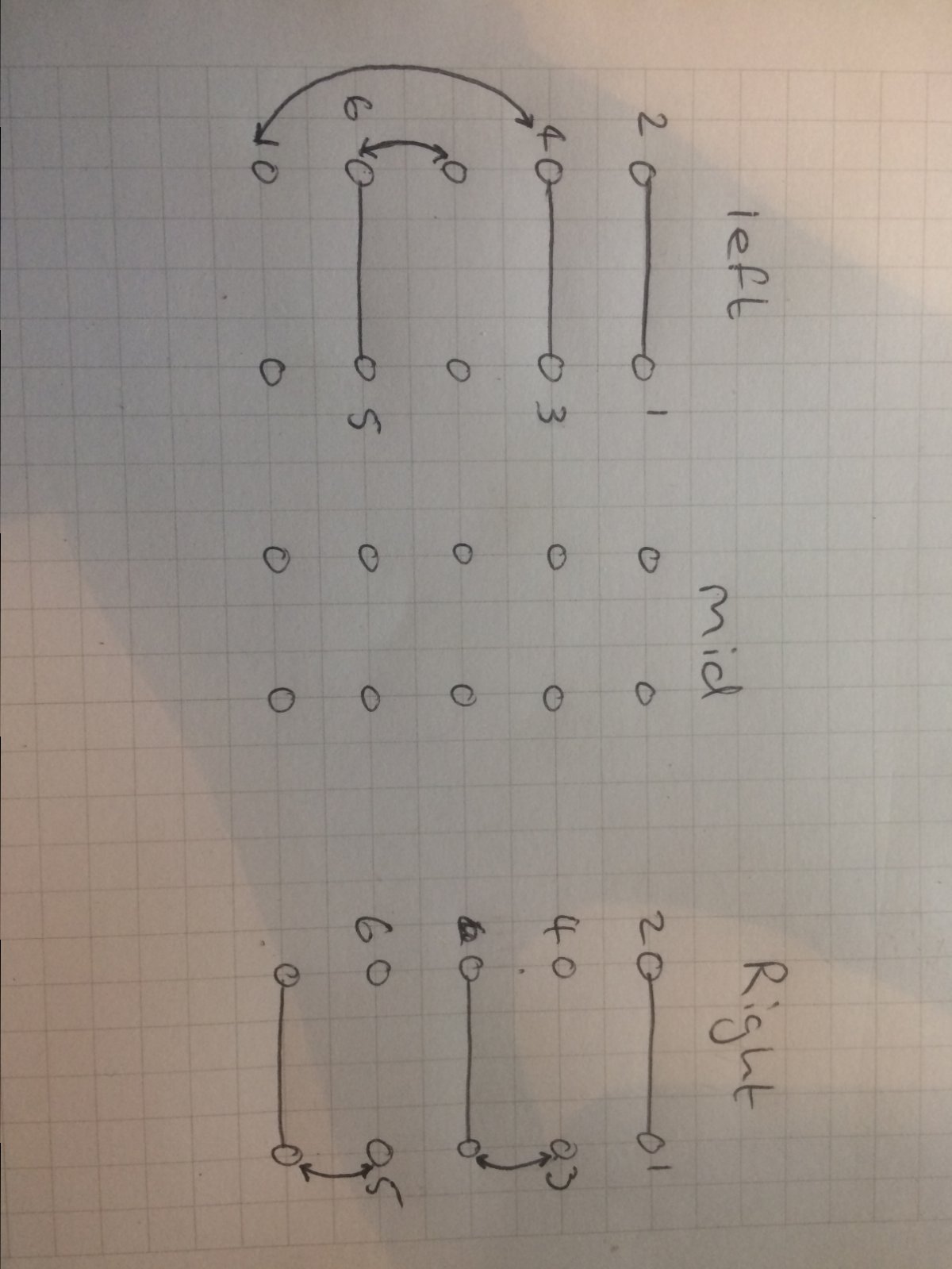

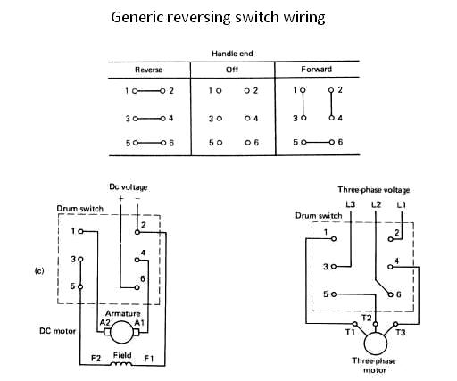

Does it conform to the top diagram when you tap it out with a meter?
BTW, I have wired a third set of contacts through the no-volt release switch when that is possible. This means that with the break-before-make changeover of operating the reversing switch, the contactor will drop out if you try to reverse the motor while it's under power.
