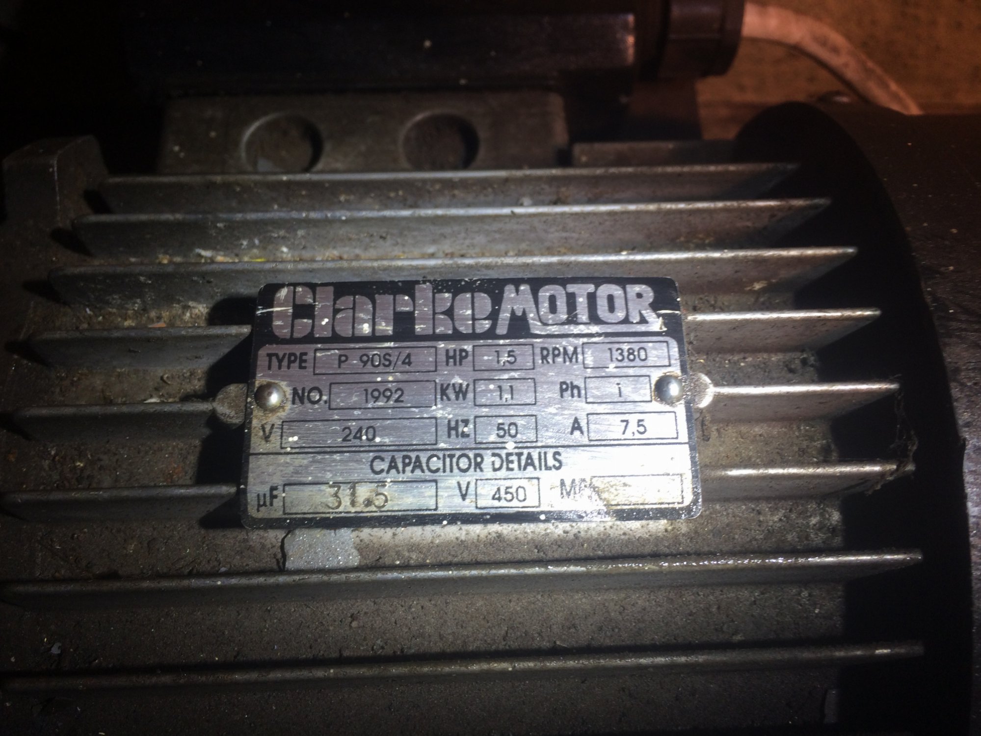

Will do tomoro, I only nipped out quickly to see what the motor actually is in the hope some Google fu might provide the answer. Sadly notProbably, but that data plate ain't not gon be tellin' you nuffink

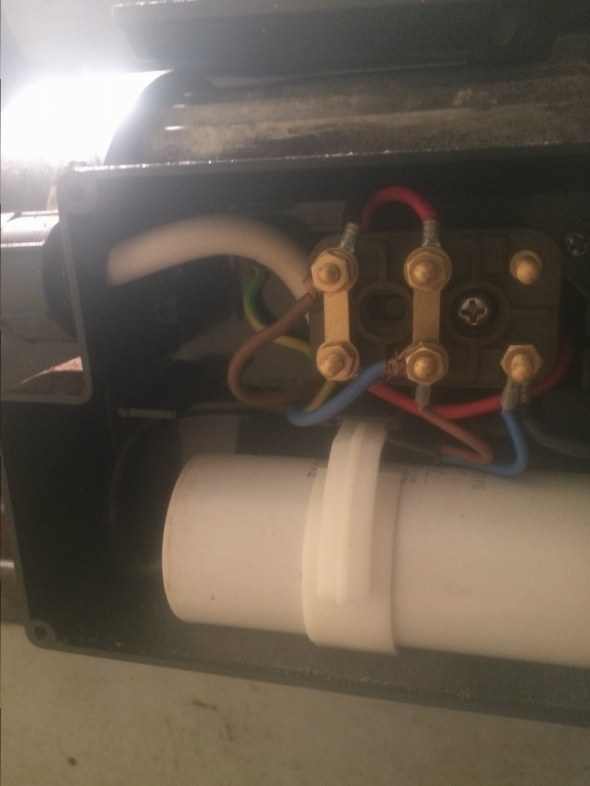

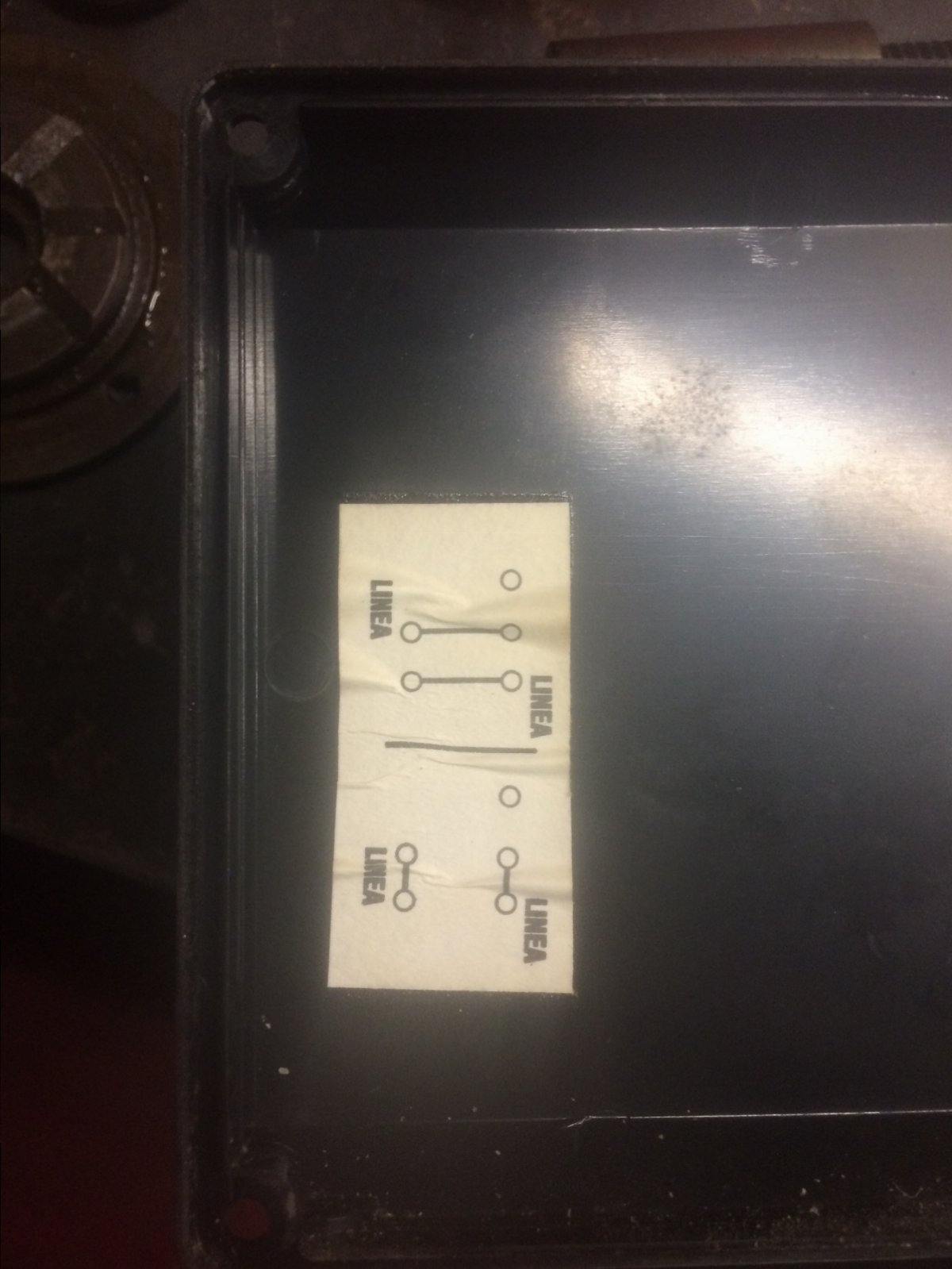

Take the lid off the electric box instead.

I've been fried enough times now to have a healthy fear of leccy, so if I don't post after tomoro, I've poked something I shouldn't have and I'm dead.:I'd be very surprised if it can't be reversed very easily - the Clarke motors are pretty generic and just sold as 'motor' rather than 'motor for xx'.
There should be a diagram inside the box to show what to swap to change direction, then it's just a case of a changeover switch.

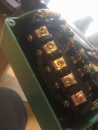

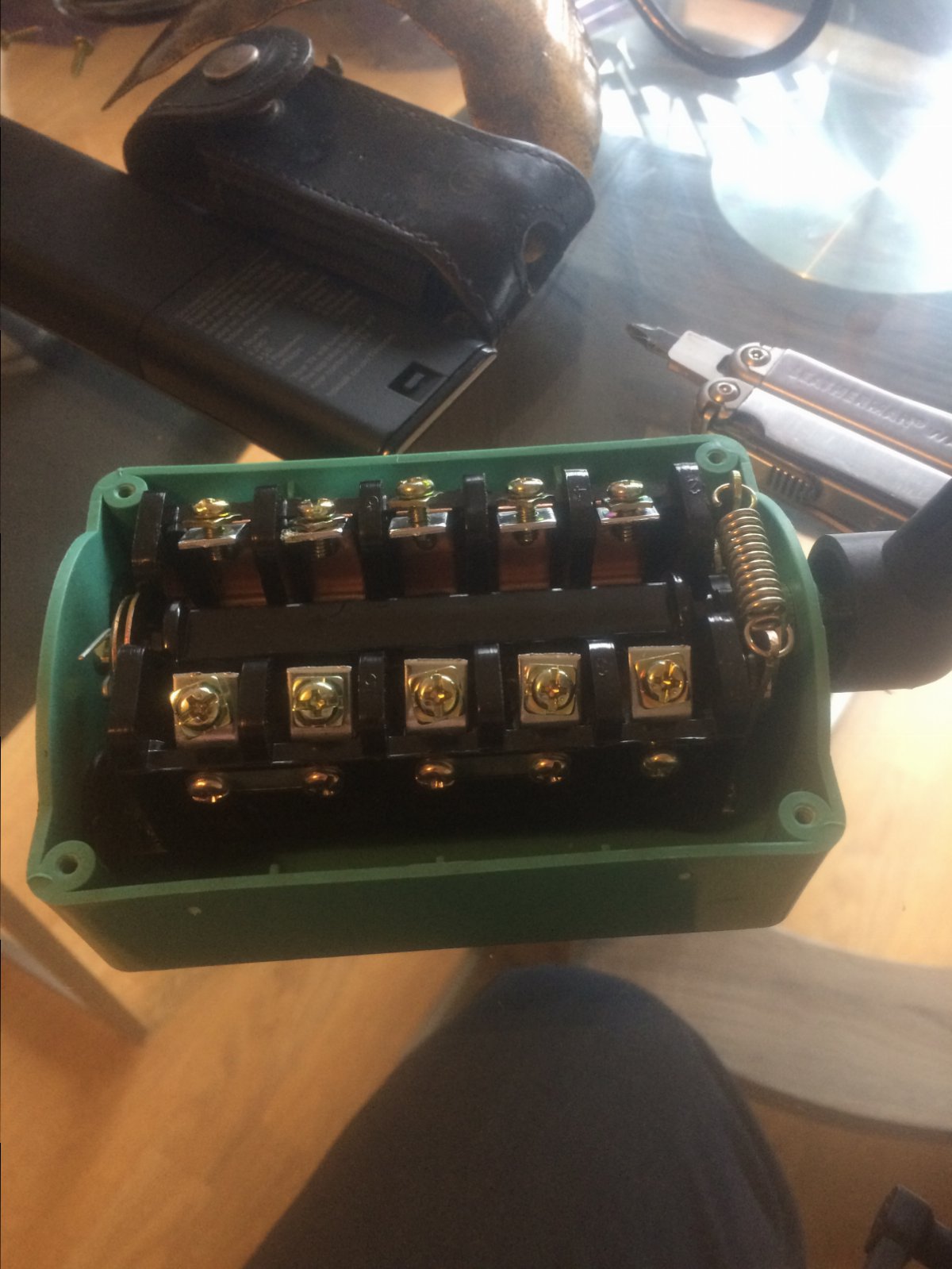

I bought a similar motor to replace the original on my ML7 & easily wired it through the existing Myford reversing switch.now then all, looking st getting a dewhurst switch for the Kerry lathe but as I'm not massively great on electrics, can this motor be reversed?
I'm hoping the /4 on the model number might mean 4 poleI believe that there will be 2 or 4 wires (in the box) that go to the motor windings.
2 wires = non reversible

Told you I'm not a leccy! Hate the stuff with a passionThat has nothing to do with reversibility - only speed...
Shall doGive us a shout when it arrives if the supplied pinout isn't clear![]()
