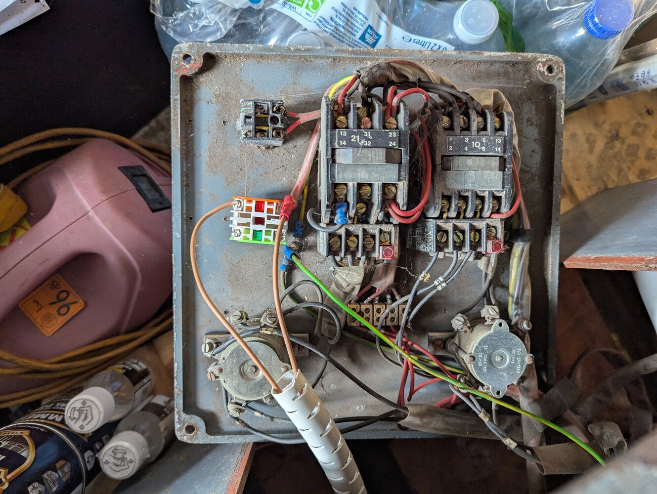

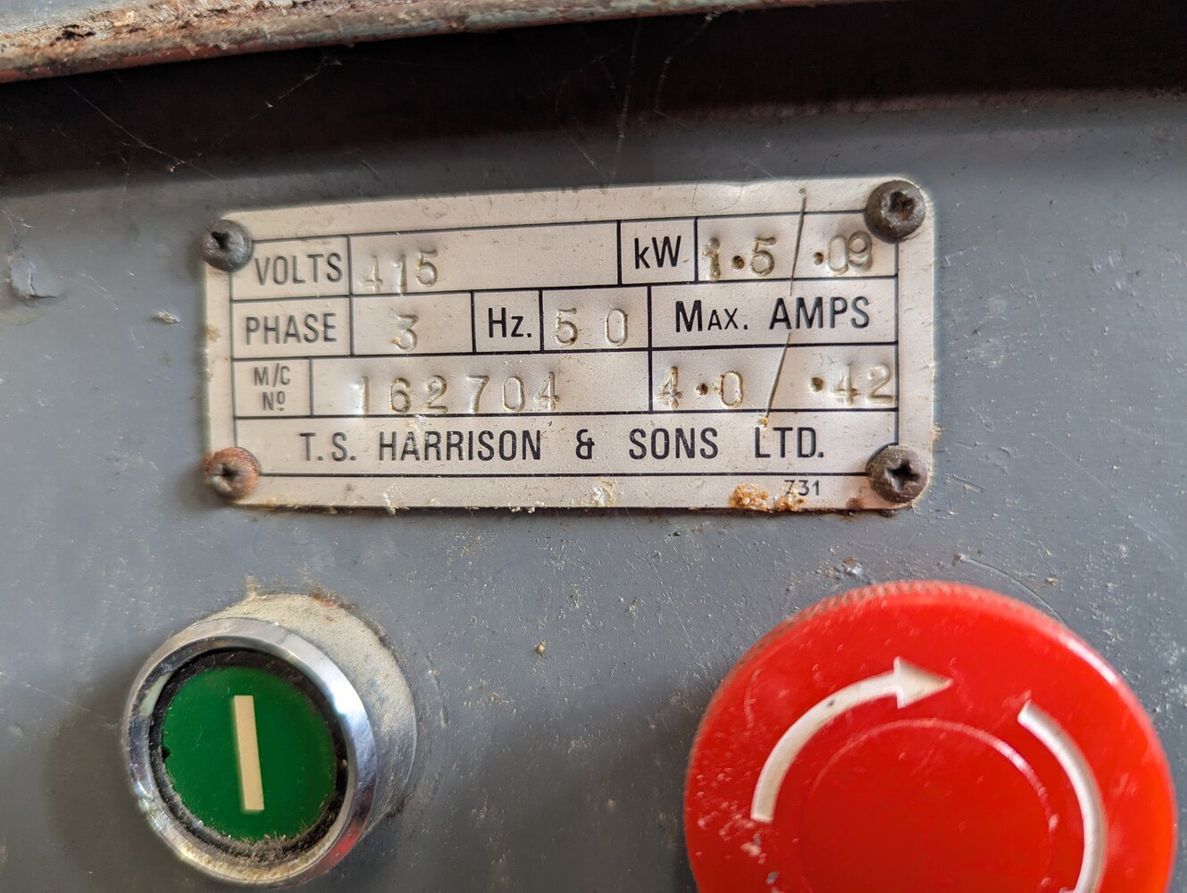

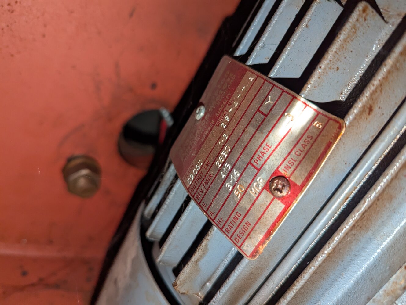

Hi, I have a Harrison milling machine which is 3 phase. Can I run it off a VFD if I don't use the VFD to vary the motor speed? The milling machine has a 3 phase motor which drives the spindle and another which drives the power feed for the table and a third for the suds pump. I'd just like to use a VFD to provide a 3 phase supply at a constant frequency so all 3 motors will run as if they were on a normal 3 phase supply.
I was thinking of using this VFD: https://inverterdrive.com/group/AC-Inverter-Drives-230V/WEG-CFW500B10P0S2DB20C2y2H00/
I found a couple of threads on here where people seem to be doing this but it wasn't clear to me if they were varying the frequency the VFD output so they could vary the motor speeds.
