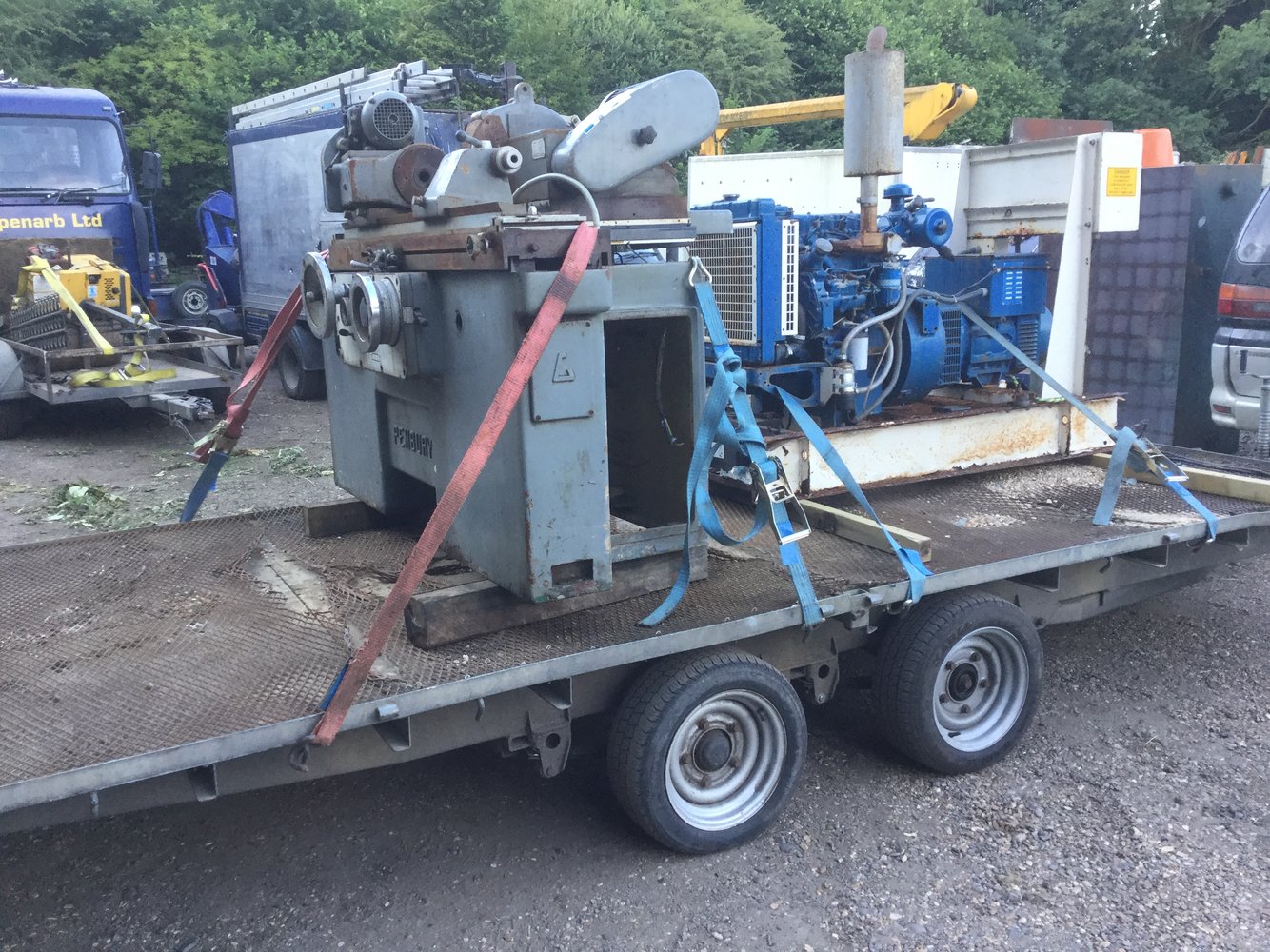

Didn't see that bob.I tried to give a big cylindrical grinder away on here and nobody had a stiffy for it , its now festering outside in the rain until I get a chance to weigh it in

what make was it?

Mag chuck comes with it, that's all I know.Surface grinders can be a money pit - or worse.

How big is big? And how banjoed is it?I tried to give a big cylindrical grinder away on here and nobody had a stiffy for it , its now festering outside in the rain until I get a chance to weigh it in
