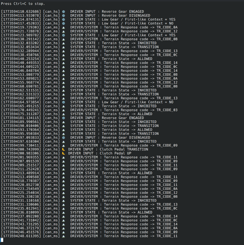

Having installed an Android head unit in the Freelander, and sorted the correct decoder box with both high and low speed bus connections, I was a tad annoyed non of the exciting stuff shows

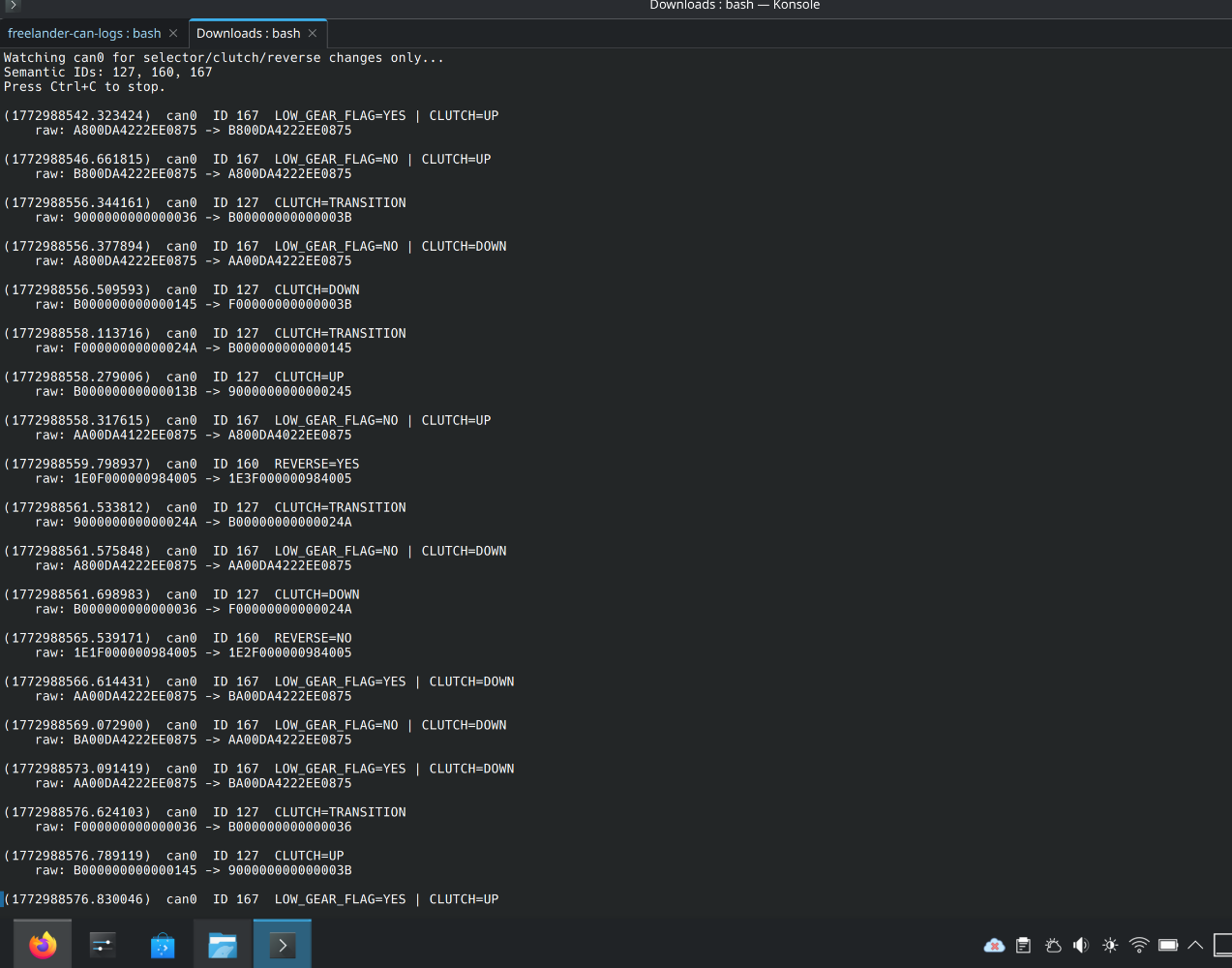

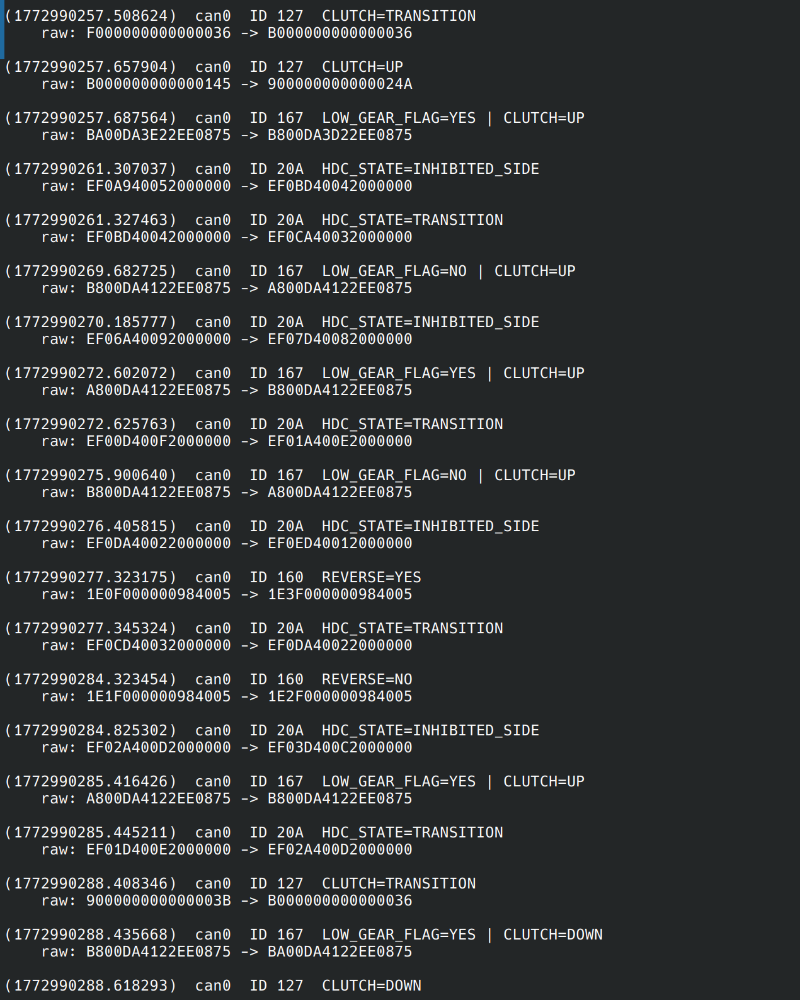

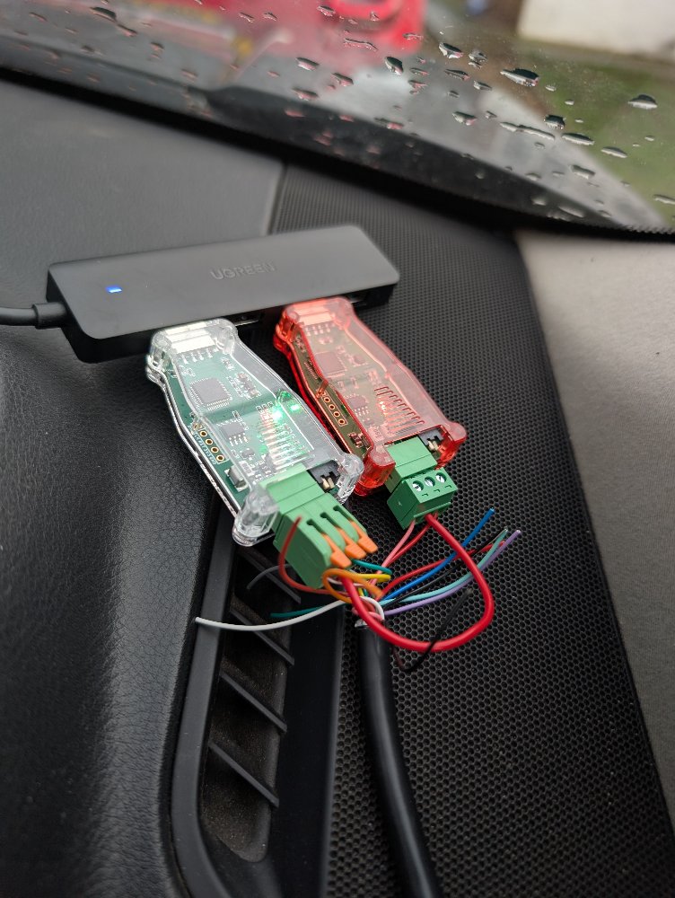

This is a software issue, and as I don't feel like writing an app, I am sniffing the high speed network with a can to usb adapter and some Linux command line fun
I've identified a couple of parameters so far, need to do some methodical logging and work out what is what

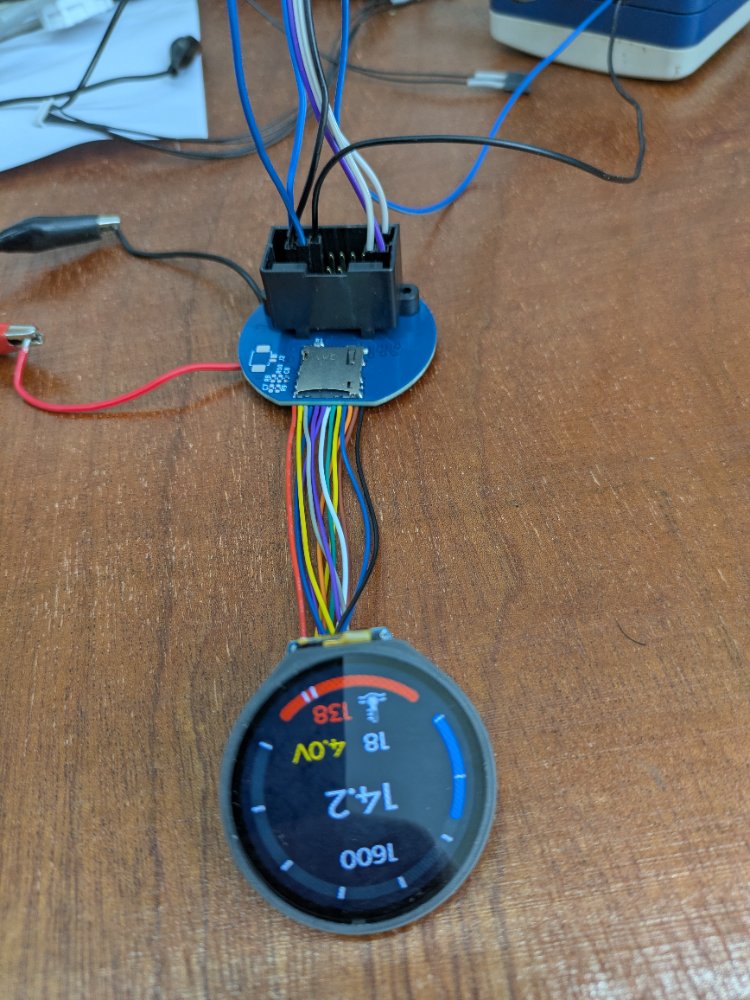

The plan is a small display showing things like what the Haldex is doing etc
More to follow
