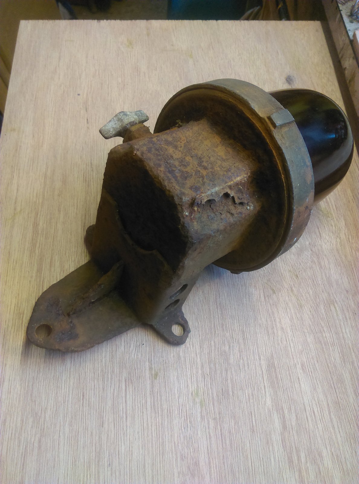

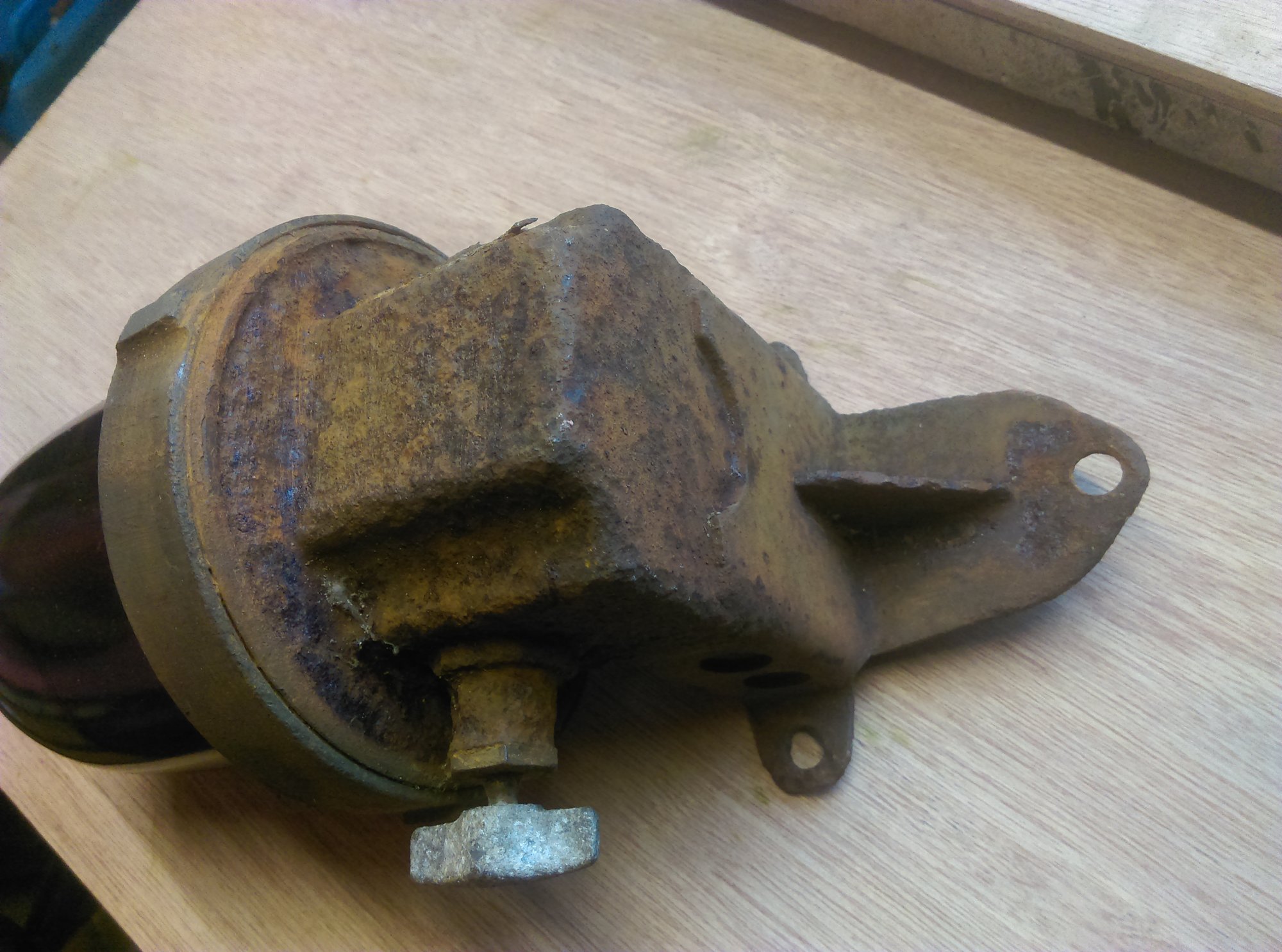

Are they large enough to have a battery inside?

I'd get them held glass down and dribble acetone/atf mix into that flange, leave to soak for a day or two [repeated applications] then gently tap on those 'ribs' with a using a punch - hopefully they would unscrew and free the glass as a starting point.
Piece of wood would be better than a punch.
I looked at that & wondered, also I sort of recognise the switch on the side.Is that undrilled hole in the bottom for a stuffing gland but never been used. Could be NOS ?
