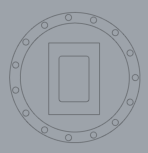

Have got dxfs of them and they nest within each other nicely to reduce the waste.
Ring part is 251mm OD (could be 250mm since few ebay listings sell 250*250) 210mm ID with 15 equally spaced 12mm holes with the hole centre spaced 9mm in from the outside edge.
Rectangular part is 138x98mm with a central 88x58mm cutout with 5mm radius corners.
