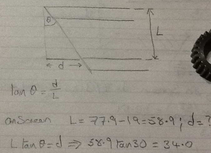

Its like everything else , all worked out on relying on everything is square level and parallel which in the real world is rare.
which is when years of expierence come in but a roofing squares a good starting point. Although I wouldn't say the margin for error gigantic.
I use a run rise calc or mark up on the wall.The problem is really not how to calculate angles and dimensions, the problem is more about which angles and dimensions to calculate.
There's no problem using a roofing square to make a roof (!) but the margin for error is gigantic! Luckily wood is very forgiving so in the real world it doesn't matter unless you're a furniture maker or a boat builder.
Does the run and rise calculator take account of the thickness of the material?
Have you got an example rr calculator to have a look at?
similar here usually test the template at both ends gives a good idea if anything is wildly out.I use a run rise calc or mark up on the wall.
Mark up and cut one joist
Test and adjust
As long as I'm square and parallel I use that as a template for every other rafter.

IKR, it was not a well framed question but the OP was asking for a formula and that is simply to multiply the length you already know by the tangent of the angle you desire.
For 30˚ or 60˚ (and certainly 45˚) the calculations are trivially easy.
Tan opposite/adjacent (TOA)
Sin opposite/hypotenuse (SOH)
Cos opposite/hypotenuse (COH)
The 'difficult" bit is deciding where those measurements should be made and if you need tan, cos or sin.
