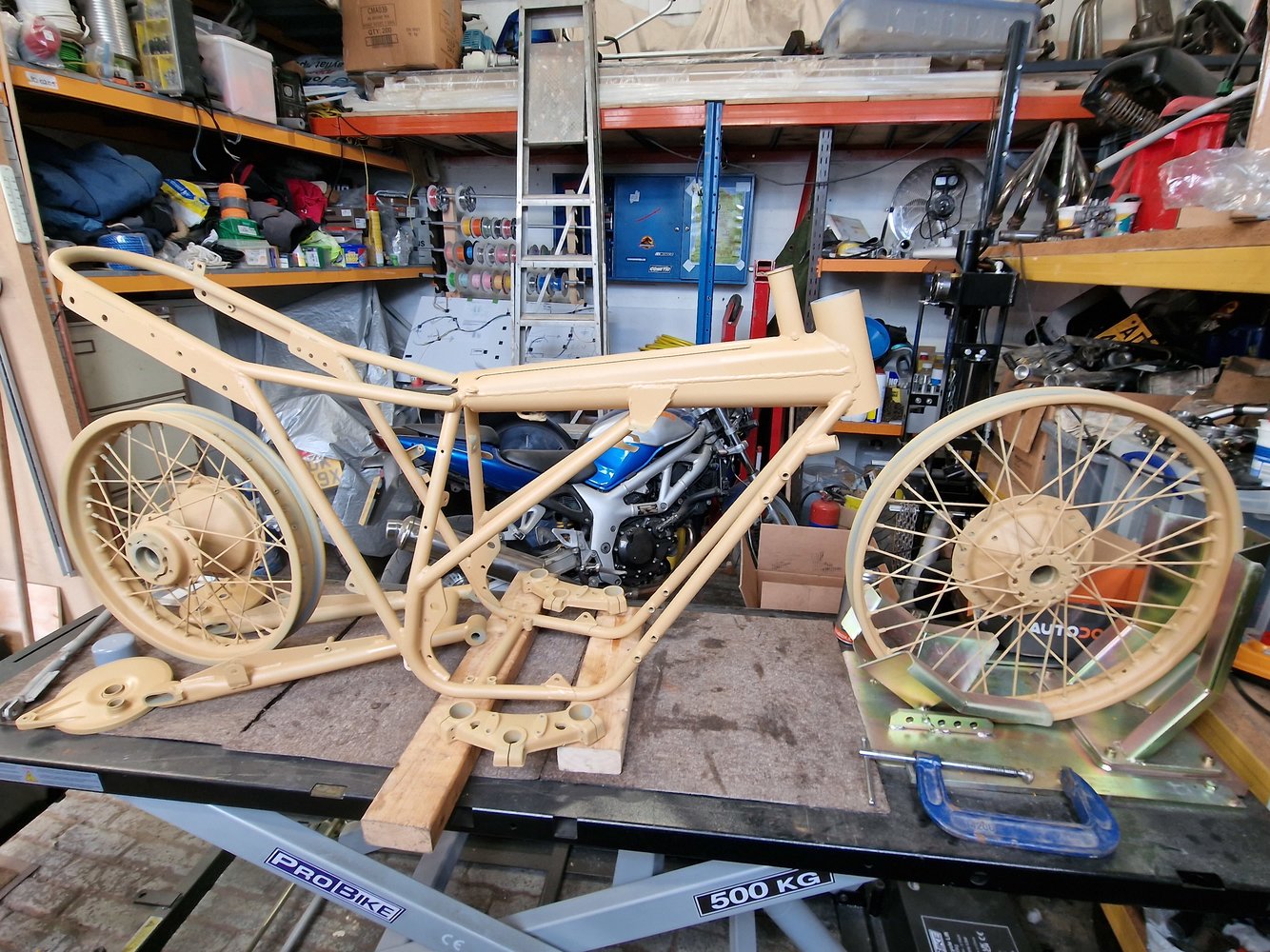

Originally it's part of the 'hiding from the bad men' thing for the military. In this case it's because they were originally painted and had to be stripped, so they'd look rough as if they weren't painted again. Any paint chipped when working on any part of it is given a new coat with a brush when in service, and it'll get the same treatment from me.I'm afraid I cannot understand painting the whole wheel as a unit. Surely if an adjustment is required to the spokes ,for any reason, the the paint will be disturbed and cause possible corrosion under the painted surface.

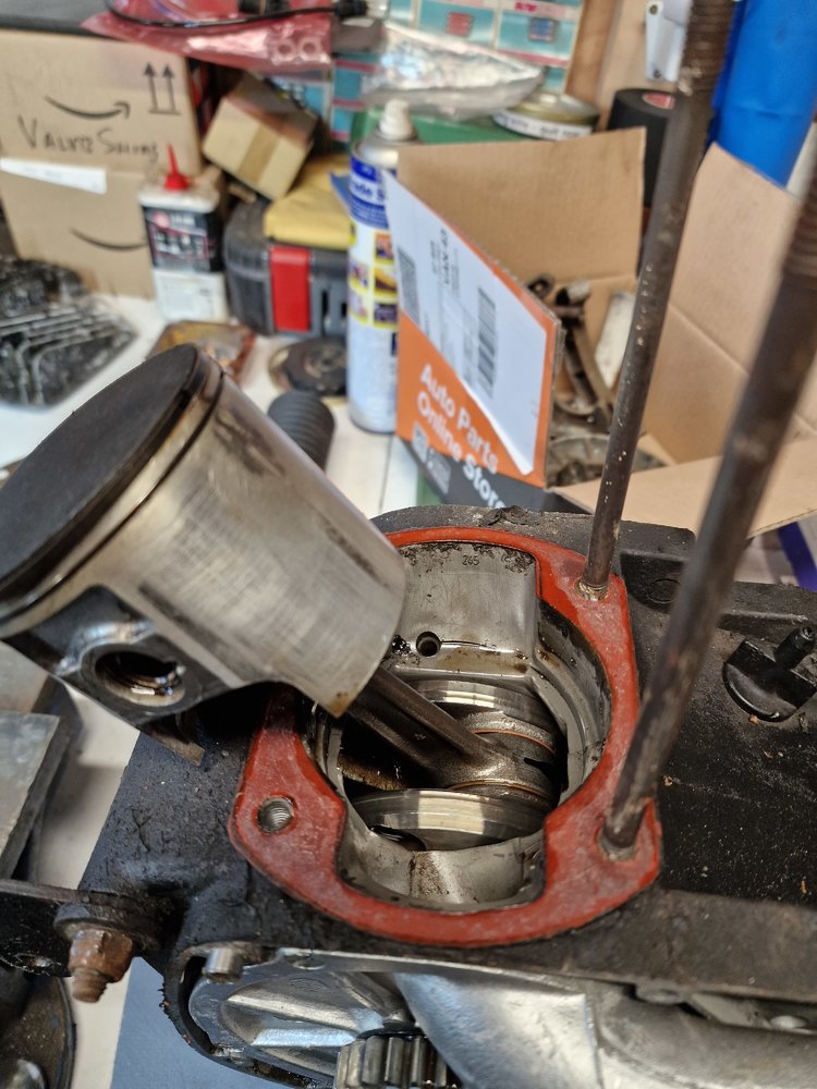

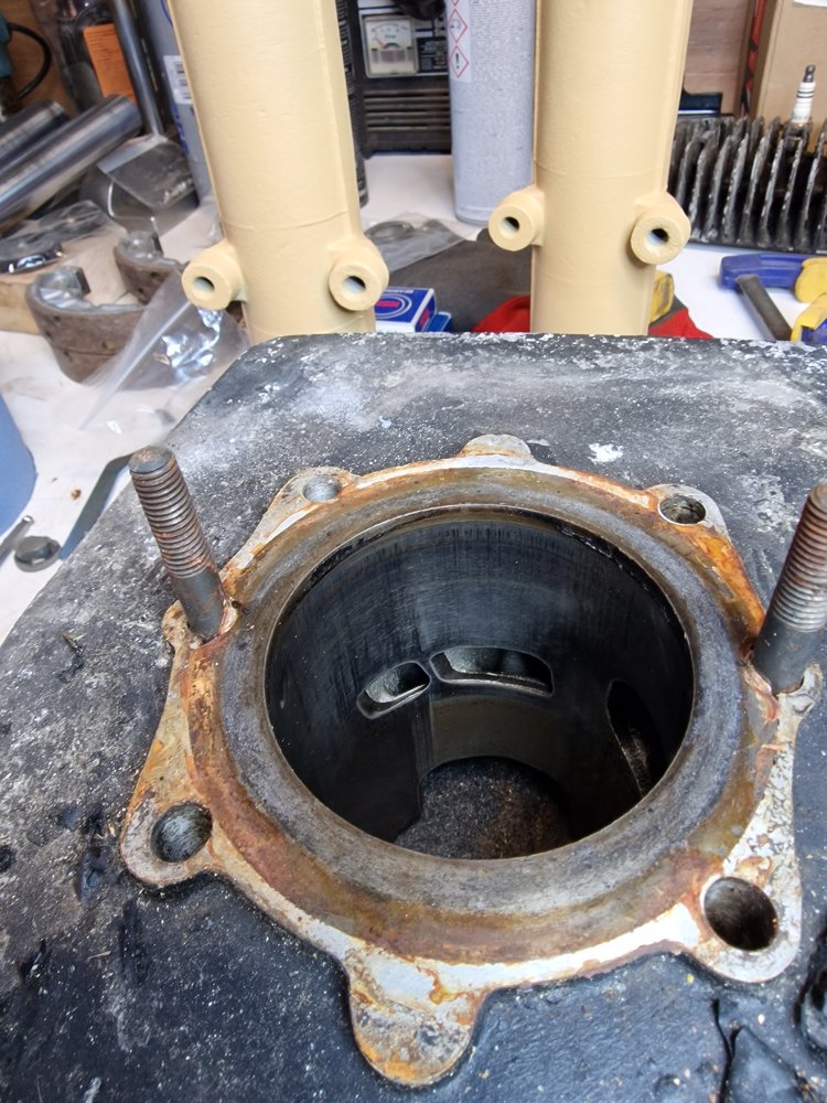

Sorry to appear a trifle picky but that top end isn't what I would call 'decently serviceable' but we all have our own levels of usability. To me I'm afraid I couldn't rebuild an engine in anything other than in an as new condition as possible . @Cato
But with yellow number boards
As you say each to their own.Each to their own, but wear well within tolerance, and no damage = serviceable to me.![]()

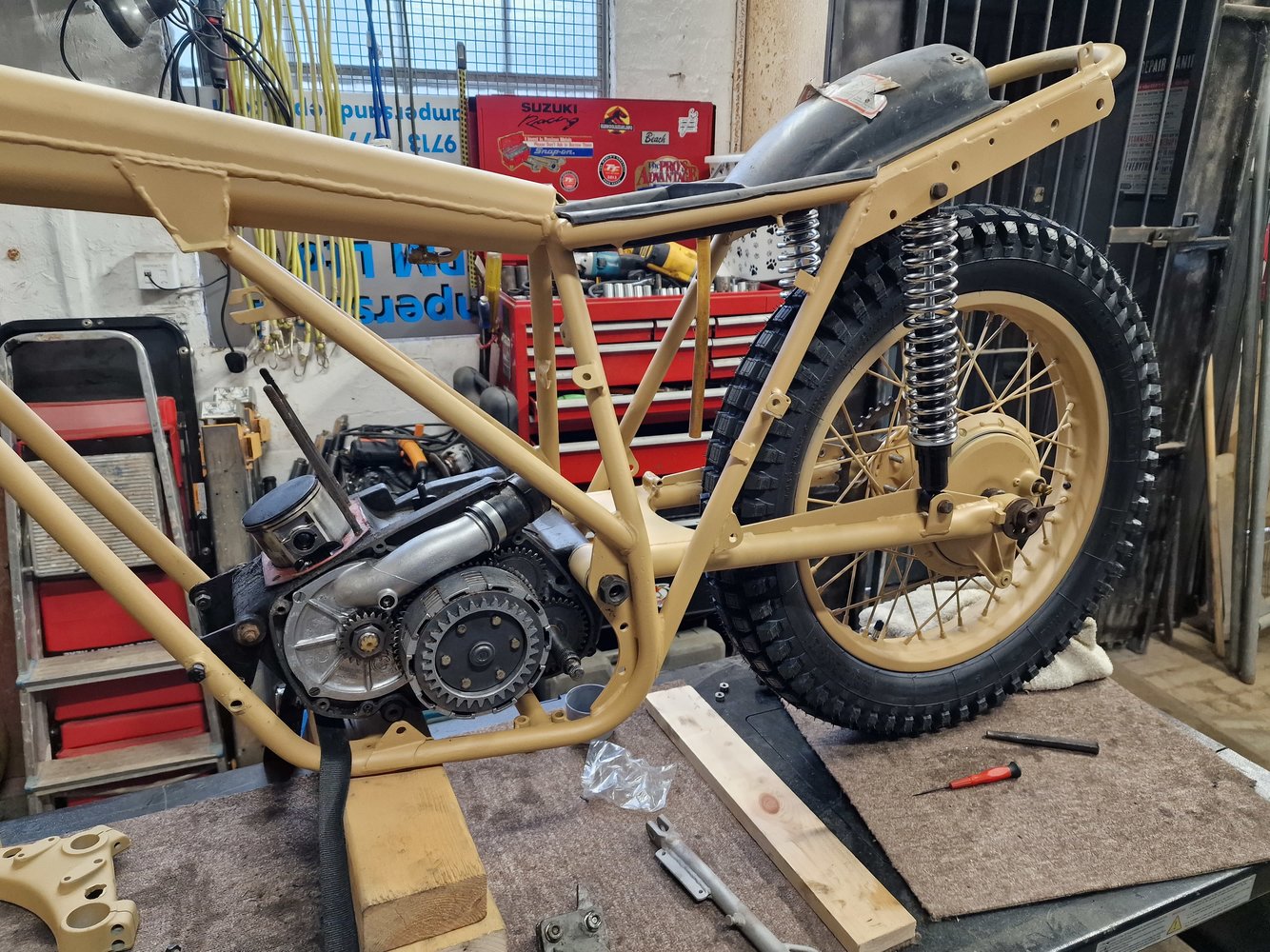

The two-ring piston was the one I was issued with, to replace the three-ring OEM one.Real progress being made now. I took the top end off of the engine to see what's what there, and it all looks decently serviceable. So the side cases, barrel and head can go off for blasting and get painted when they come back. That meant I can fit the bottom end back into the frame, so the swing arm pivot can go in.
They're an odd design, stepped compression ring and a slightly reduced crown diameter to clear the step.The two-ring piston was the one I was issued with, to replace the three-ring OEM one.
Probably worth mentioning, but I didn't mean that I was just going to close it back up as is. I was referring to being happy that it didn't need an over size piston and boring to suit.As you say each to their own.
Called a Dykes Piston Ring.They're an odd design, stepped compression ring and a slightly reduced crown diameter to clear the step.
Not a name I'd heard of. I suppose 30 - 40 years ago was the peak of interest and development in two stroke stuff.Called a Dykes Piston Ring.
Were very popular when I used to rebuild TZ, YZ & IT engines about 40 years ago.
No, no, it needs a ported big-bore kit, tuned expansion pipe and a bigger carbProbably worth mentioning, but I didn't mean that I was just going to close it back up as is. I was referring to being happy that it didn't need an over size piston and boring to suit.
Once the barrel and head have been stripped of paint the bore will get a light hone, new rings (if available) then the piston and combustion chamber cleaned. Then it'll go back together with fresh oil.
Part of the idea was they provide better ring to cylinder wall sealing as the combustion pressure pushes the ring tighter to the cylinder wall.Not a name I'd heard of. I suppose 30 - 40 years ago was the peak of interest and development in two stroke stuff.
