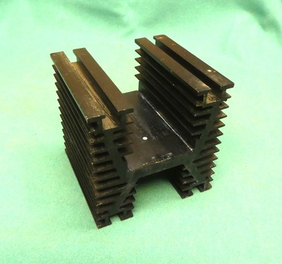

The cheapest solution would be 3 or 4 of these £3 blocks in parallel:
However, to share current equally they must all be at the same temperature, so would need to be mounted on one common heatsink.
