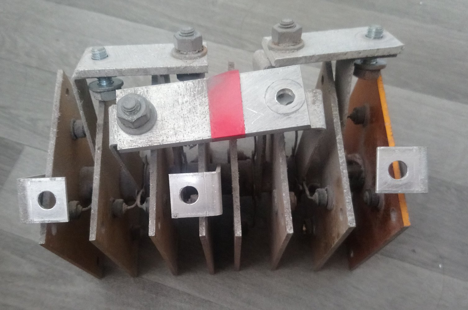

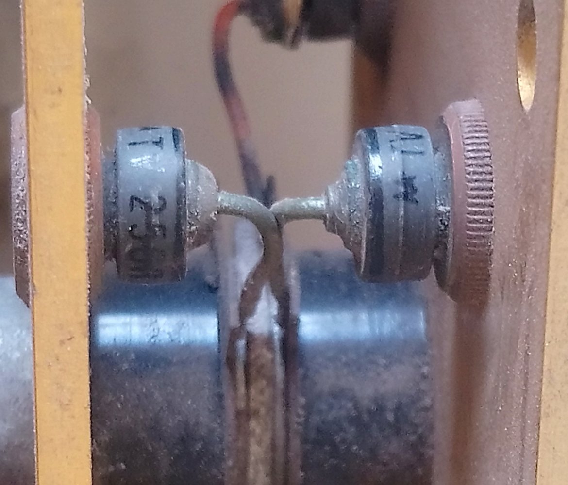

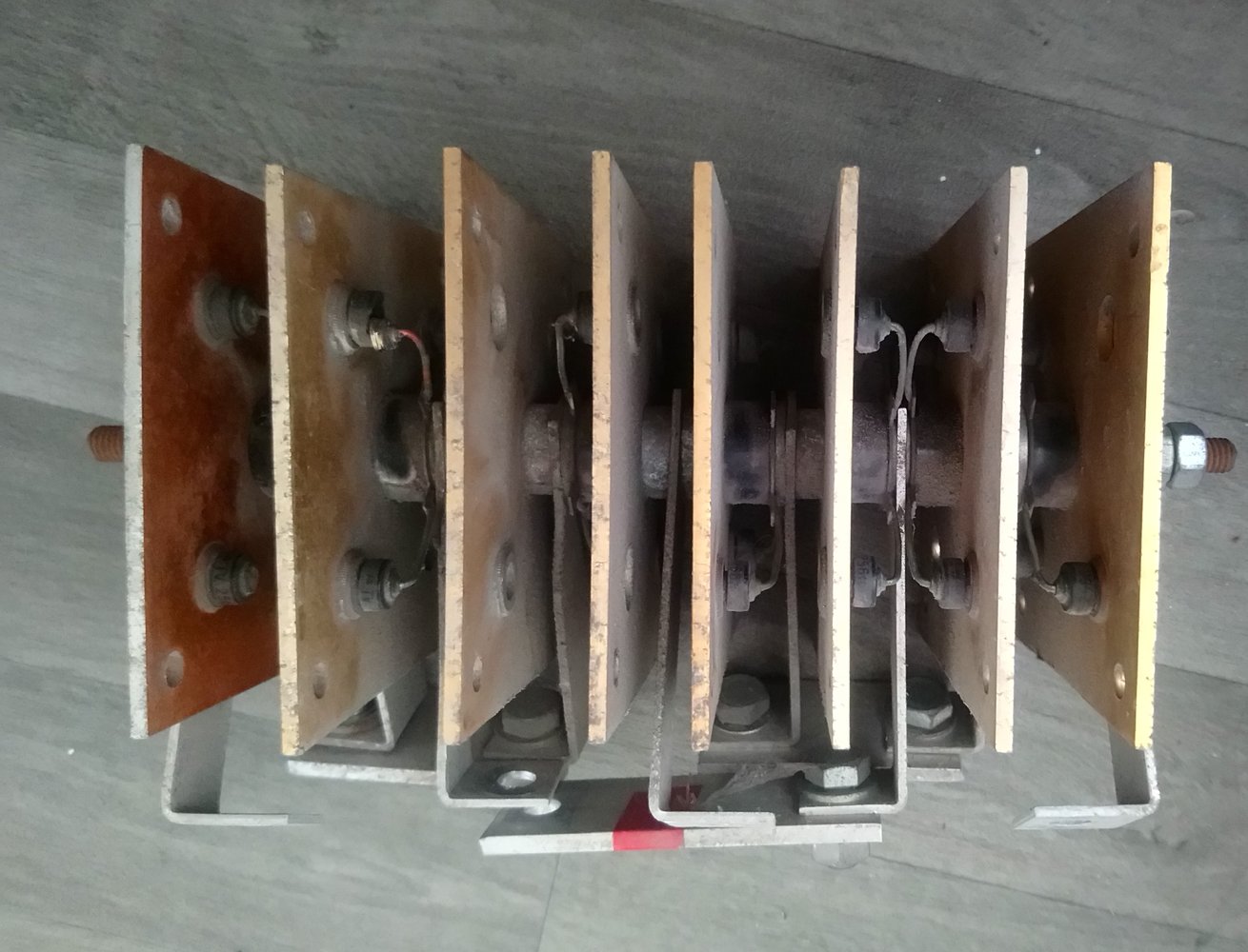

i know this is a old post, but i had to resond to the old crap thing lol, well its quite the opposite, old caps and diodes were bomb proof if they were made in the UK and USA, british standards have always been of higher rating when compared to CE mark, cheap imports go way back and quality control was sketchy from the import countries, and they were used in well known brands over here, so things did start going south quickly once the imports increased. As for rectifiers, heat dissipation is the reason for multiple diodes, too condensed the harder it is to control thermal runaway, tolerance in diodes is pretty close regardless, manufacture of the doped region is very accurate and consistent in silicon diodes, the issue is always cooling and constant flash voltage/current, modern machines fail much more than older types, they're build is inferior by far, caps are pure junk these days and tolerances are a joke in most well known brands too, one last mention in diodes, if you use lower current rated caps, expect fail rate to go up, any transients will wipe one or more very quickly, so double up on protection for surge and spikesI agree with the comments above about old electronics. Old= unreliable and probably unobtainable crap - look at old British bike electrics- terrible. A bridge rectifier is 4 Diodes in a square arrangement . if there are 24 then the components are doubled up ( probably because the current rating wasn't available in one component back then), or there is more than one rectifier. Modern components are really cheap and very reliable as in the above posts. Some bits of ally ( maybe the originals) as heat sinks and some bolt terminal diodes and you are away. Sorted. Dont mix old and new - the old will likely fail fairly rapidly.
