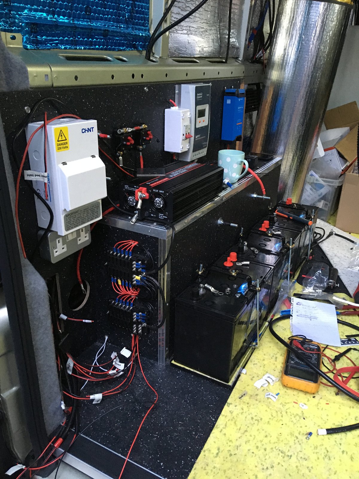

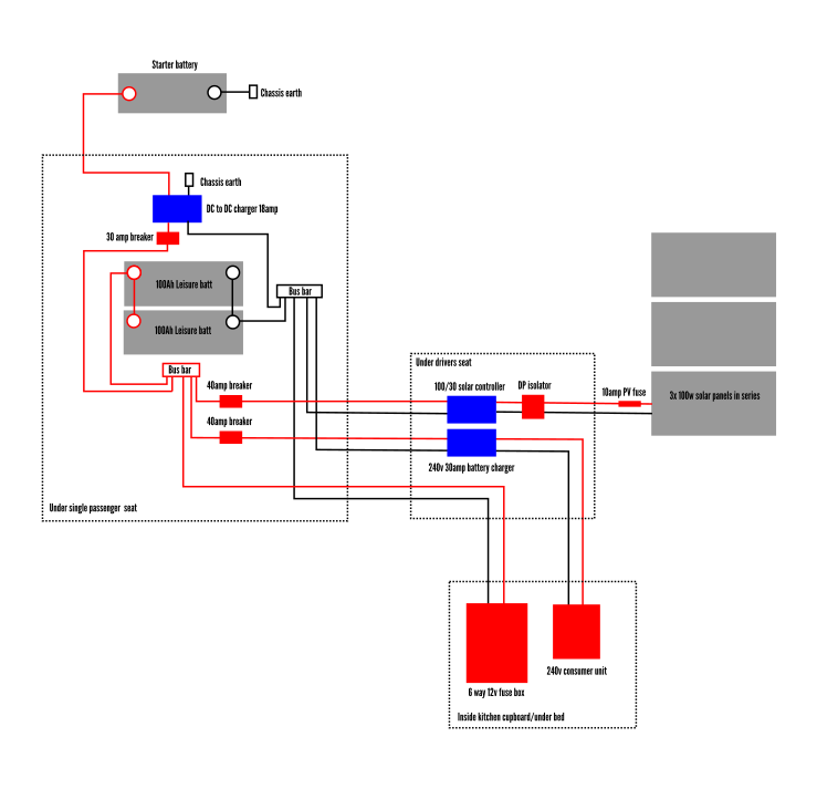

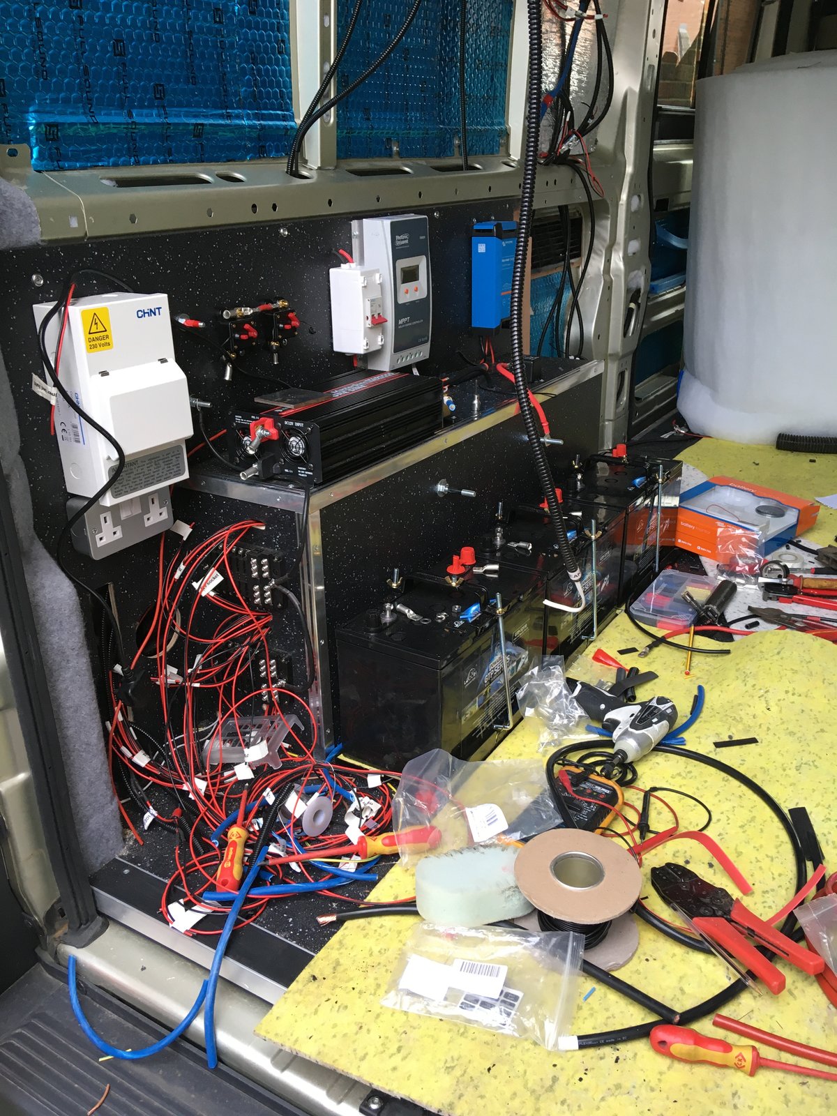

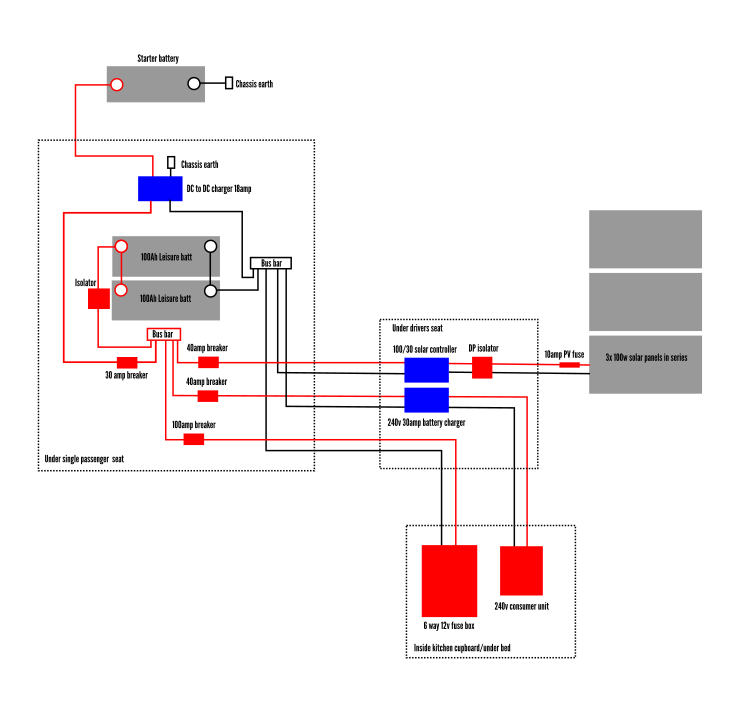

I'm building a Sprinter motorhome and have reached the wiring stage. Does anyone have any experience of wiring up an Mppt solar controller, Mains charger and dc-dc converter to a van? I've done a schematic of what I think it should look like. I'll add in the appliances/lights etc later but I need to get the charging bit right first I think. I probably need another breaker between the batteries and the positive bus bar?
All the blue boxes are Victron units in the hope they'll all play together well.
I've noticed that in most van conversions I've seen on YTube people don't earth through the chassis and instead run wires back to a bus bar or fuse box. Could be something to do with the vans own electrical system not liking it maybe?
