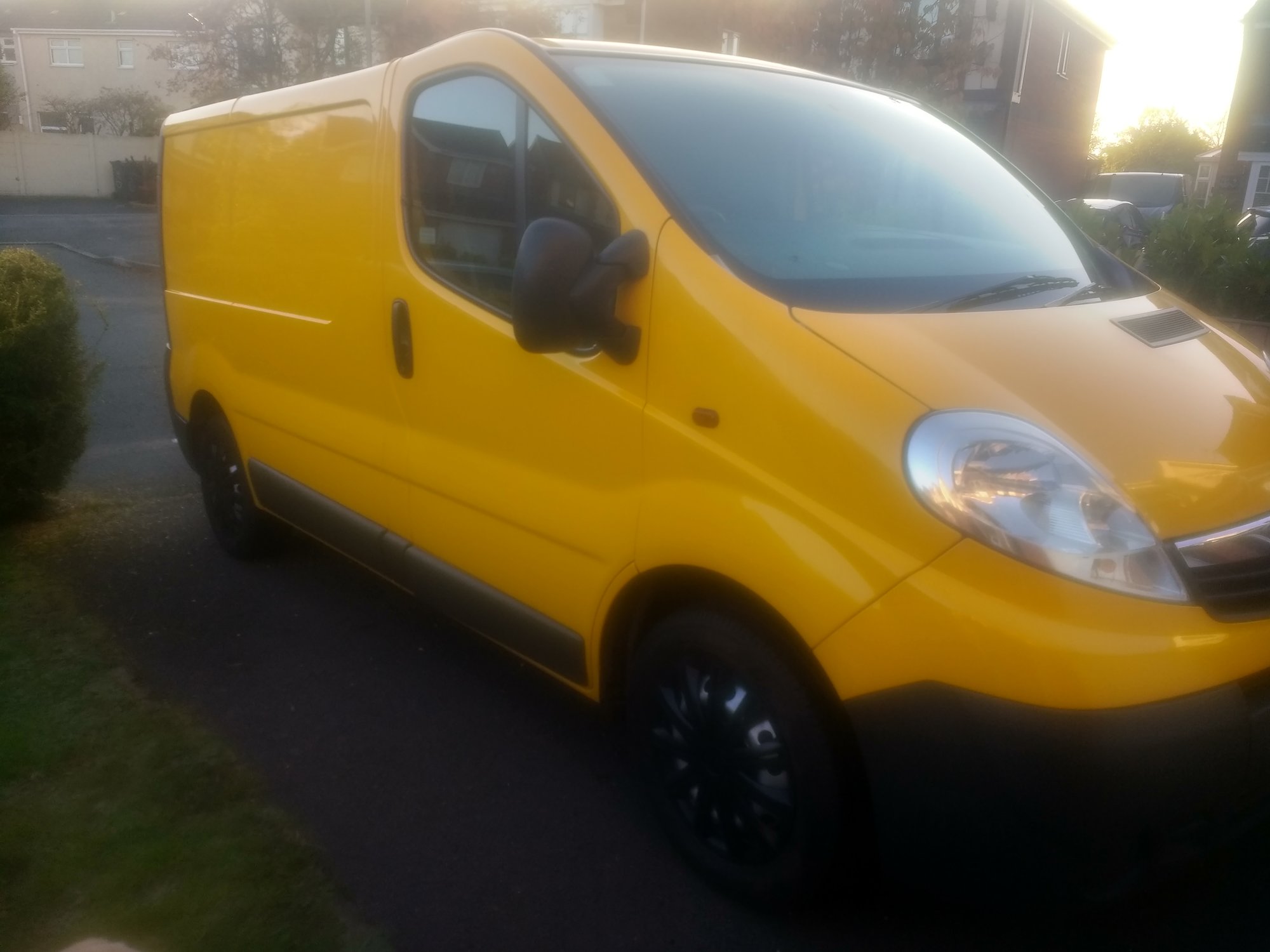

Beautiful day here, so spent a good few hours clearing out the van in advance of actual conversion work
Body work is in really good condition for its age, seen much worse on vans half this age

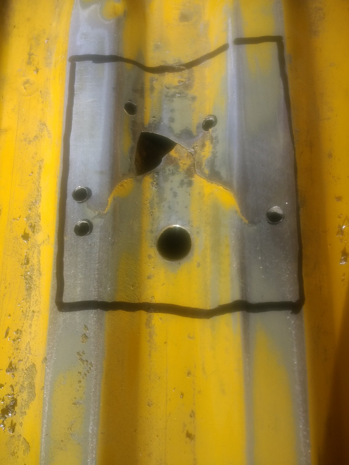

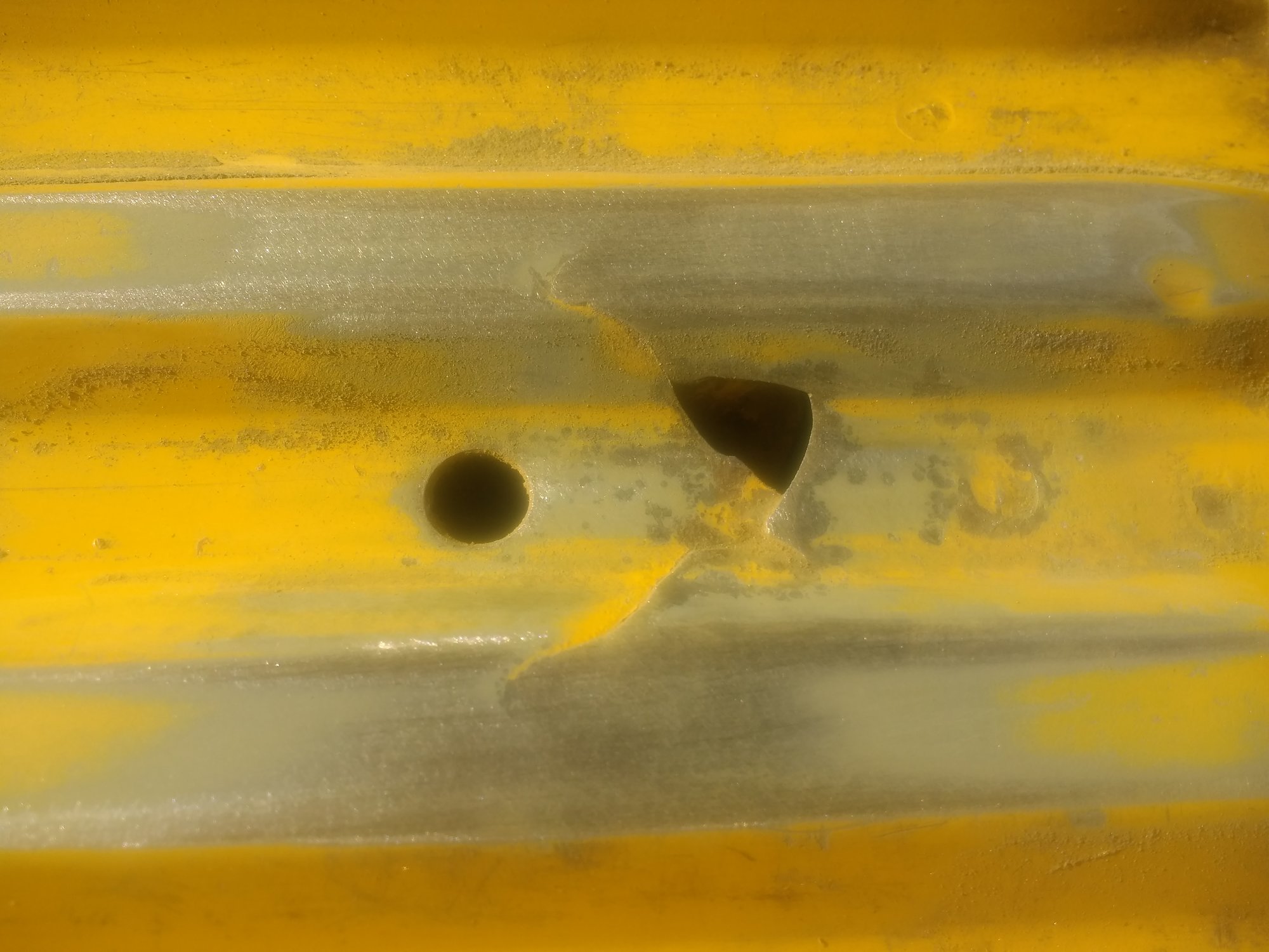

Only welding needed is a tear in van floor, almost looks like metal was punctured
Really lucky where it is too, nothing awkward or flammable in surrounding area underneath and patch needed only about 100mmx75mm. Drilled some holes to stop tears spreading before i get it done.

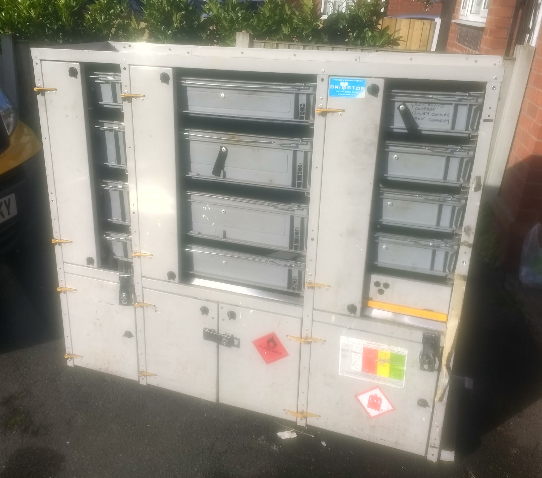

Think been lucky with racking too, was going to flog it but reckon worth more to keep. Going to put toolbox on top and fit new locks, handy storage in garage. Was a pig to get out by myself tho, weighs a ton
