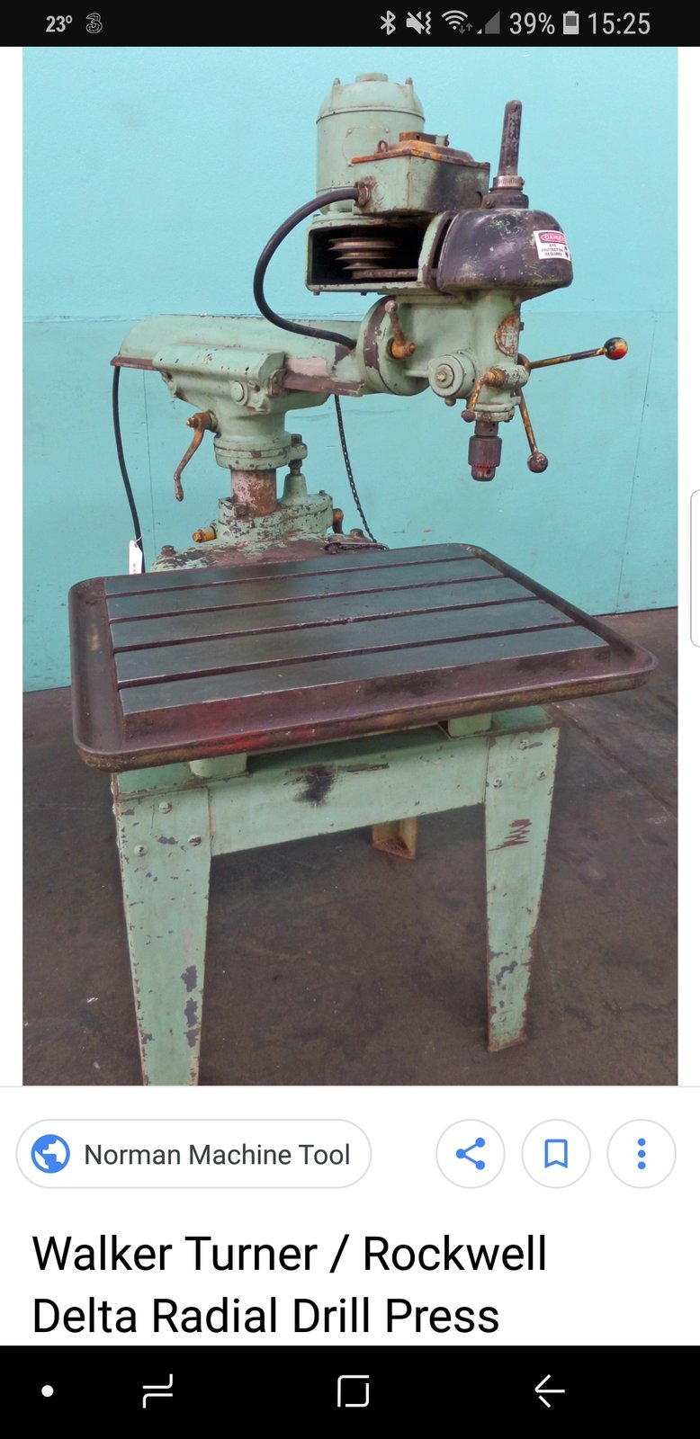

But on my quest for hunting for stuff I did spot this walker turner radial drill....and I want oneView attachment 148737
