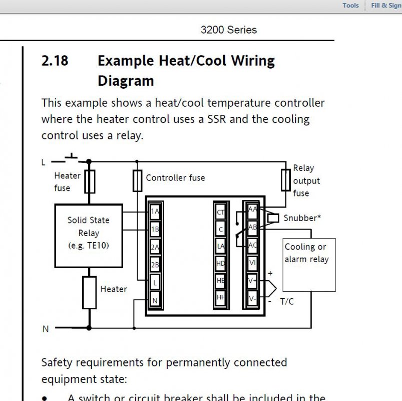

U ukracer Forum Supporter Messages 17,965 Mar 12, 2015 #21 julianf said: The SSR is only single pole. So it only switches the live, not the neutral as well. Click to expand... Ah one of my guesses was correct at least...
