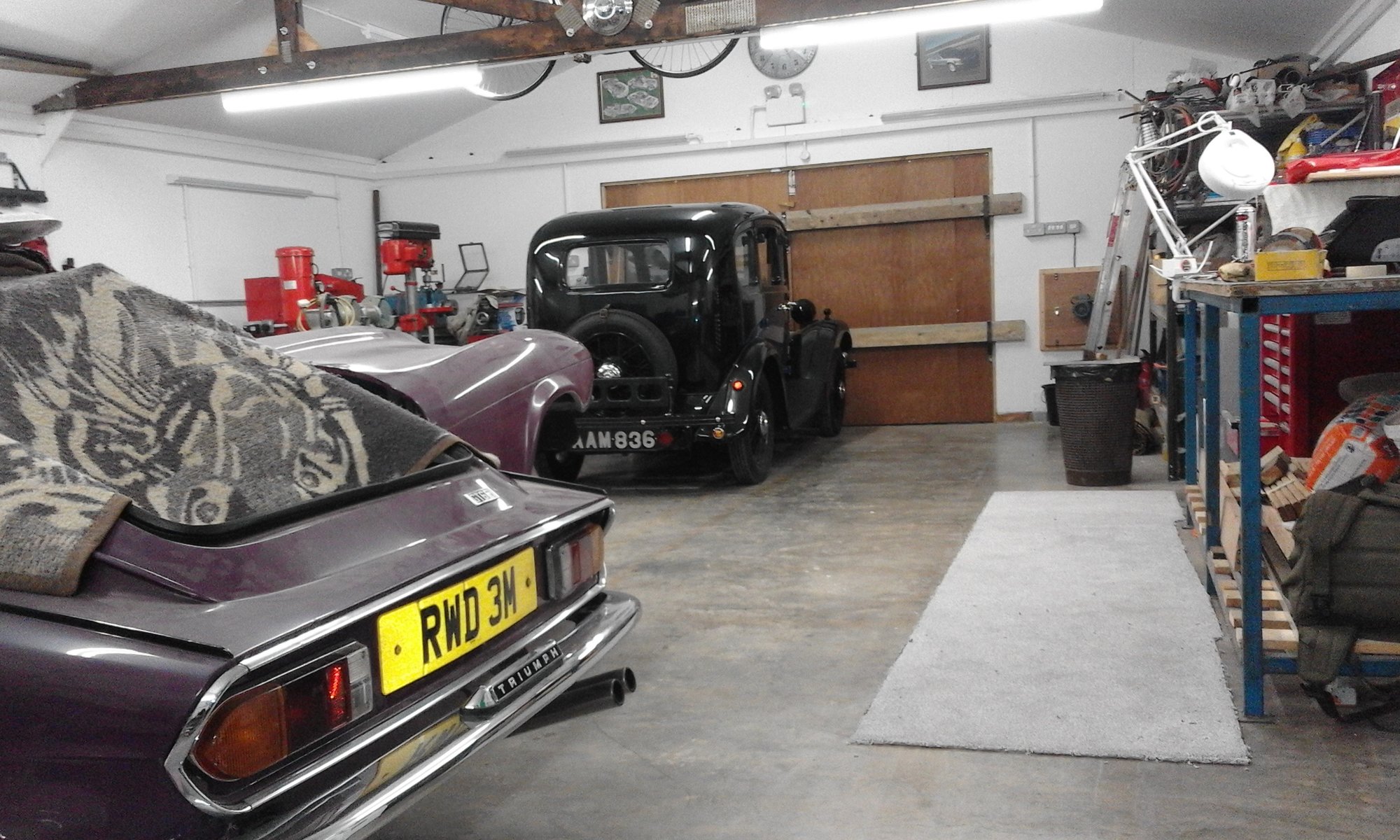

Our garage is at the bottom of the garden, there is currently a 20A feed to it made up of twin and earth in the house then connected to SWA for the outside run.
We're thinking of getting wooden floors laid in the not too distant future, so I'm thinking about getting the feed upgraded to the garage. I don't need more than 20A at present, however I am thinking in terms of future proofing for having an electric car charger there. It's likely that one of the cars will be fully electric when they come up for replacement.
Question is what size cable to go for? Should I max it out so that what is installed is plenty for say 63A all the way through. or just deal with the indoor section and tackle the outdoor later?
