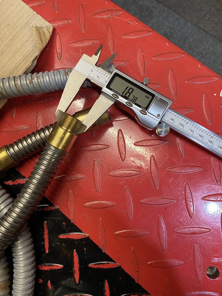

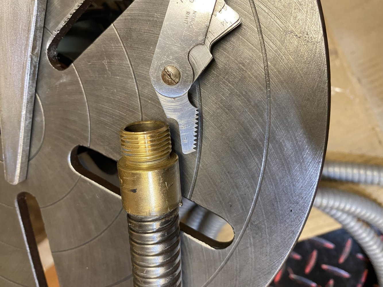

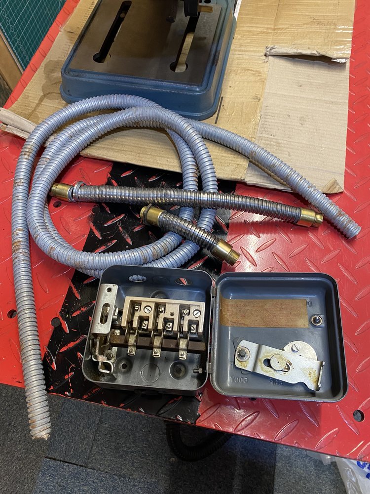

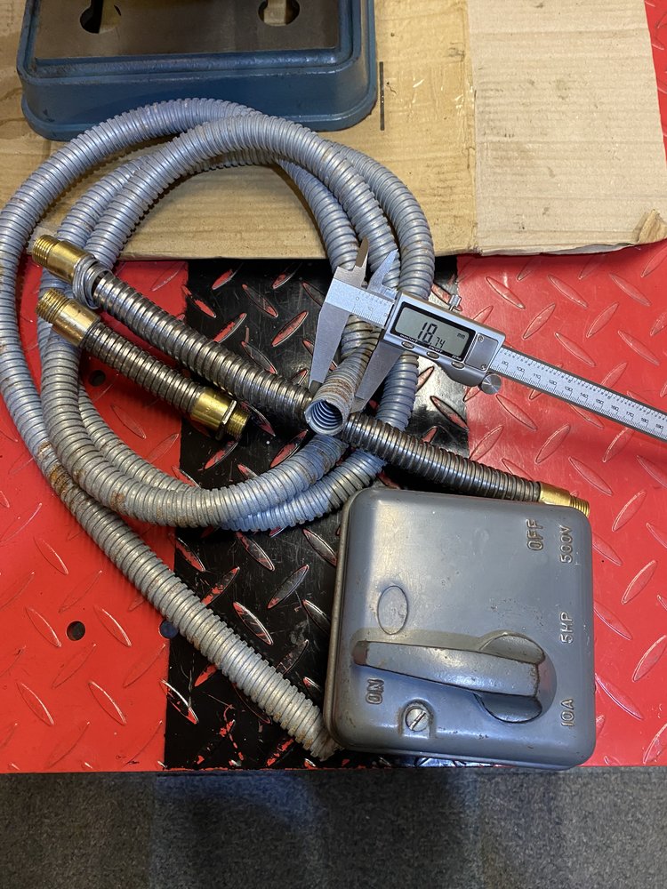

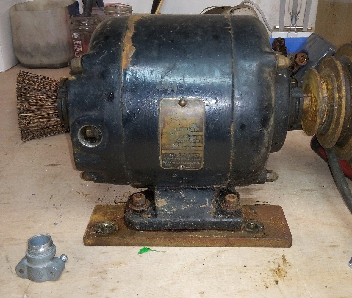

Hi All,
As part of the clean up and recommissioning of the Deenbigh Pillar drill I acquired a few weeks ago, I'd like to replace the connector on the end of the short length of conduit the runs between a MEM switch box (that appears to be OEM, but may not be) and the motor (a British Thompson-Houston). The gland should be screwed into the motor but the threads on it are quite badly damaged and will no longer screw in.
Before I make matters worse I'd like to source a replacement. I've measured the threaded part and it's major diameter is around 19mm. It looks about 1.5mm thread pitch but of course this is a very old motor and the hole in t6he casing looks pretty original so surely not a metric thread right? Unfortunately my largest metric tap is M18 x 1.5 so I can't check it that way.
Can anyone shed any light on what this gland and its thread might be?
Thanks,
Richard.
