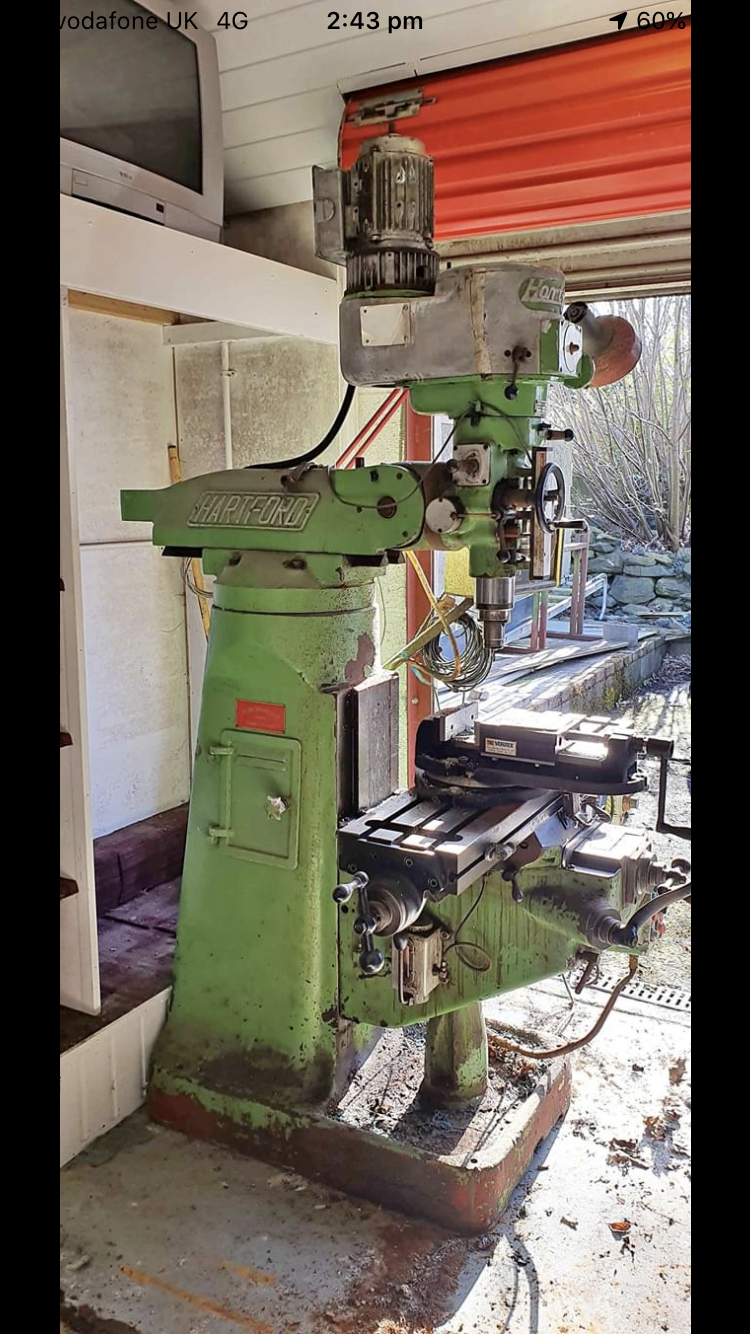

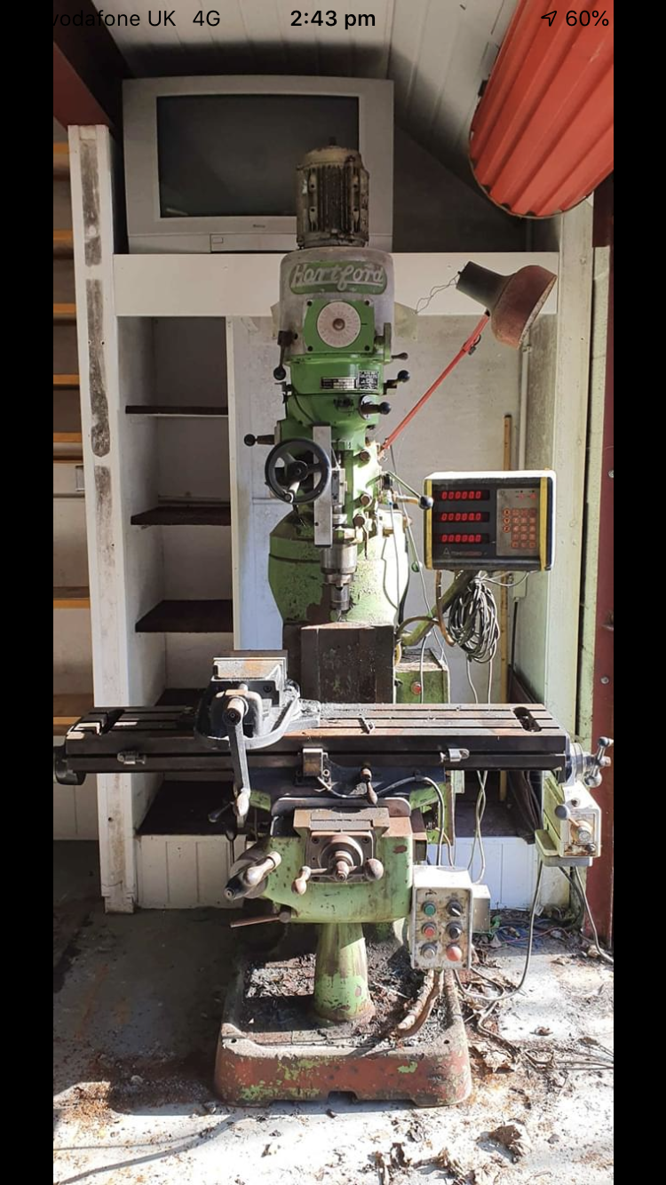

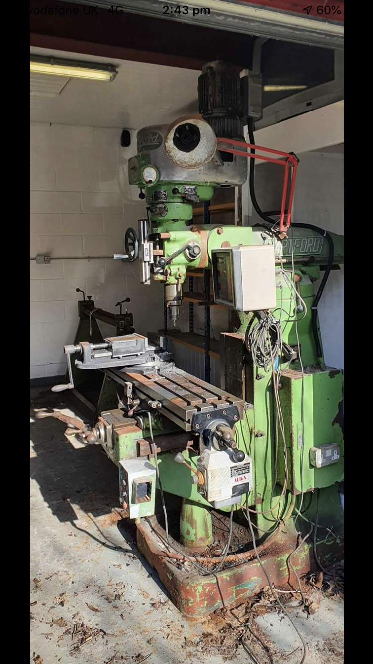

View attachment 223544 View attachment 223543 View attachment 223542 This mill has come up for sale near me how much do you think it’s worth? it’s all working and comes with the DRO and vice and a couple of cutters. Also how much use do people find they get out of a mill. I’m just wondering whether it’s worth the investment. I know a few things I’d find it useful for but has anyone got any opinions to sway me to buy it or to not, ( this will be my first big machine I.e haven’t had a mill or lathe before)

Well that's not a bridgeport. Hartford are clones. It looks like it has been exposed to the elements from the surface rust and I would say rough IMO, although it may clean up.
If you don't have any experience buying one I would probably avoid it unless you can take somebody with you who has more experience, or you pick it up for dirt cheap. If there is a for-sale price listed, post it up here and you will get replies telling you if it is worth it. The trouble with prices and machine tools is that it depends a lot on where you are, how available they are and also how easy it is to get it home (i.e. can they load it, can you haul it or unload it?)
It’s 240 but got 3 phaseIs it 3 phase? Do you have 3 phase at home or workshop?
Worth checking.
I think if I had the money, it was local, I could transport it and had the space to put it (non of which are true) and it ran or at the very least I could give it a very basic look over, I would have a punt for £600.Am I the only one thinking you're all being a bit harsh?
It does depend how much of a state it's in, of course, but it's got a moving knee, £200 worth of DRO, £100 vice.
Assuming all the moving bits actually do move that looks like a lot of mill for £650, or even better for the £450 or £500 you might offer the seller.
But I do agree with MetalMonkey that you would need someone with you who knew how to check it out, as it could also be an 850KG anchor...

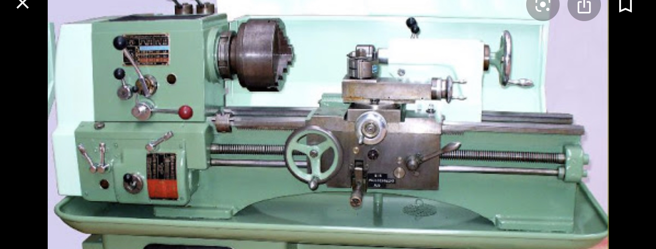

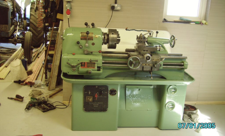

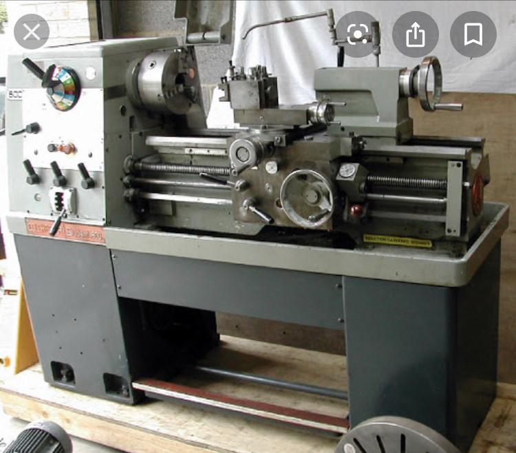

I’ve been told to look at Colchester students and similar could you advise on whether that’s a correct sort of thing to be looking at.
Thanks for that quite helpful, just to clarify from these photos which photo is which lathe ?I am not a huge fan of Colchesters, they are similar to Bridgeports in that they are OK but get a higher reputation because of the name.
Having said that they do the job and are decent enough but I would say look at the round head students or even a square head rather than the newer 600 group ones. Just to clarify, the square heads are basically just roundheads but with a flat top and not the newer style which a lot of people call squareheads.
