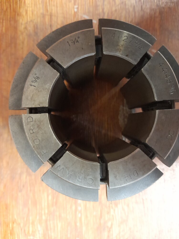

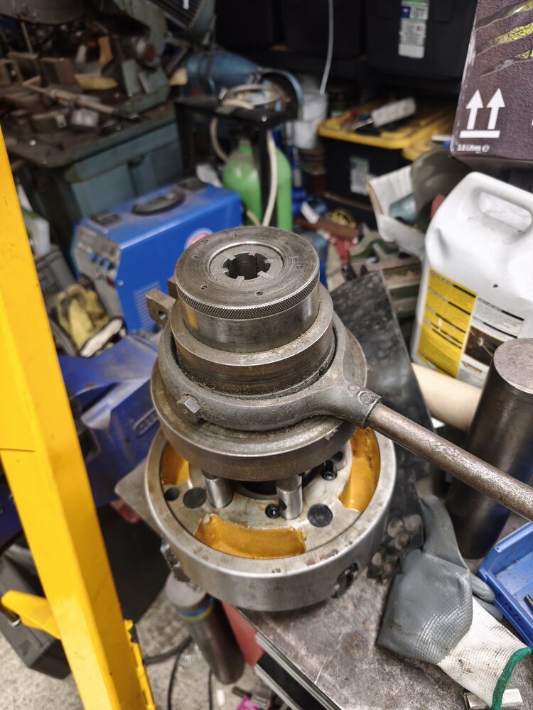

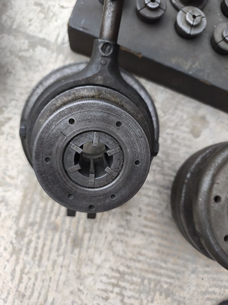

Show photoI have one of these collet chucks on my M300 with the handle straight up....it's OK not as ergonomic but it keeps it out of the way
Thanks.Maybe make a spacer of some kind so you always install the bed clamp the same distance off the headstock. Or do a test to see how much tolerance you have on that distance.
A shoulder bolt for the pivot could be nice. Saying that, I wonder if there is a quick release pin that would be suitable - look up 'ball detent pin'.
Mine had a bush so when the pinch bolt is tightened it grips the bush rather than the end of the pivot arm.A shoulder bolt for the pivot could be nice.
That's a good idea. The clamp does need to be in roughly the right place.Maybe make a spacer of some kind so you always install the bed clamp the same distance off the headstock.

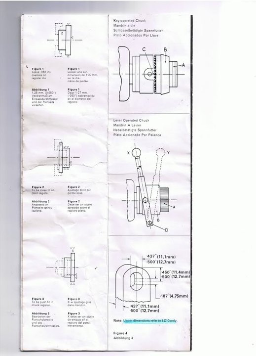

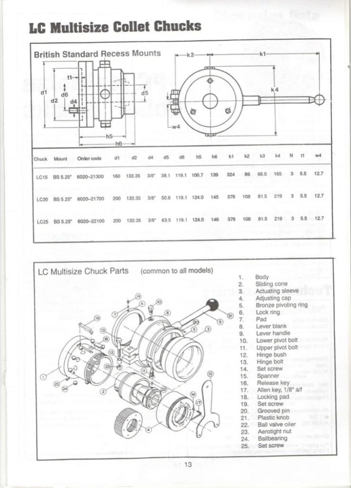

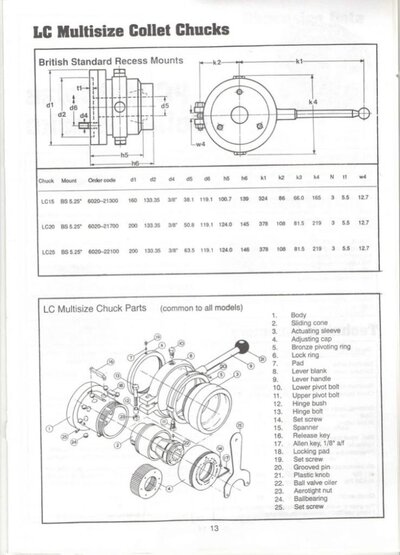

View attachment 520712 Eas
Part 12 in the diagram. Easy enough to make if yours is missing.
