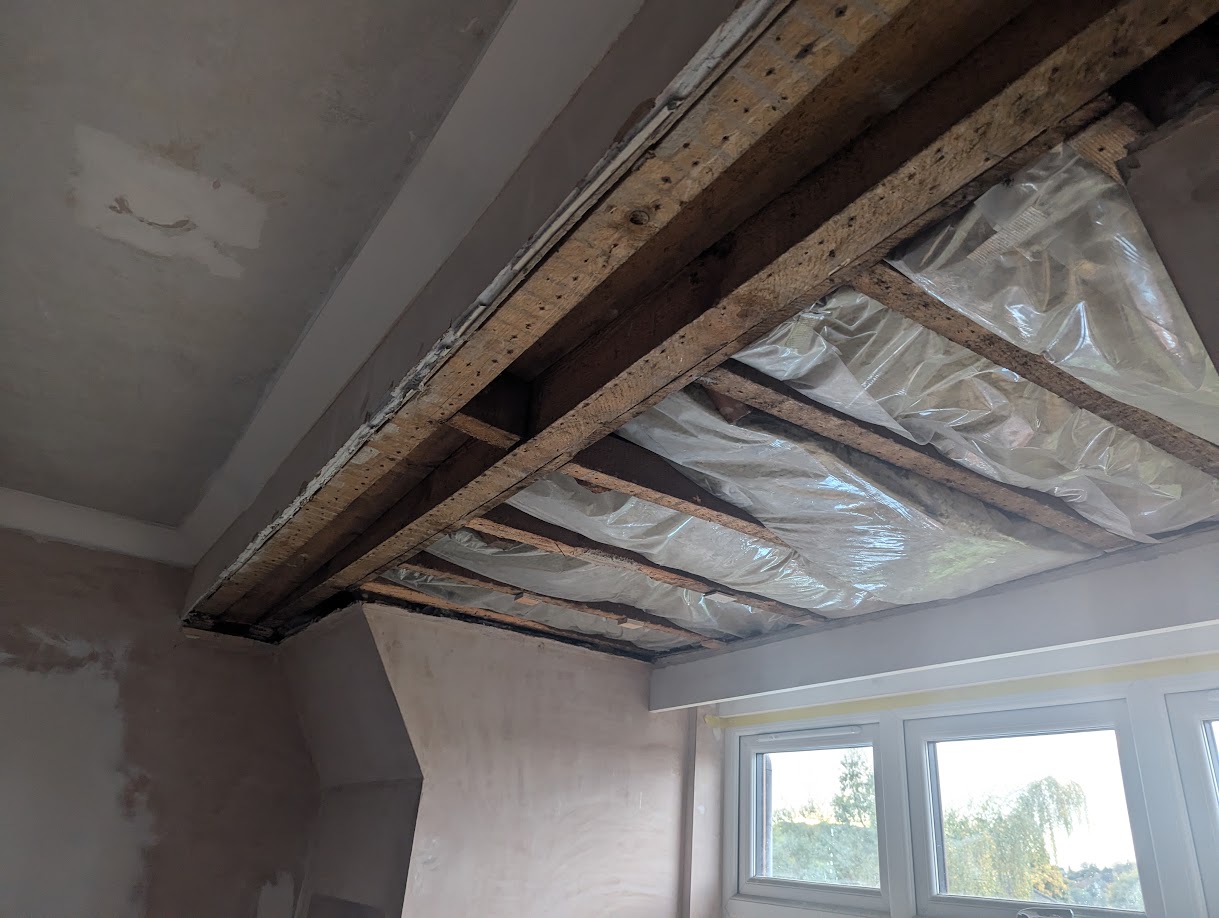

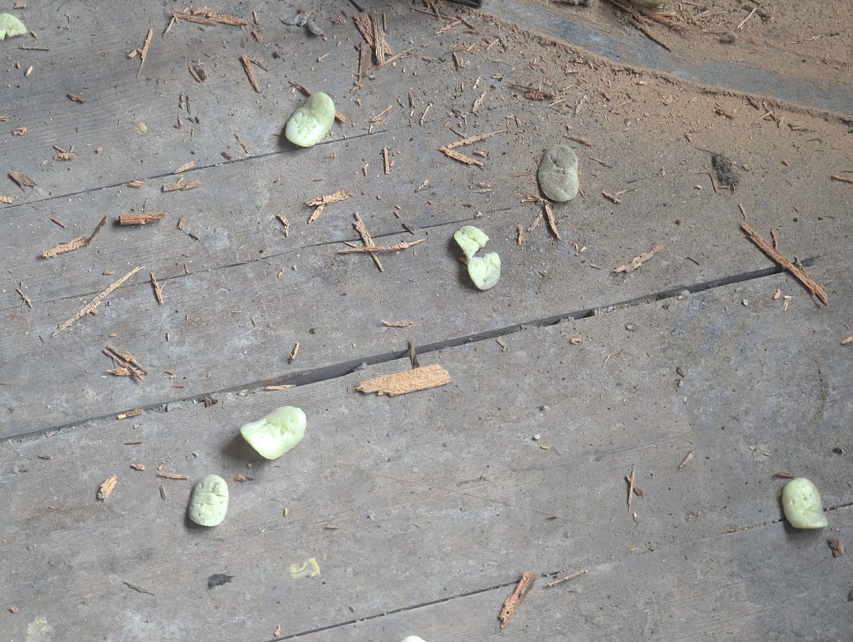

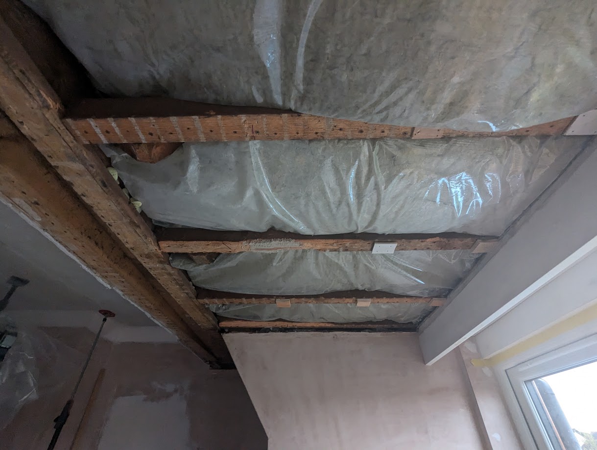

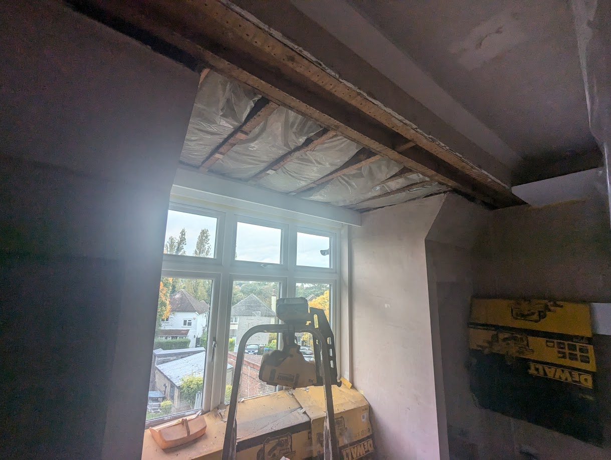

I've smashed it all out today. Horrible. Black dust is the worst! And some sort of foam insulation chips that were between the joists. I'll clean up tomorrow and get some pics. I'm glad I partitioned the room with a sheet dangling from the ceiling.

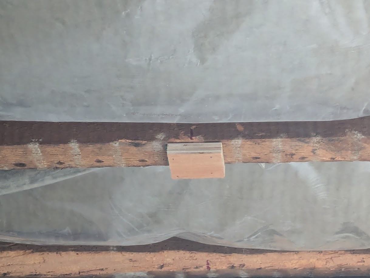

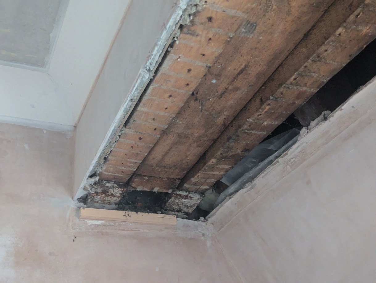

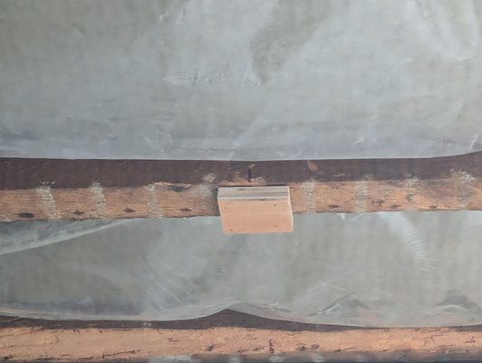

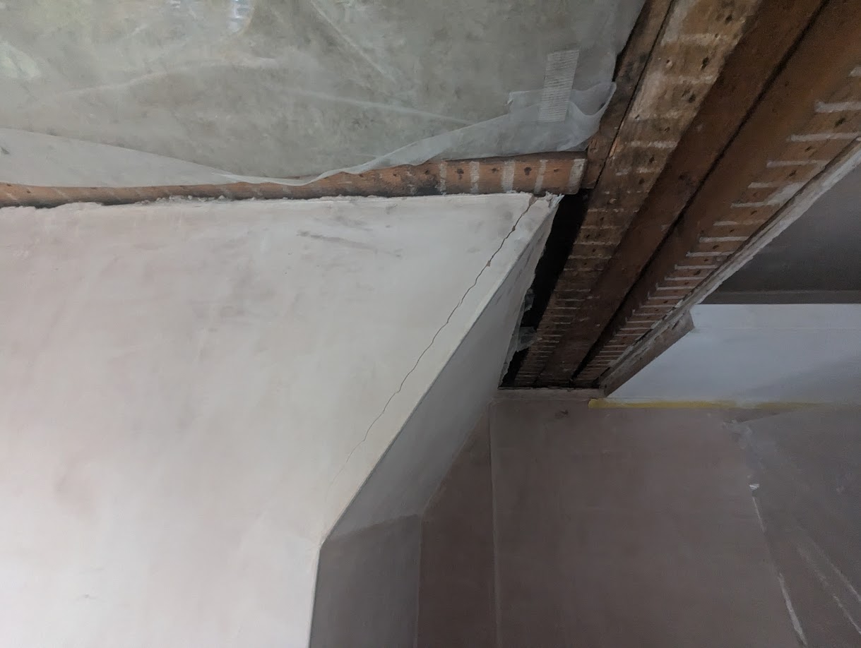

Some expanding foam in the gap then tack it in place, that stuff will stick anything!I got a bit carried away with the crow bar when removing the laths and I managed to crack the plaster on the side. The plasterboard has separated and is flapping about. I was thinking of shoving a load of glue in the joint and then fillering over it?
I like the PU foam gun adhesive...with the gun it's nice to use and similar to foam it basically sticks anything (including fingers!).Some expanding foam in the gap then tack it in place, that stuff will stick anything!

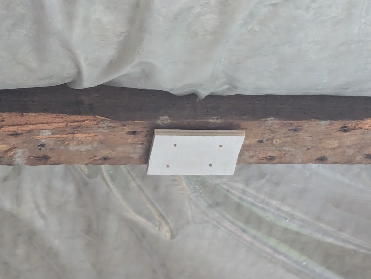

Id use insulated plaster board on that, so you dont get cold spots where the board is fixed to the timbers on the timbers.
Id suggest strips of packing rather than little squares. Plasterboard needs fixing quite regularly.
Good shout.Might be simpler to just buy some timber and screw it to the sides of the joists and then board on that...less faffing about. I think that's what I did in a few places with ours.
+1...very useful stuff...comes in a range of thicknesses. Also useful under internal window sills too.insulation tile backing board
