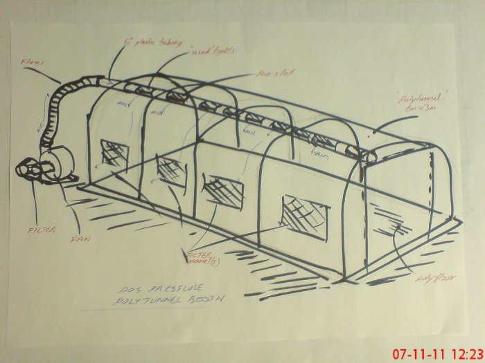

Ok a little late but after some discusions with the consultant off ebay this is what ive come up with, just basic drawings so far but your get the idea.
My shed measures 8x15ft which will sectioned in 2 halfs as shown, area A will be heated in some way which will provide warm filtered air from the top of the wall. The idea behind this was to give a diagonal airflow across the room to the 2 stage filtered extraction panel which will sit 0.5M from the floor as i will be painting on stands which are roughly 1.0M high.
The 2 stage filtered panel needs to sit roughly 400mm from the wall to allow air to congregate before passing through the fan, which can draw from anywhere behind the filters. It will house two stages of filter, comprising of a 100mm green/white Painstop primary, backed up by a 290gsm blue/white secondary.
Exraction fan recomended is a 500mm diameter, 1.1kW bifurcated axial flow fan. Price is £600.00 + V.A.T. for 3 phase or £650.00 + V.A.T. for single phase. Provided the fan is mounted outside the spray room there is no need for a flameproof unit.
Opinions????
