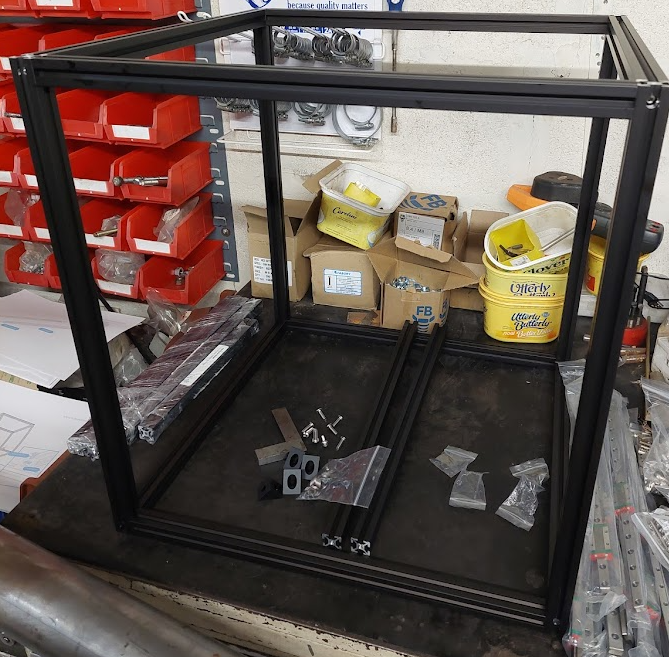

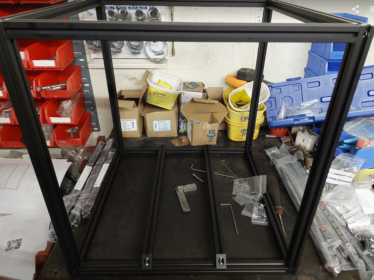

I finally started assembling the frame last night -

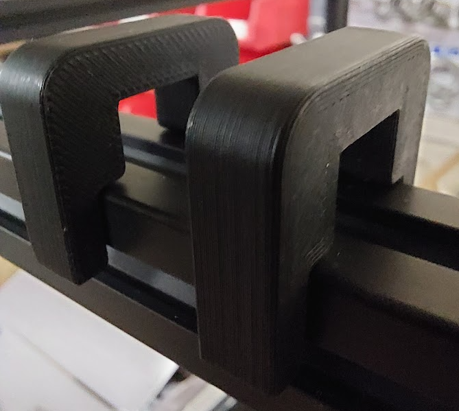

And got as far as adding the bed support bars, and checking it's square tonight-

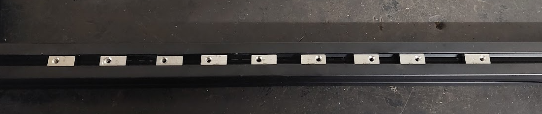

I opted for a ready machined Misumi extrusion kit.
I was going to go for silver, but silver was out of stock, so I paid the extra for black, rather than wait weeks for silver.
Next step is to start adding the Z-axis linear rails, and Z-axis drive units, which I might get started on tomorrow night.
