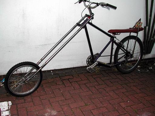

The plan is to build a recumbent first, then the more complex trike, an atomic zombie design.
I only have a 240v 13A supply. (I could at some expense, get a 20A connection)
The steel to be welded is 1.5" square section approx 1/16" (1.5mm) thick.
But for some bits I need to weld small 3/16" (4.5mm) parts. I can access both sides of these.
I am stuck between getting an MMA inverter which can do down to 20 amps or so, and 1.5 or 2mm 6013 rods.
Or getting a Mig Welder.
I've done lots or reading, and gotten lots of conflicting opinions.
1st, the guy who designs the bikes, suggests mma as described above. He has LOTS of details and videos.
Many people seem to think 1.5mm is too thin for Arc/MMA.
However I gather for MIG, off a 13A supply welding 4.5mm is out of the questions, as I will be topping out at 130amps.
I can get a clarke AT130 delivered for under €210.
To get a Mig Setup with a regulator eg clarke en 130 it looks like I'm into twice that.
The second hand market is thin in Dublin, and most stuff on ebay is pickup only (not surprising)
So, for anyone who has welded 1.5mm box section. your thoughts are welcome.
As a background, I just finished building a wooden sail boat, so I'm basically competent with my hands, but I have only had one 15 minute welding lesson with MMA, and 3.2 mm rods.
Thanks in advance,
Dave
