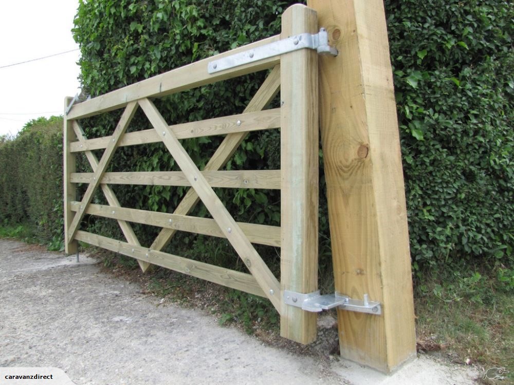

these can be extended
fieldgate will rise approximately 75mm for every 1 metre
https://www.johngeorge.co.uk/products/fieldgate-rising-hinge-galv-sband-5x14
but I still think one whole door is going to be too much and cause alot of wear on the hinge pin
if you want a look how its all done and easy enough to make up
https://bendreybros.co.uk/index.php/product/self-closing-f-g-set/
you actually dont need to buy a hinge its adjust by other things will allow the door to hinge itself
your hinges would be a weak point by just using the normal gate hinges and this below should do what you want
https://www.eversholt.org.uk/blog/?p=58
