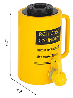

And can hydraulic spring return jacks be used upside down?
Providing the spring is in good condition, there shouldn't be a problem hanging it upside down, unless you decide to hang adaptors or tooling on the ram.
A spring return ram has only one entry or exit.Depends where the oil pick up is.
Ok I was thinking bottle jack.A spring return ram has only one entry or exit.
I presume fizzy was asking about a portapower style ram with a seperate pump.

This kind of thing?If i was starting from scratch then it would be a foot operated electric/hydraulic double acting Ram...ime thinking of changing my 10T Sealey into the same as having 2 hands while pressing stuff is so much easier.
