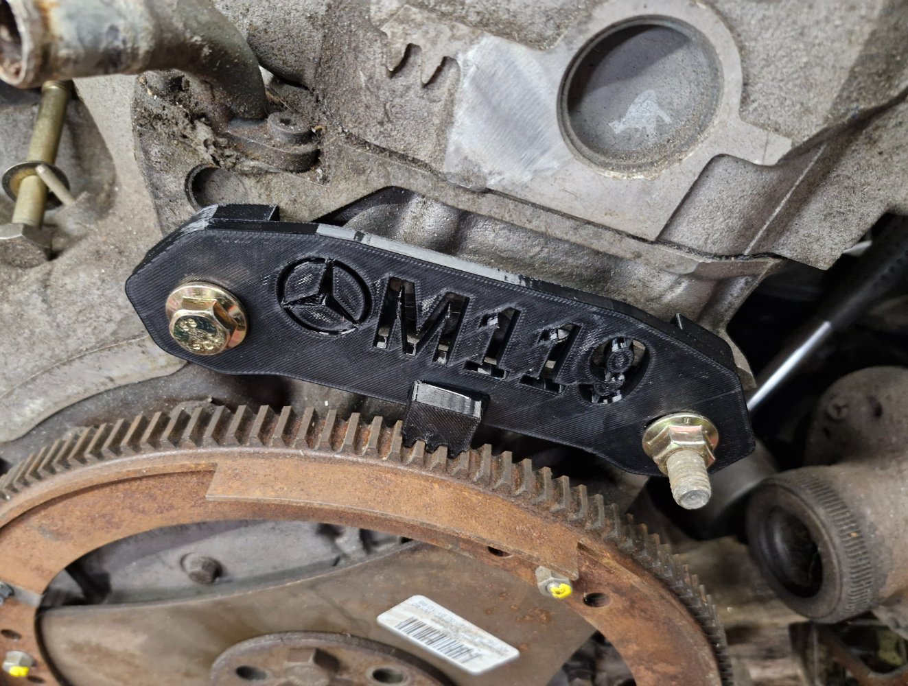

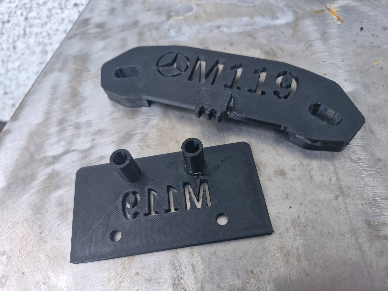

Lots of swear words but I got there and test printed a couple of crankshaft lock tools I designed and am currently fabricating from steel. (I had the steel plates alrwady drawn in cad before. Today was about converting them into 3D models for 3d printing) I see some minor tweaks ill make before final watercut steel plates so a really useful way to prototype small parts
