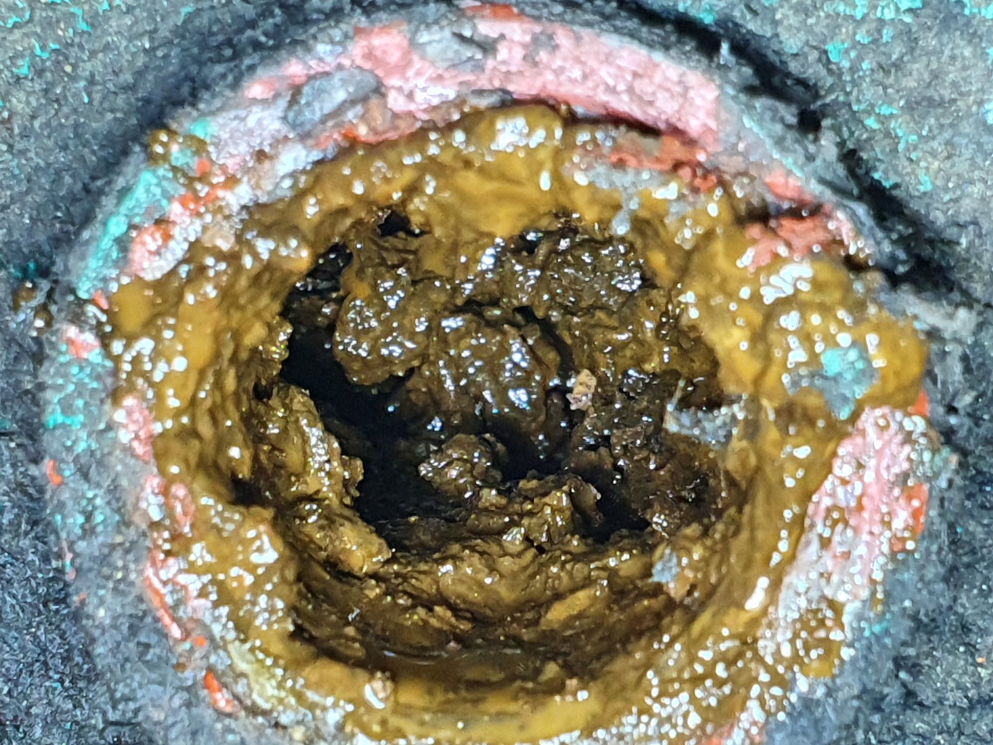

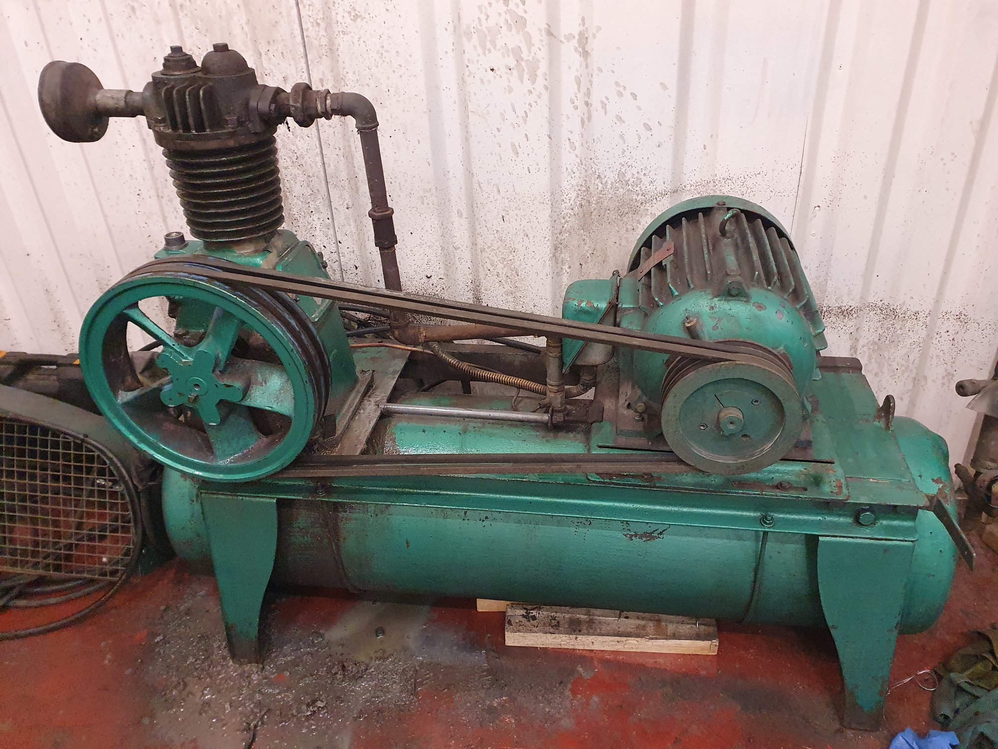

I have a 60's BroomWade compressor.. been using it quite a bit over the last few months. Works great, however, just gone to drain it and found 2" deep sludge in the bottom.

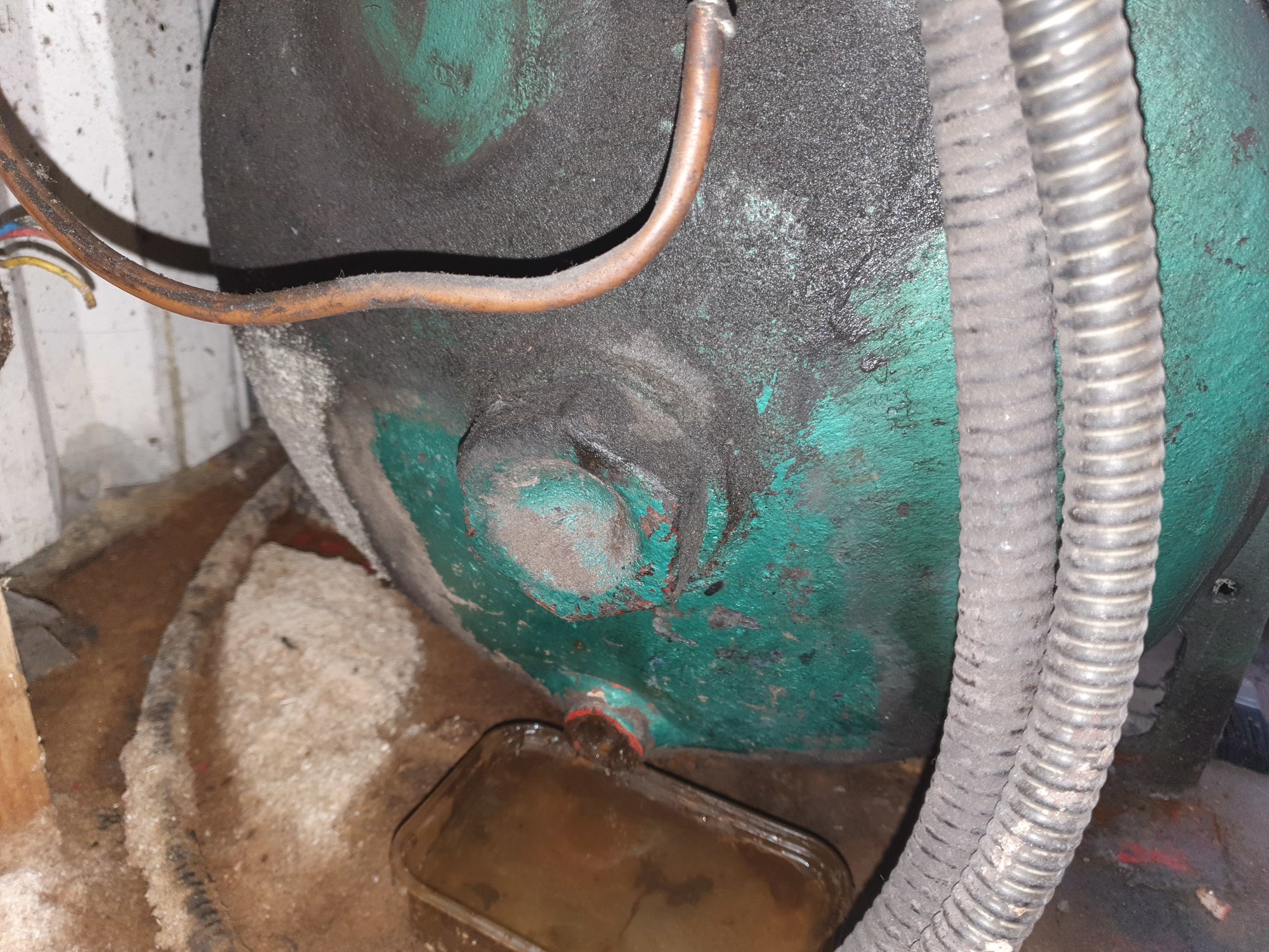

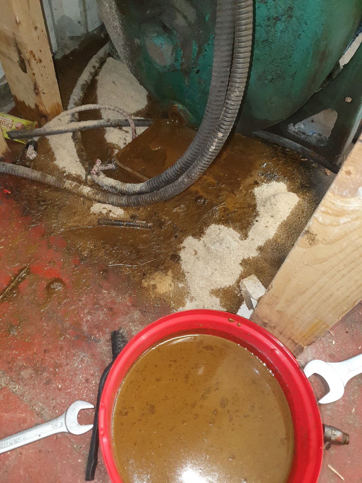

The bottom drain plug is completely seized and the side plug, (think its meant to be the one for releasing pressure after use), is the only one I can open up. Have drained at least 3ltrs of water.
Question is, how best can I effectively clean out the oil sludge? Research suggests the wrong oil has been used over the years, (previous owner was a car mechanic and owned it over 40 years, he suggested just using car engine oil..), and it has seeped in to create the sludge.
Am I best off removing everything from the receiver and dropping diesel in to thin it and drain out?

(Thinning it then tip the compressor a bit might be a better idea)
