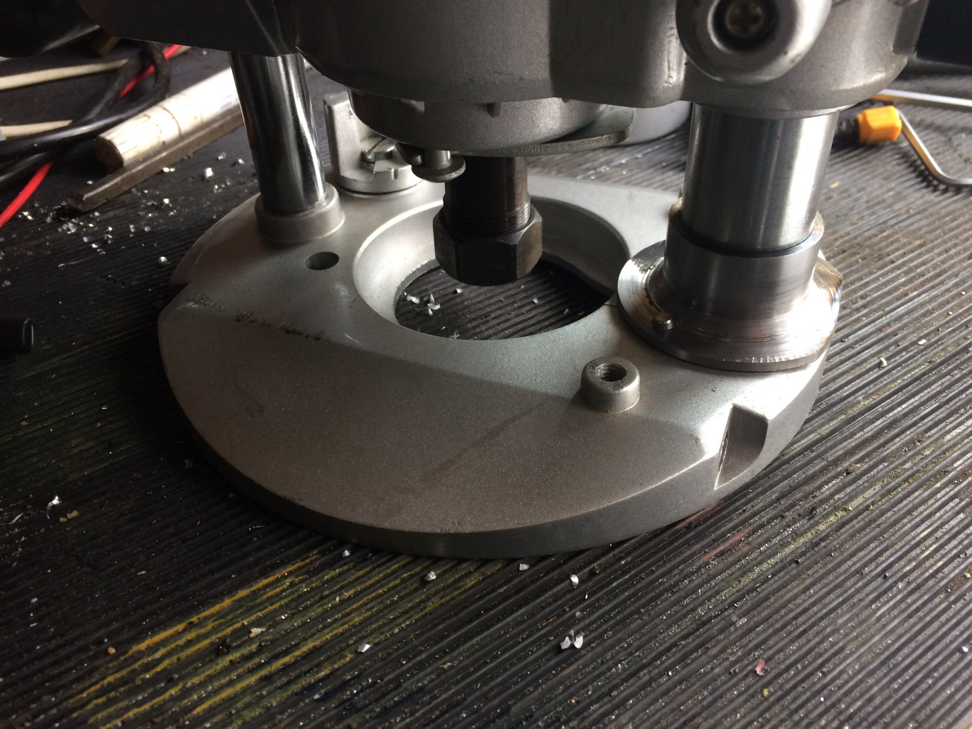

james butler Member Messages 1,527 Location birmingham england Apr 13, 2017 #21 well I've managed to repair it and seems pretty solid. turned myself a supportive collar which has been bolted into the base and araldited to the shaft and base for extra support. IMG_0302.JPG 458.9 KB · Views: 37
james butler Member Messages 1,527 Location birmingham england Apr 14, 2017 #22 you can just about see the screw heads IMG_0303.JPG 374.7 KB · Views: 35
