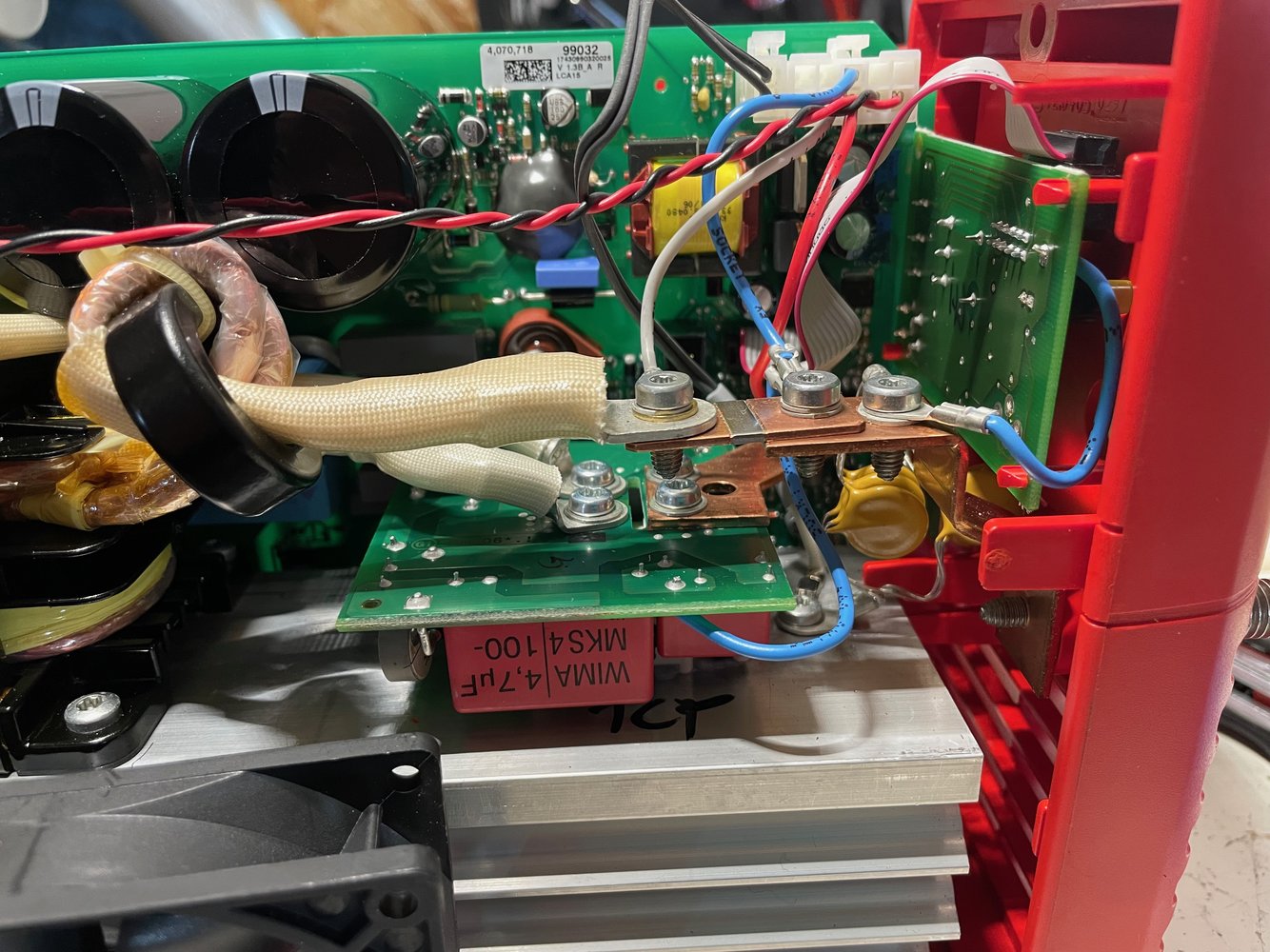

Hello everyone and thanks for having me. ;-)

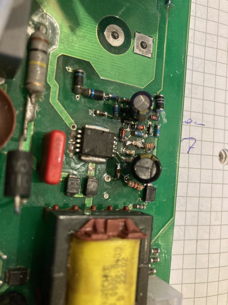

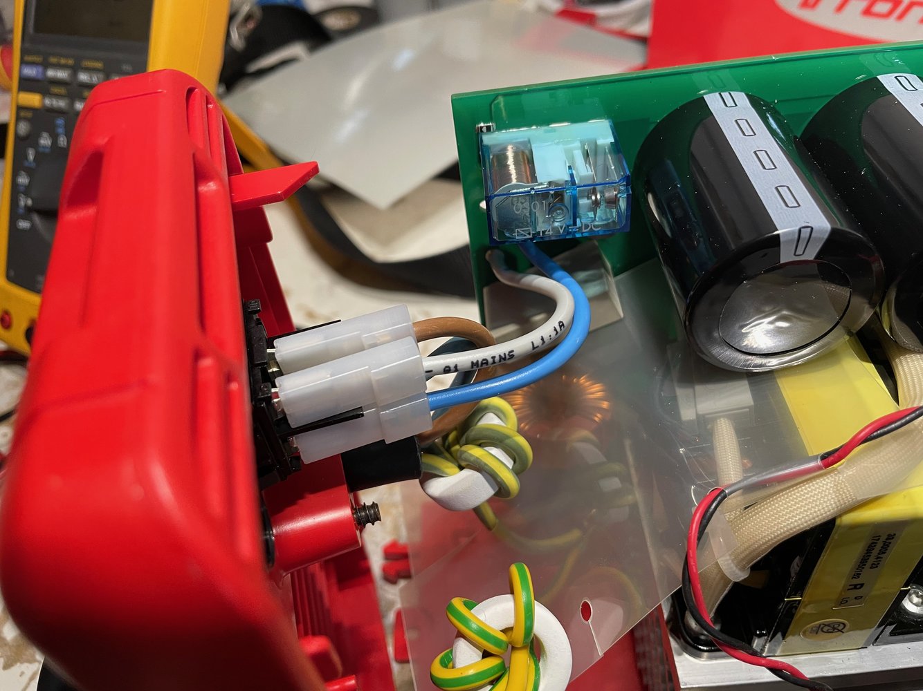

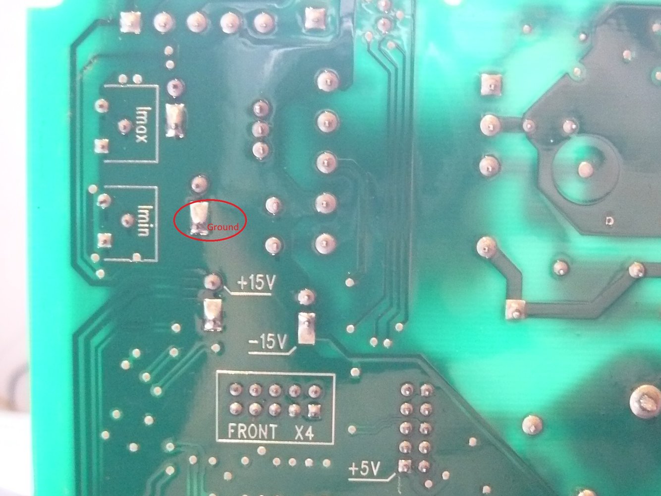

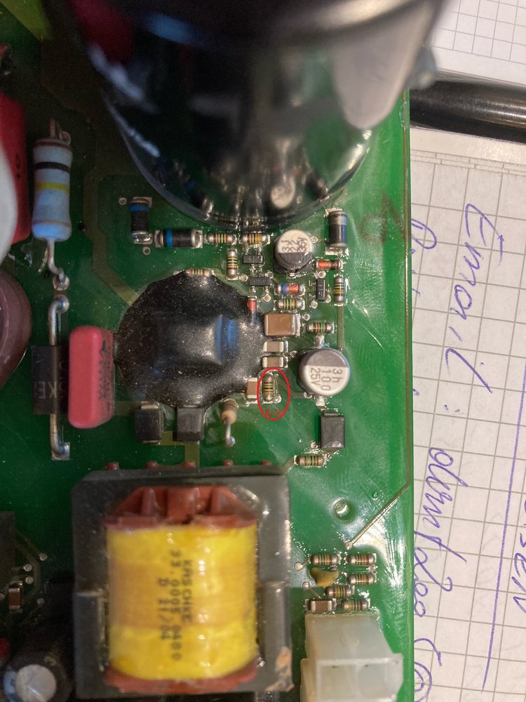

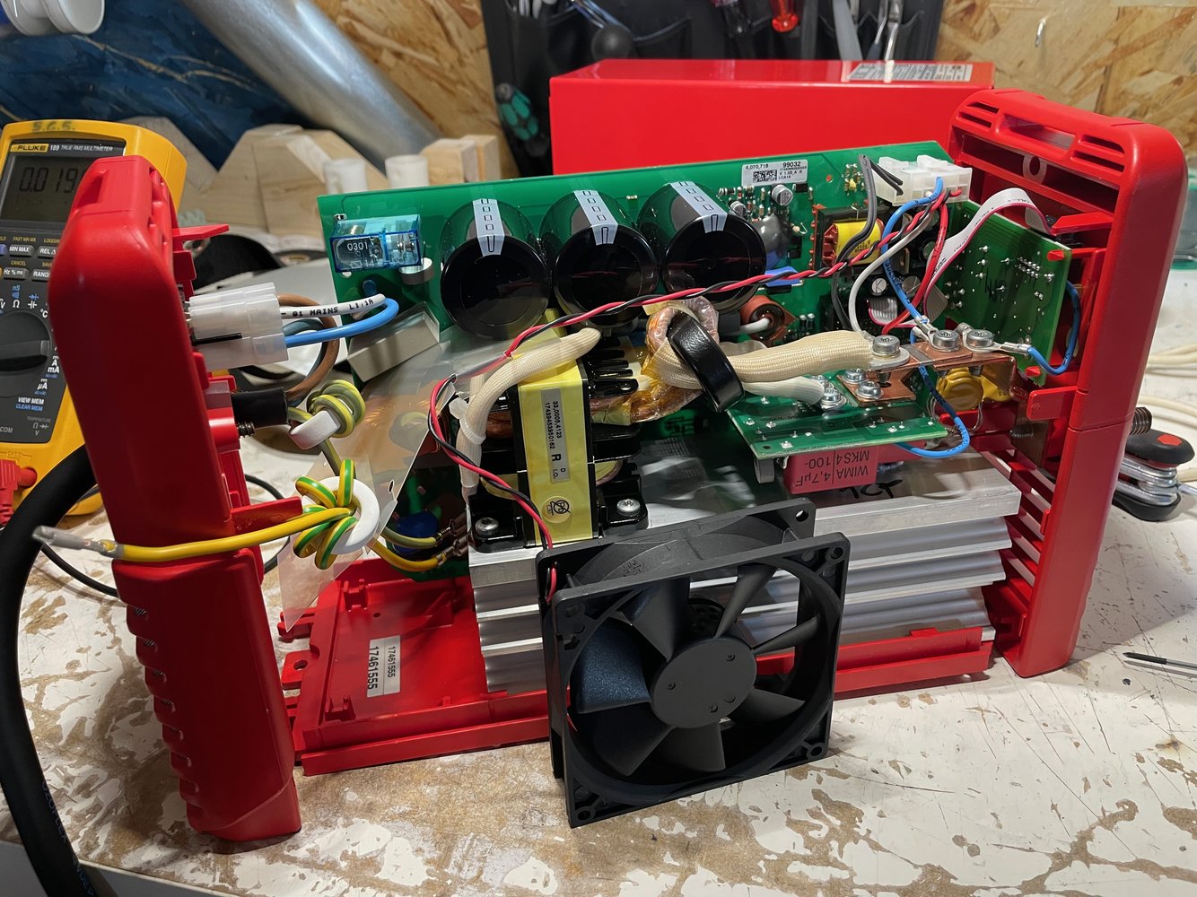

I am right now sitting in front of my broken Transpocket and I was hoping to find some help to fix it. I am workin in the center of Greenland right now and it's not so easy to get a replacement shipped over. So in case it's just an easy fix I would like to give it a try. Maybe someone here had kind of the same problem.
The device by itself looks quite nice - we actually use it not to much - just when we drive out of camp and when there is no 3-phase grid available.
Anyhow - I checked the power line which delivers perfectly 230V AC behind the main switch. But that's actually it already. The vent doesn't start and I also don't get the green LED lights on front of the device.
I was looking for some fuses or other protective electonics like a varistor etc. I also don't get the 15VDC on the electronic board. Without the schematics I am kind of blind. I also wrote to Fronius if they might sent me the schematics for the 1500.
So this is my problem here. Any advice is highly appreciated.
I wish you all a good time.
Martin
Martin
