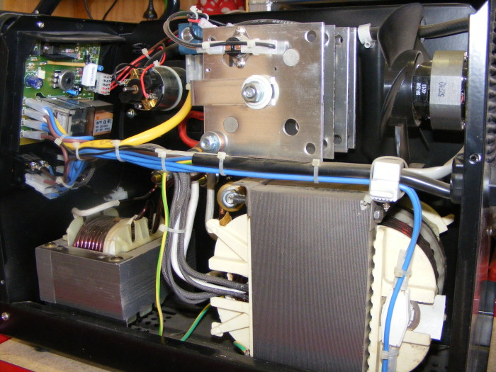

so i pulled open the box and saw a large amount of twisted welding wire i also saw where the welding wire arched on a bolt (which created the bright spark).

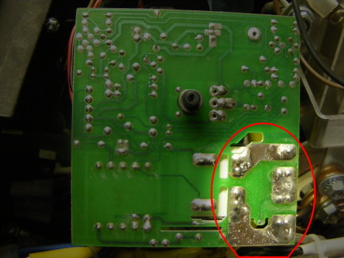

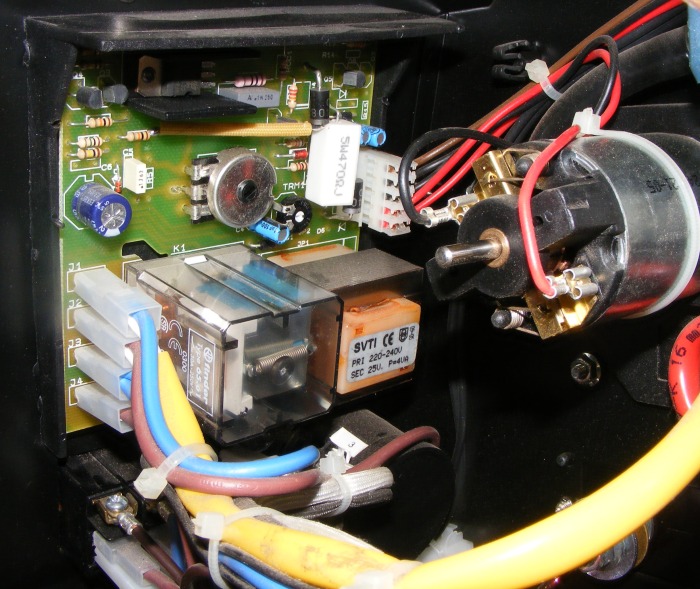

the only noticeable thing in the welder was the wire speed control circuit board ( not sure of correct name)

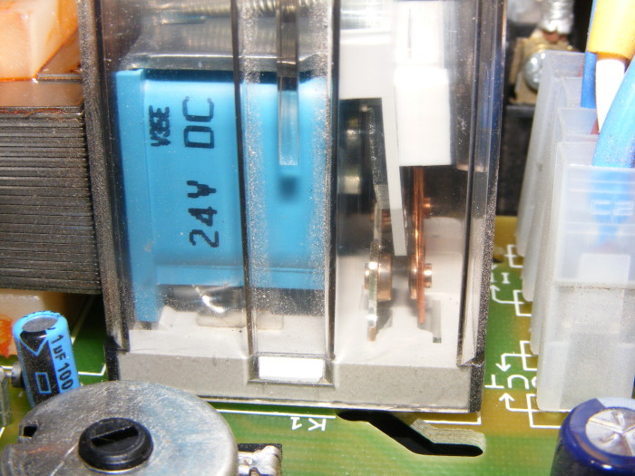

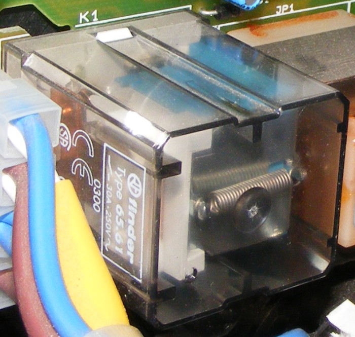

there is a little clear box with a electro magnet in it.. i noticed that there was a small black mark on the inside of the case like a burn mark also the two little lever things that touch together when the trigger is pressed were also black.
the little clear box still seems to work as when you press the trigger you can see the little things coming into contact with each other you can also hear the coils powering up but the motor wont move.
i have already tried cleaning in between the two things inside the clear box using fine sand paper however that did no good.
please people help me here is there anything else i should check? you guys know what the problem is?

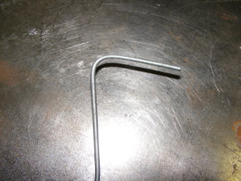

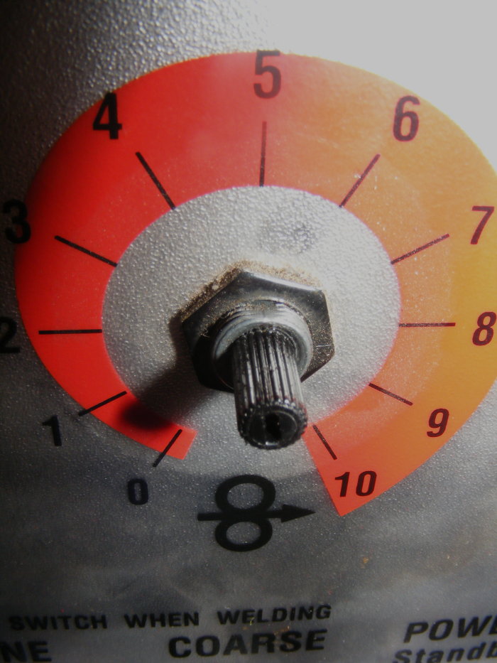

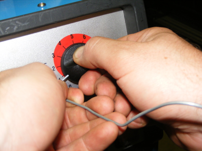

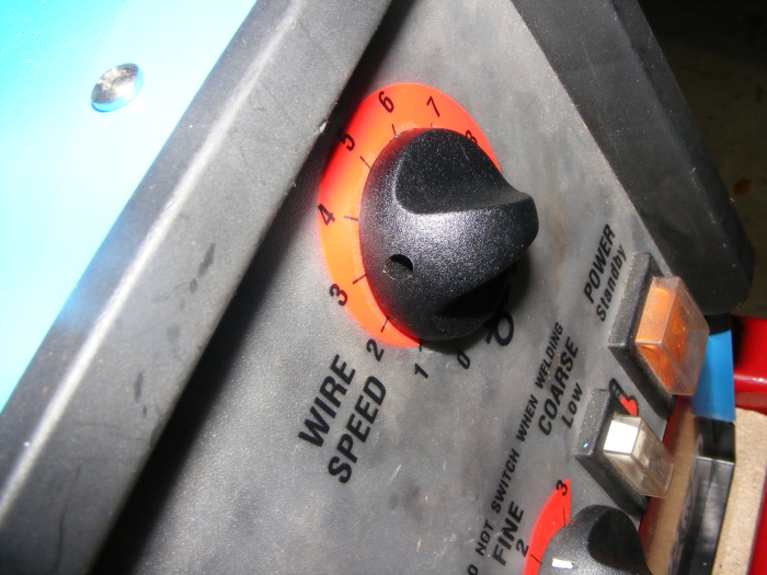

.. dont know if its a permanent solution but it seems to be working just fine for now
