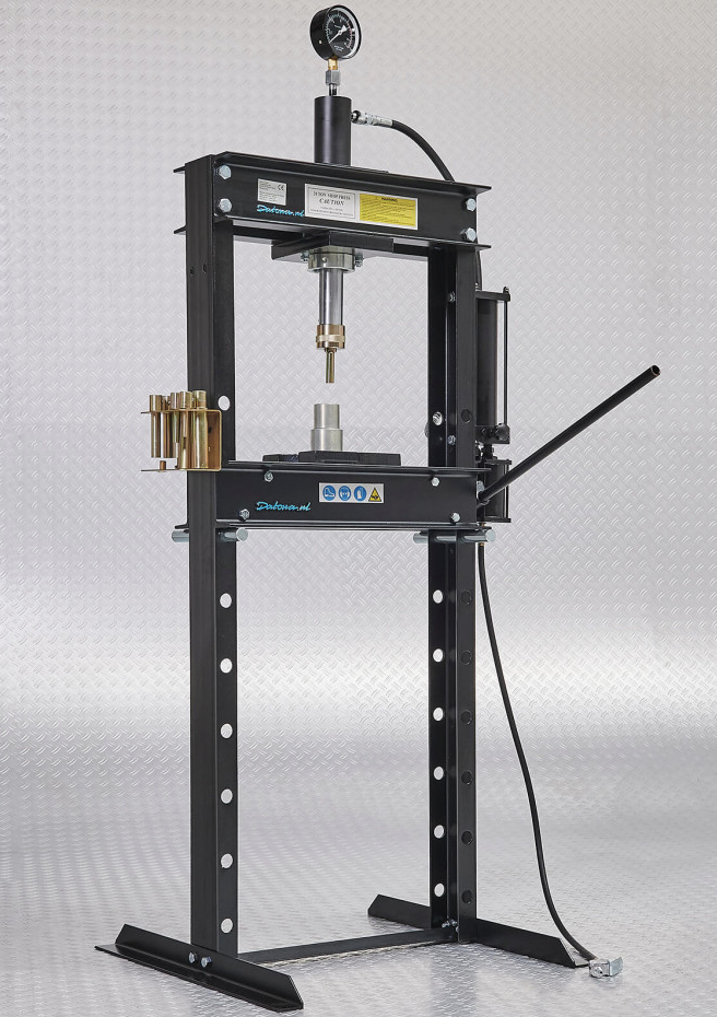

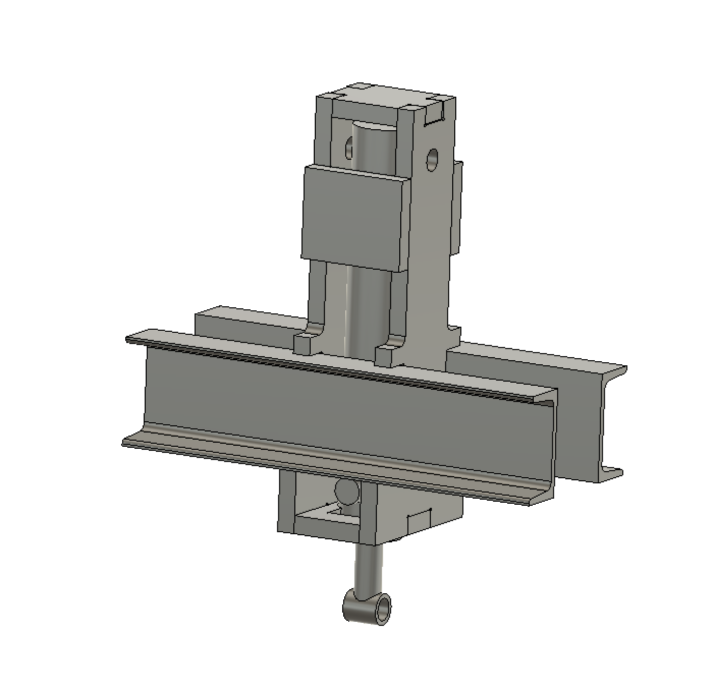

Am getting pretty tired of broaching keyways with my manual Chinese press, thinking of making a bracket for a double action hydraulic cylinder which I'll power of the hydraulic pump of my 4 post lift.
I have a 70mm cylinder which will roughly press about 5.6 ton at 200 bar, will this be enough to broach 12mm keyways, I assume it is but am not sure.
Any remarks about the design below? All made out of 20mm steel plate, it's basically a bracket that holds the piston that hooks onto the 2 existing U channels from the Chinese press.
Thanks Christof.
Type of press:

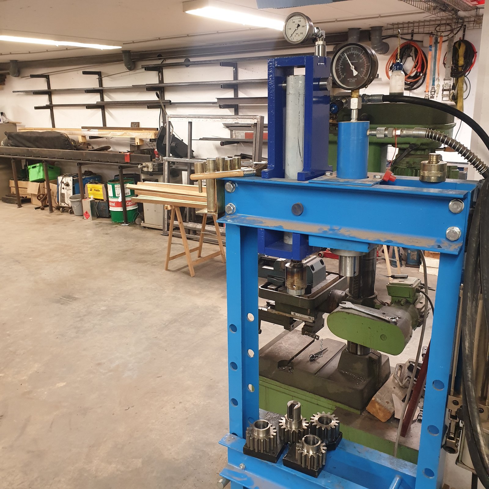

, I'm just a one guy side business 'shop' no budget and room for a dedicated press. So will probably go against advice and try it with the hydraulic piston.
