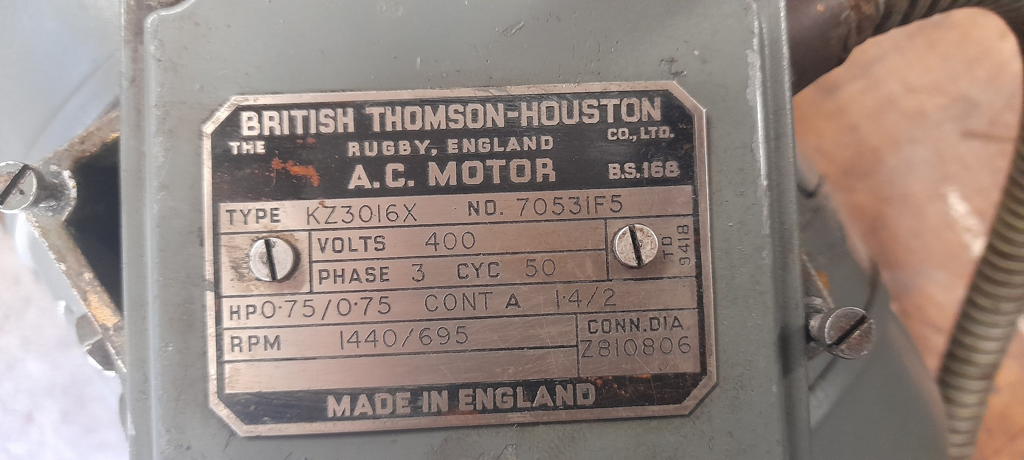

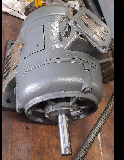

I recently acquired another lathe, this one fitted with a British Thomson-Houston 2-speed 3-phase motor. The motor is massive for its rated output (0.75 HP) and could easily be replaced with a different motor that is better suited for a cheap (220V) VFD. However, I'm inclined to keep this motor and have it permanently wired "high speed" and run from a 230V single phase to 380V 3-phase VFD. I already use this setup on my Arboga drill press. If nothing else, it's a cool looking motor that matches the vintage lathe. It doesn't bother me that it's not a "VFD rated" motor.

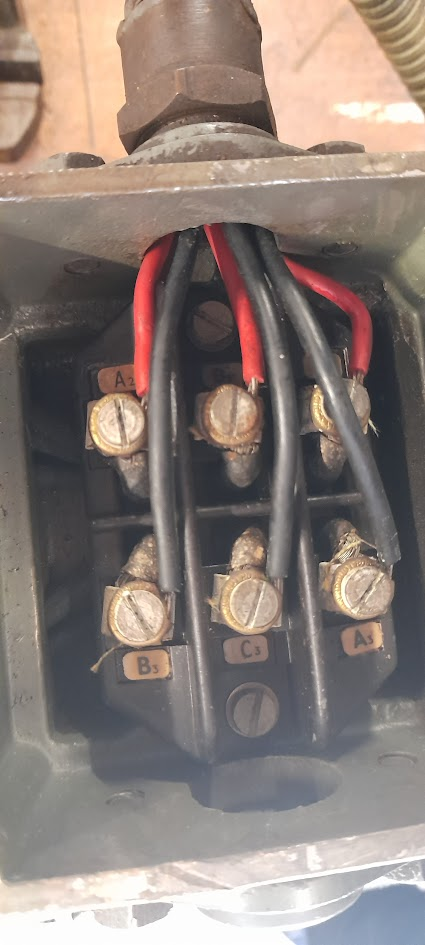

The lathe appears to have been played around with and I don't trust any of the wiring, so I'd like to start from scratch. I'm pretty sure the chances are nill, but if anyone has connection diagram Z810806 I would like to hear from you!

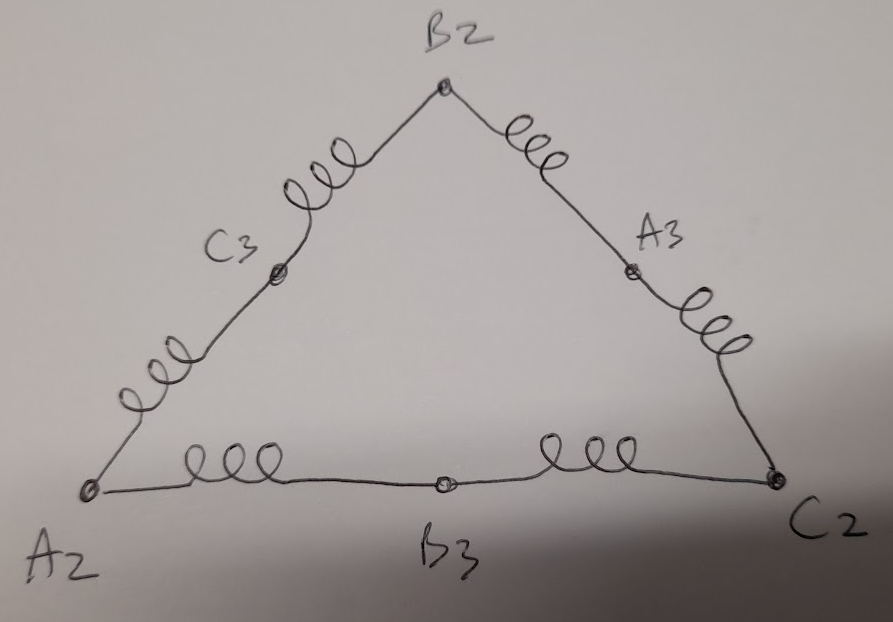

The motor has six terminals:
A2, B2, C2
A3, B3, C3

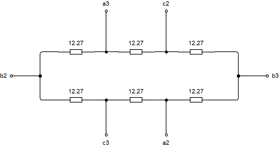

I have a whole heap of readings that I am currently trying to sort out before I post them here. I'm assuming it is a Dahlander 2-speed motor but there's something niggling me in the back of my mind suggesting that it may be something else, possibly due to the identical power on high/low speed?
