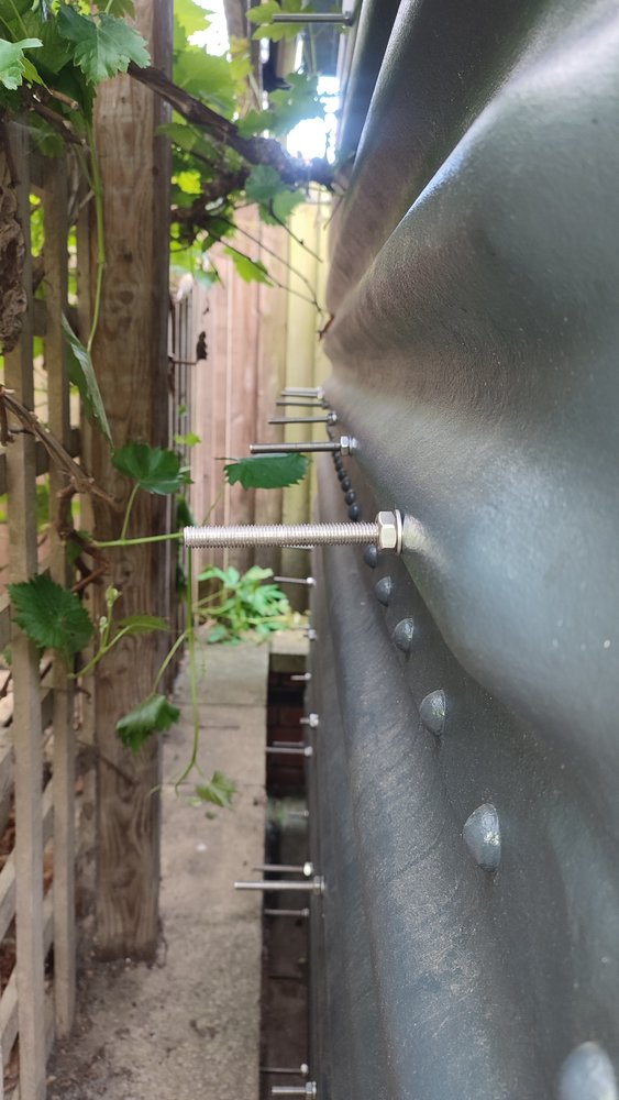

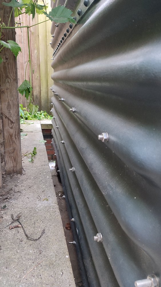

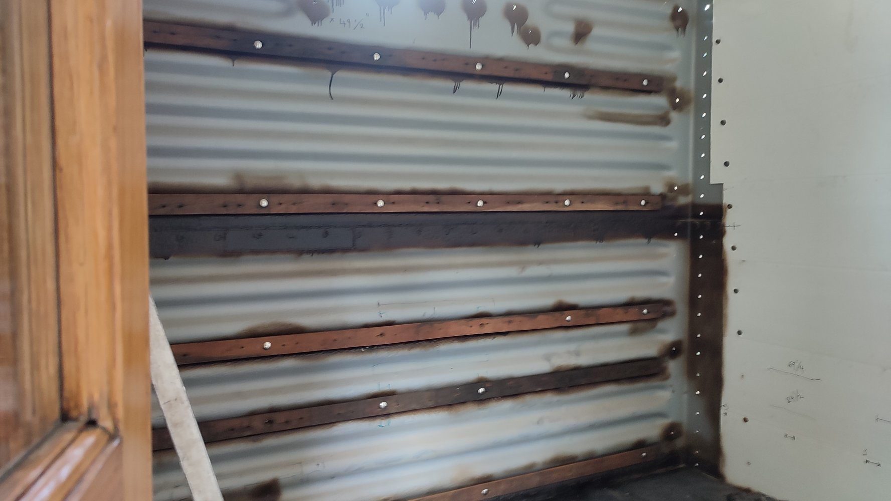

They do, unavoidable, so not worrying about it. If anything it will bring the heat out to the steel frame.

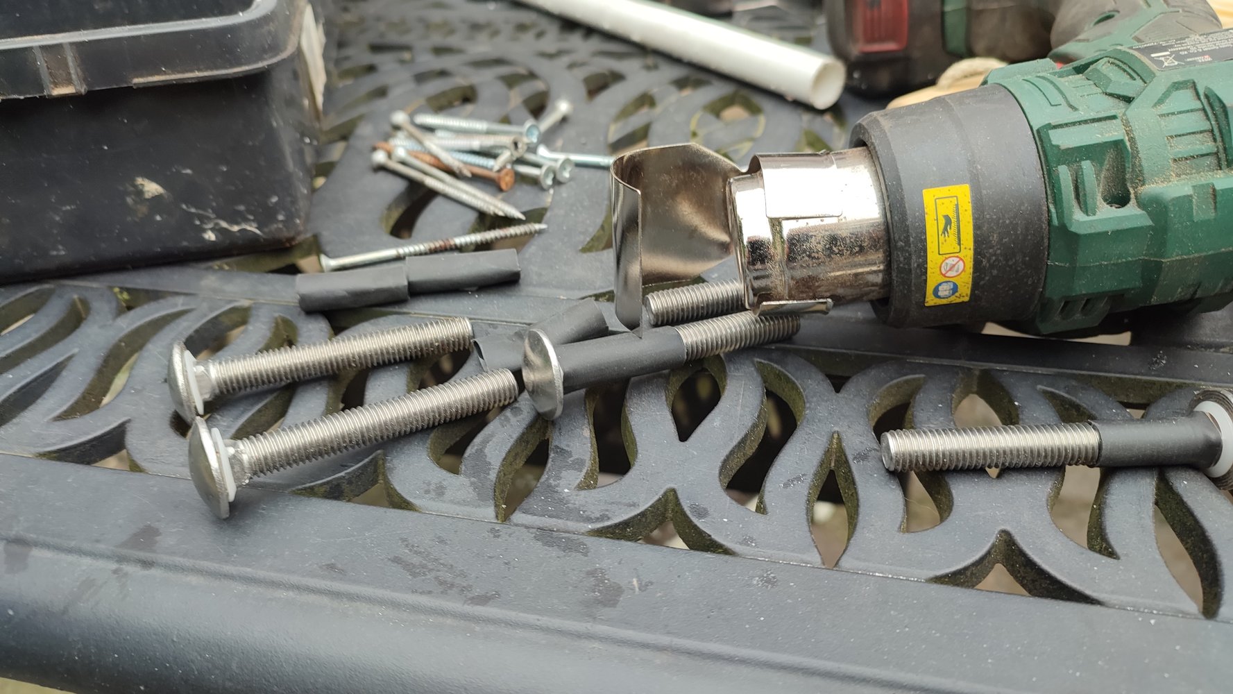

bolts holding your wood to the outside frame and smaller bolts from your wood so that they could hold your insulation would have given you a barrier breakThey do, unavoidable, so not worrying about it. If anything it will bring the heat out to the steel frame.
Do the bolts go through the plasterboard to the outside? if so you may find they get very cold in winter causing cold spots inside and condensate

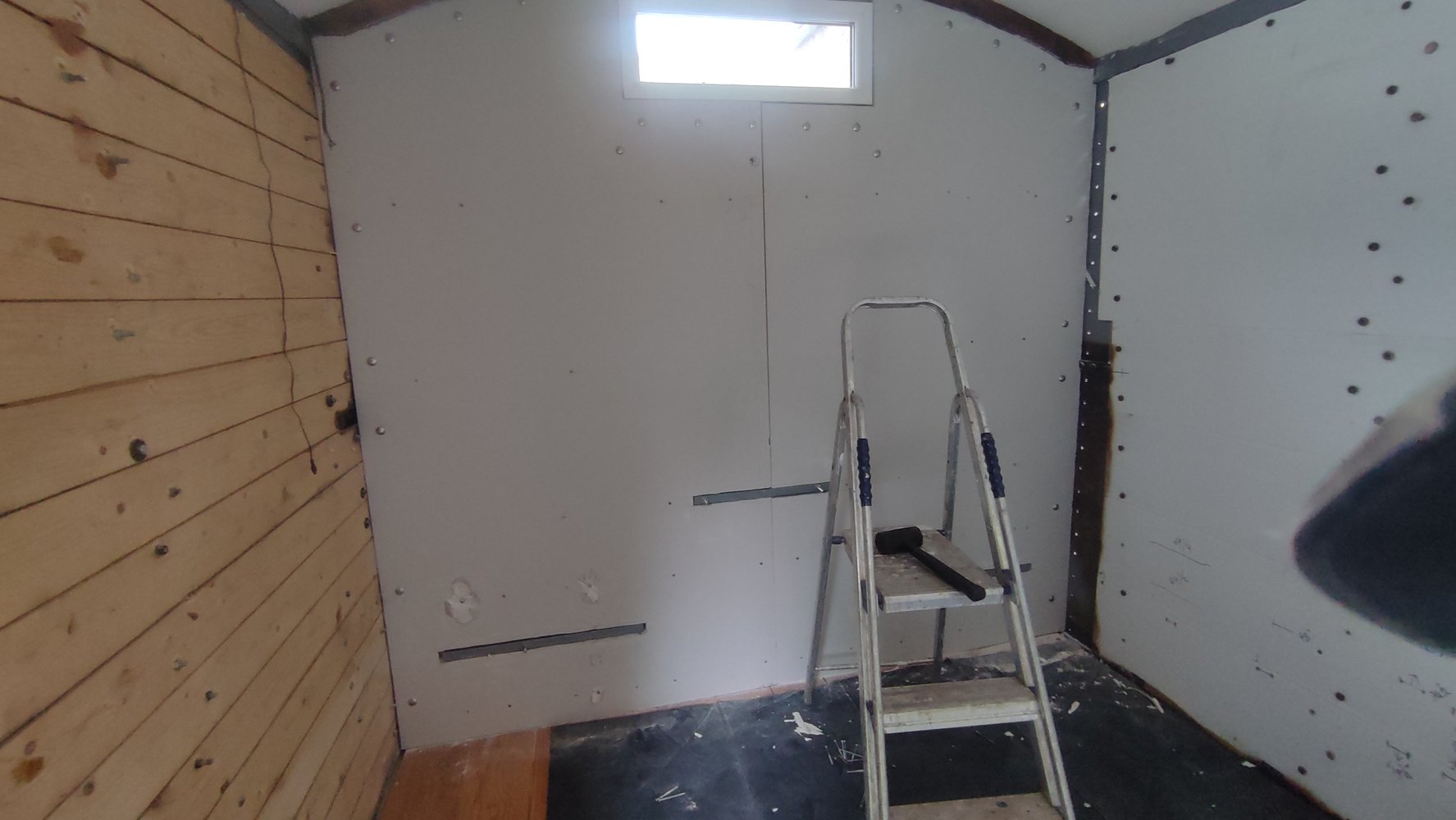

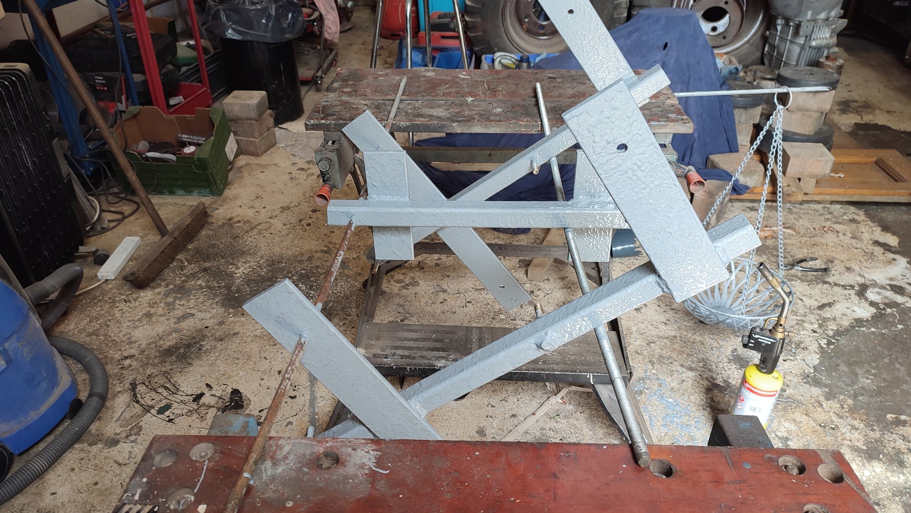

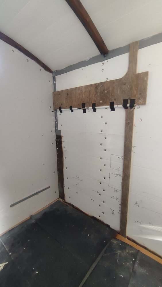

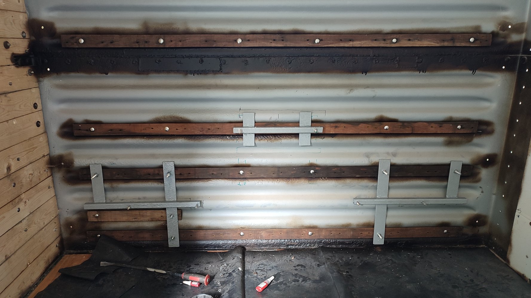

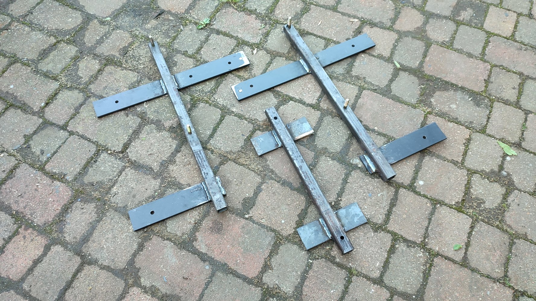

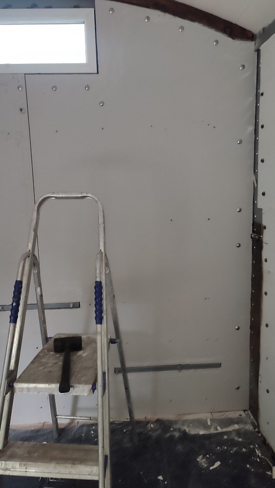

That’s ugly….Brackets painted and fitted. After work tomorrow I might get a slab on this end.
View attachment 451092 View attachment 451093 View attachment 451094 View attachment 451095

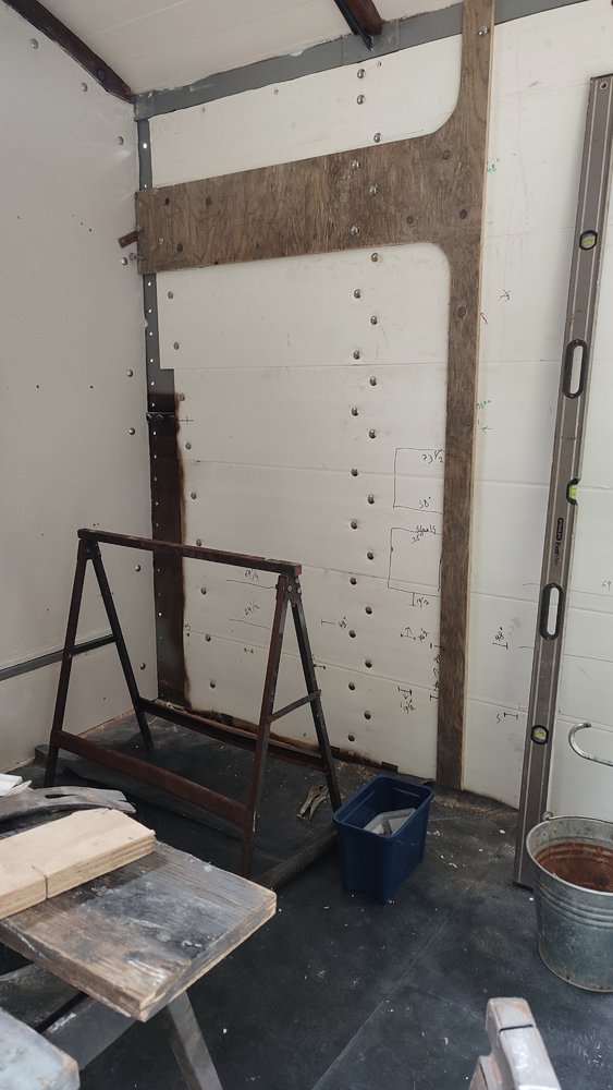

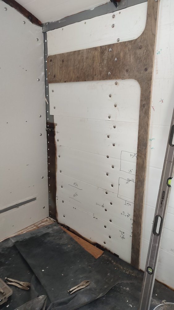

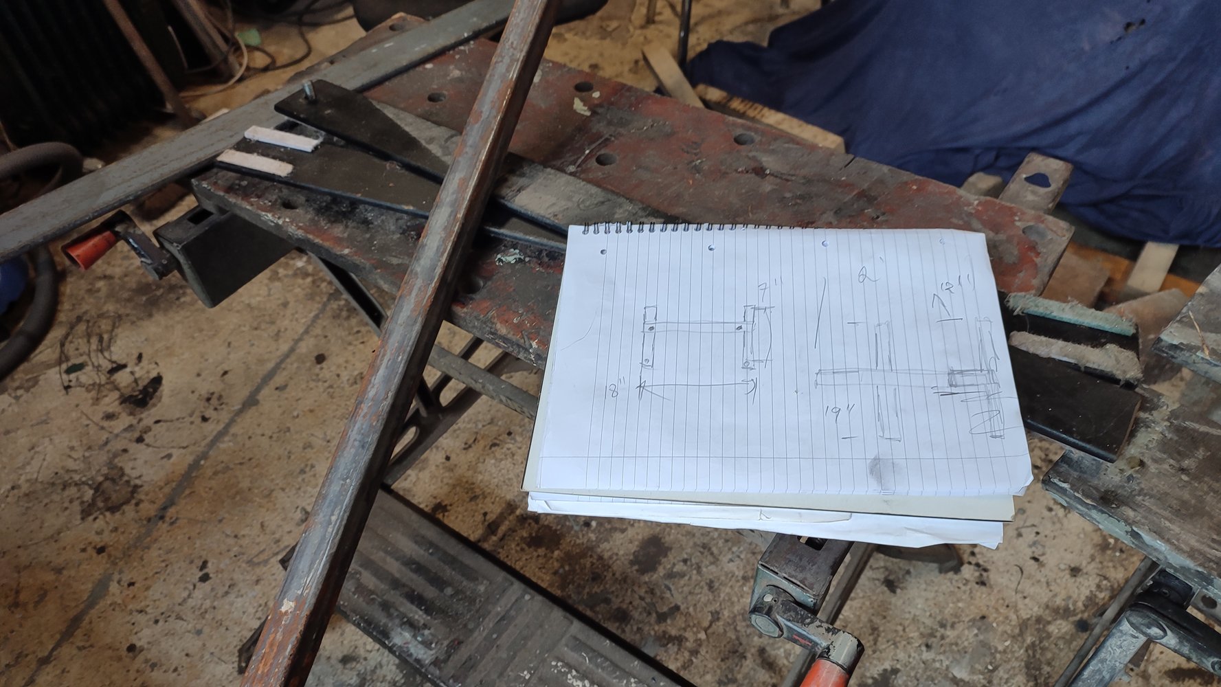

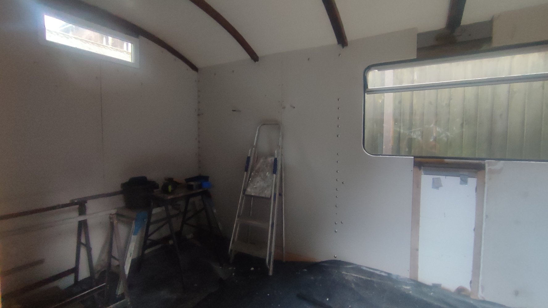

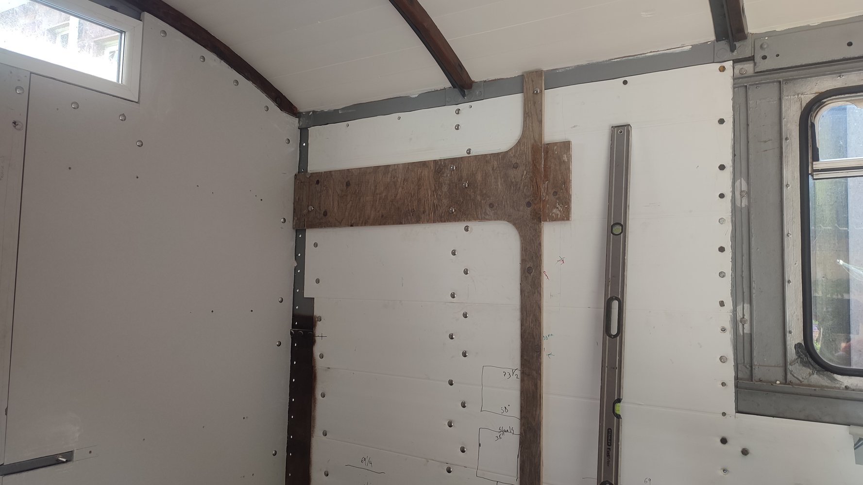

More internal bracing.

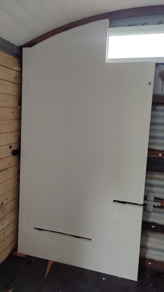

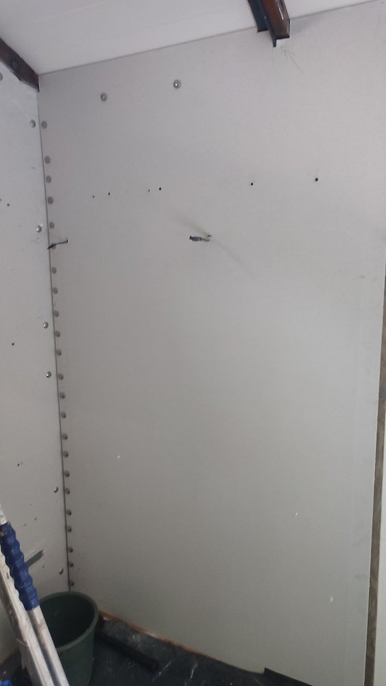

Not quite right, so I'll reposition and refix.

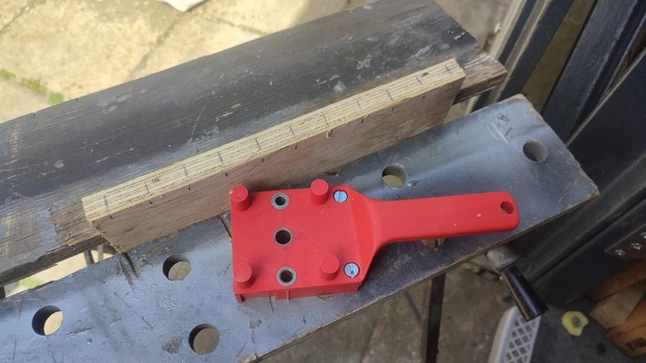

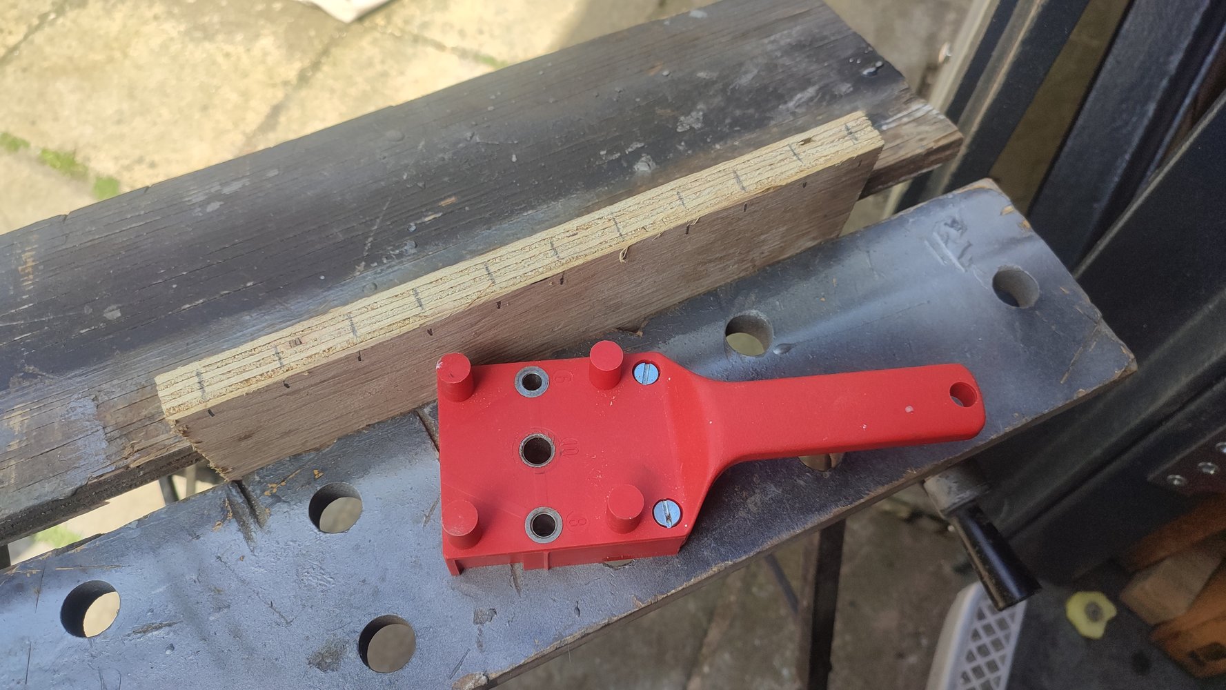

Hard to hold these things in place when drilling from the other side....
