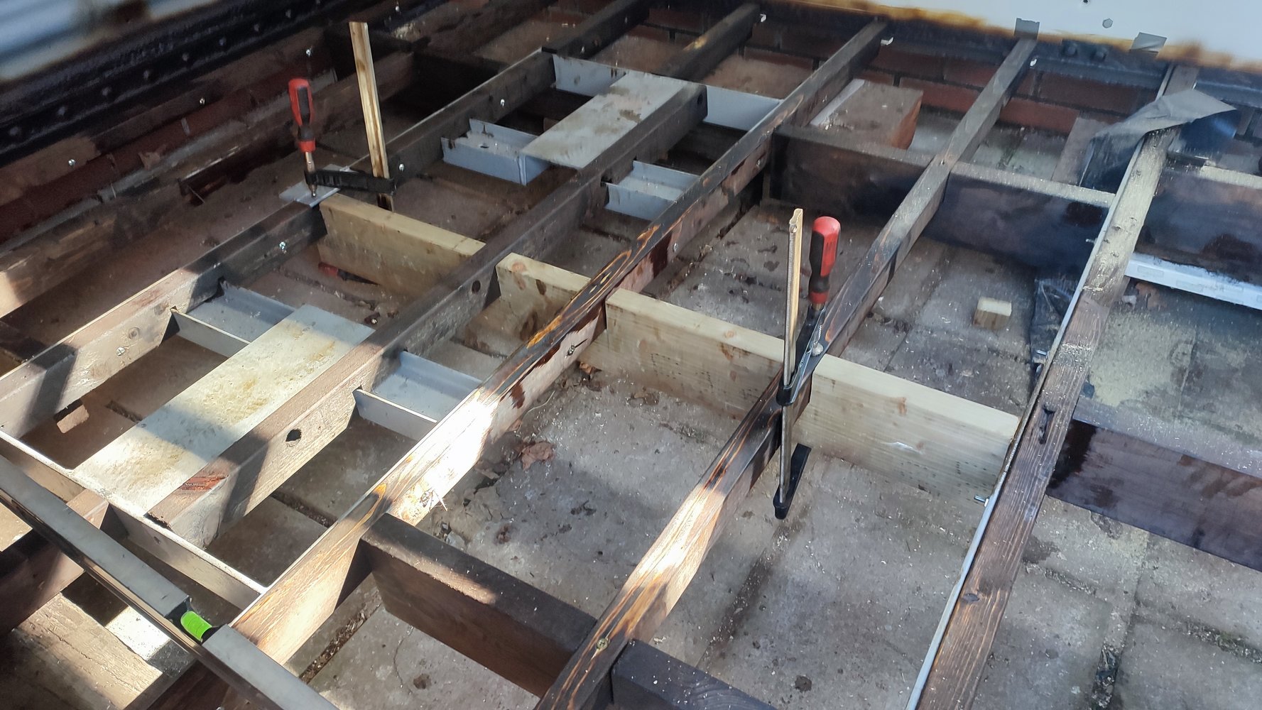

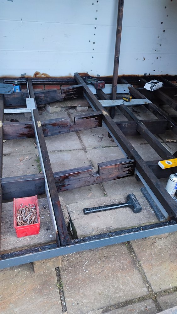

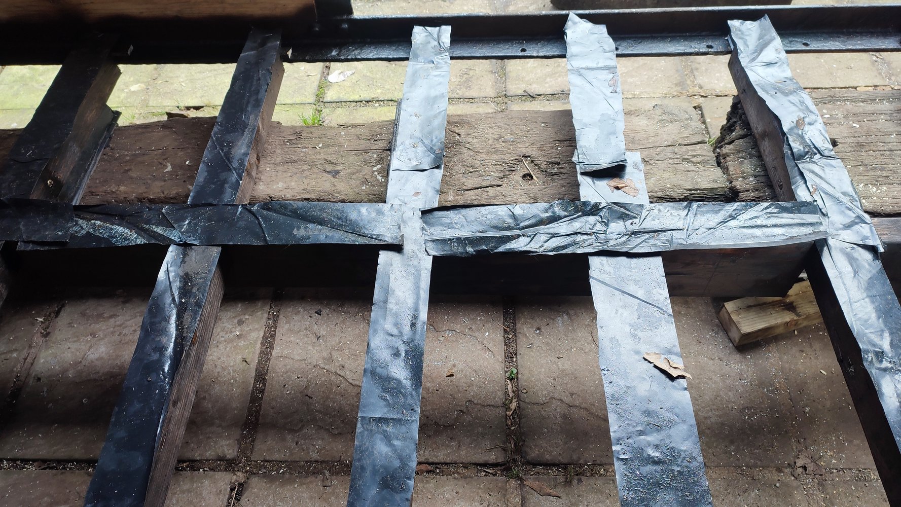

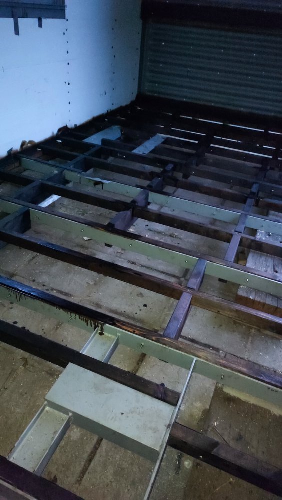

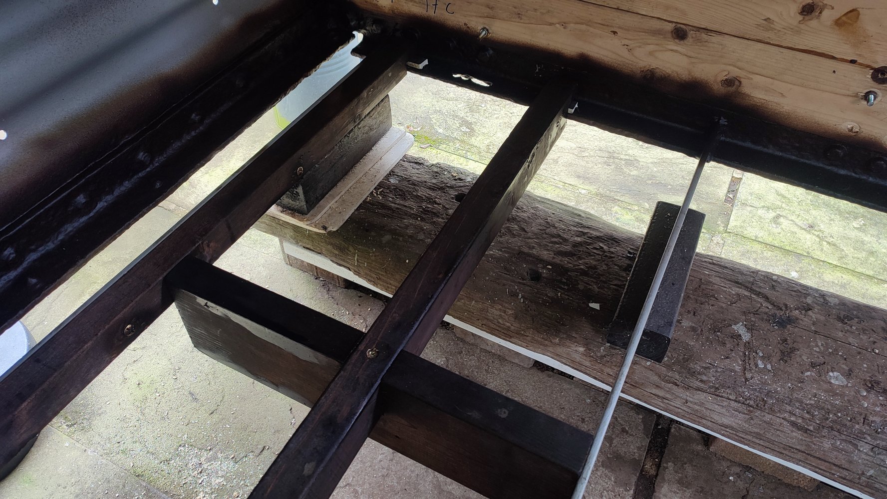

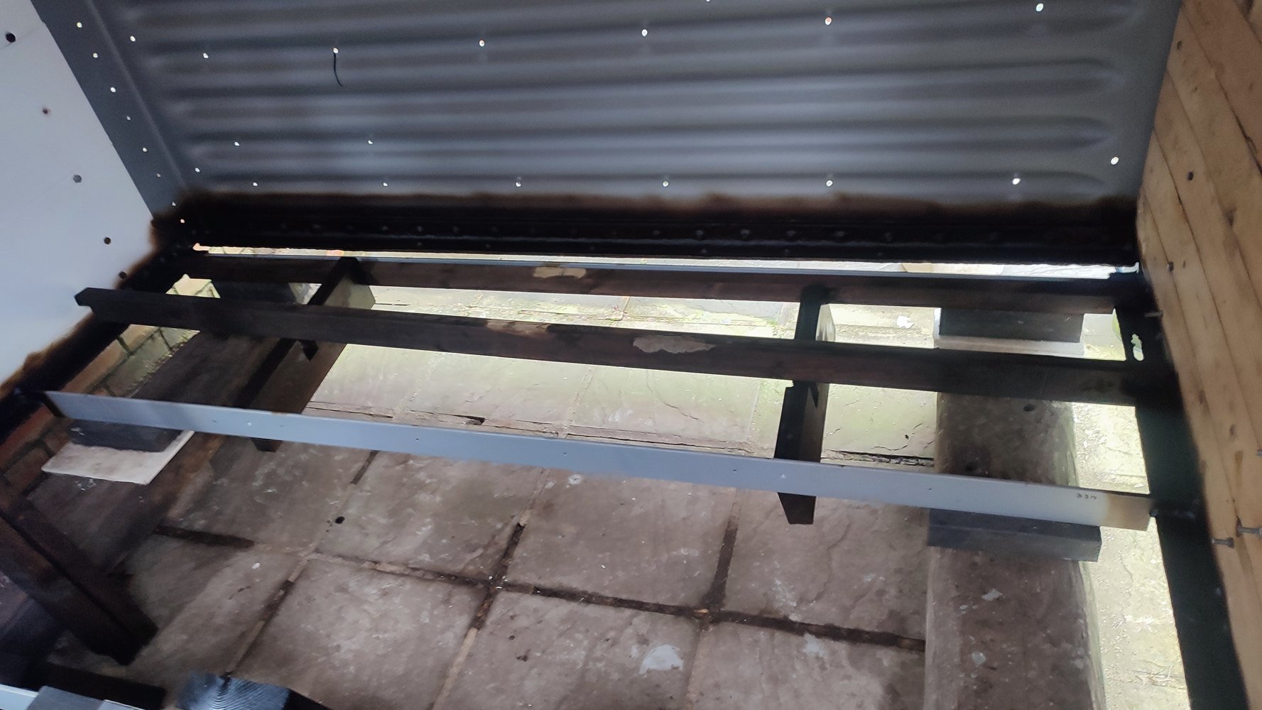

but arnt they lower than the original frame whilst the cross members are only 1-2" thick welded to the body of the topThe wooden joists? No. The whole thing is resting on the steel cross pieces. Which rest on the sleepers.

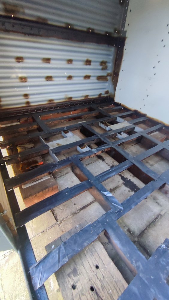

The floor boards will be secret nailed to the wooden joists, but will be isolated from the creosote with a DPC of some sort, either actual DPC or visqueen DPM.
Not sure exactly how I'm going to suspend the insulation between the joists, but I expect I'll think of something.....
