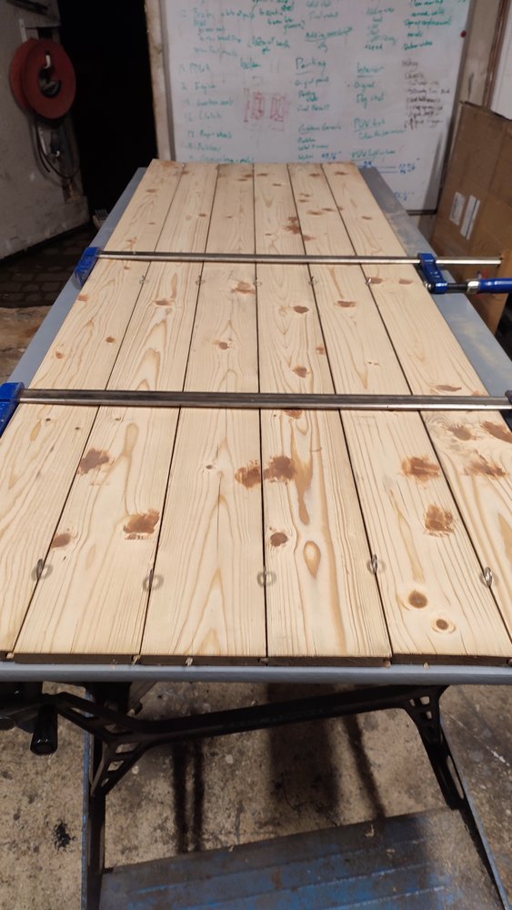

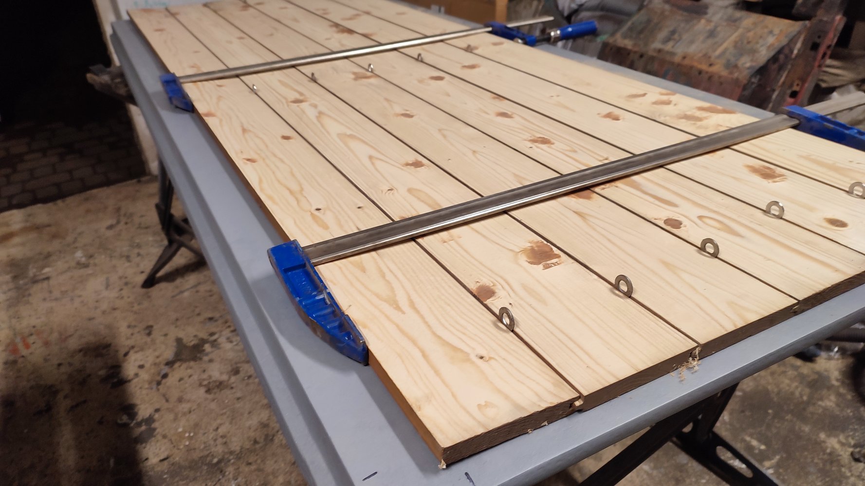

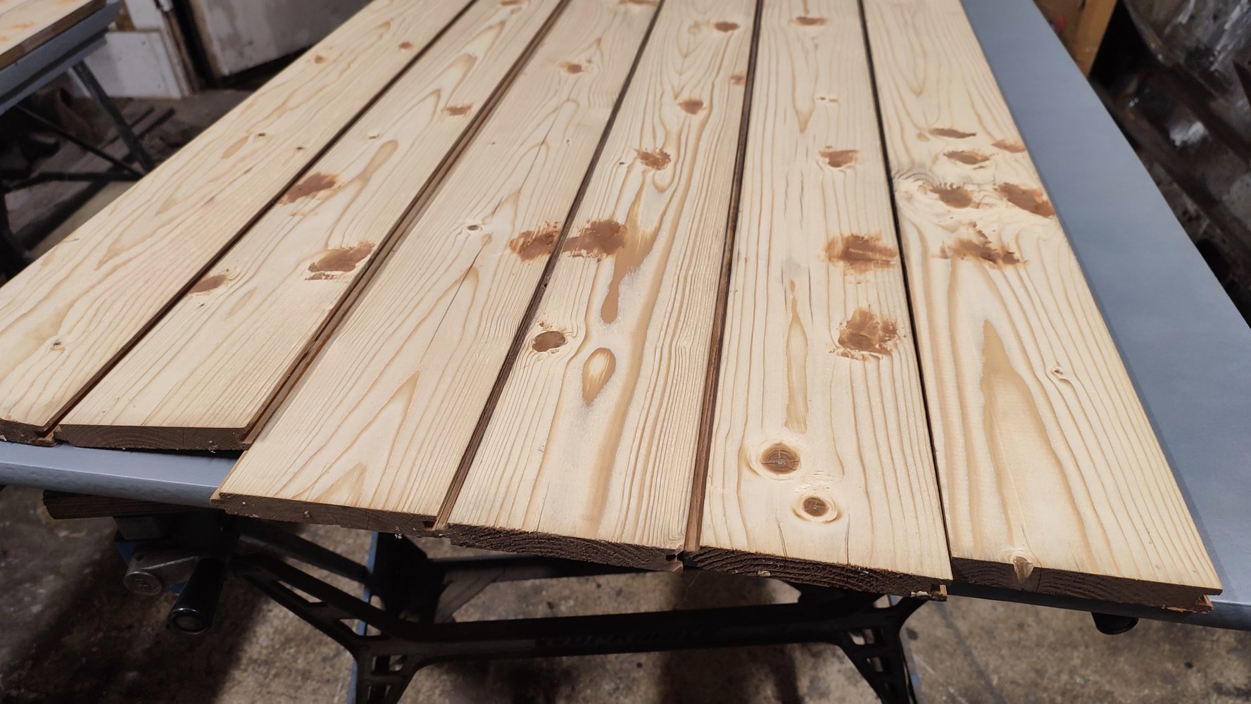

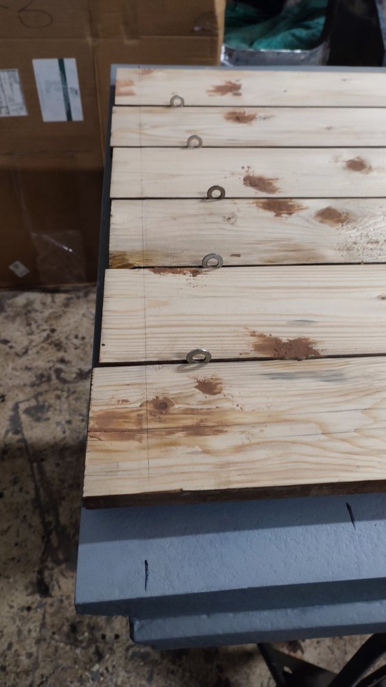

I like the use of washers as spacers, possibly an old trick but new to me as a non wood worrier.I spent a bit of time playing with the outer planks this evening. I'm going to check tomorrow what the alignment with the bolt holes will be like, but it's going to be either with the tongue and groove in the centre, below, or with the centre of a plank in the middle. I think this is going to work.
View attachment 440550 View attachment 440551 View attachment 440552 View attachment 440553

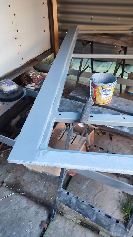

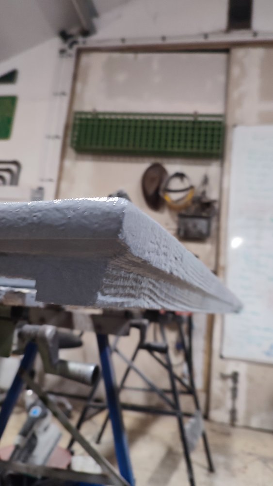

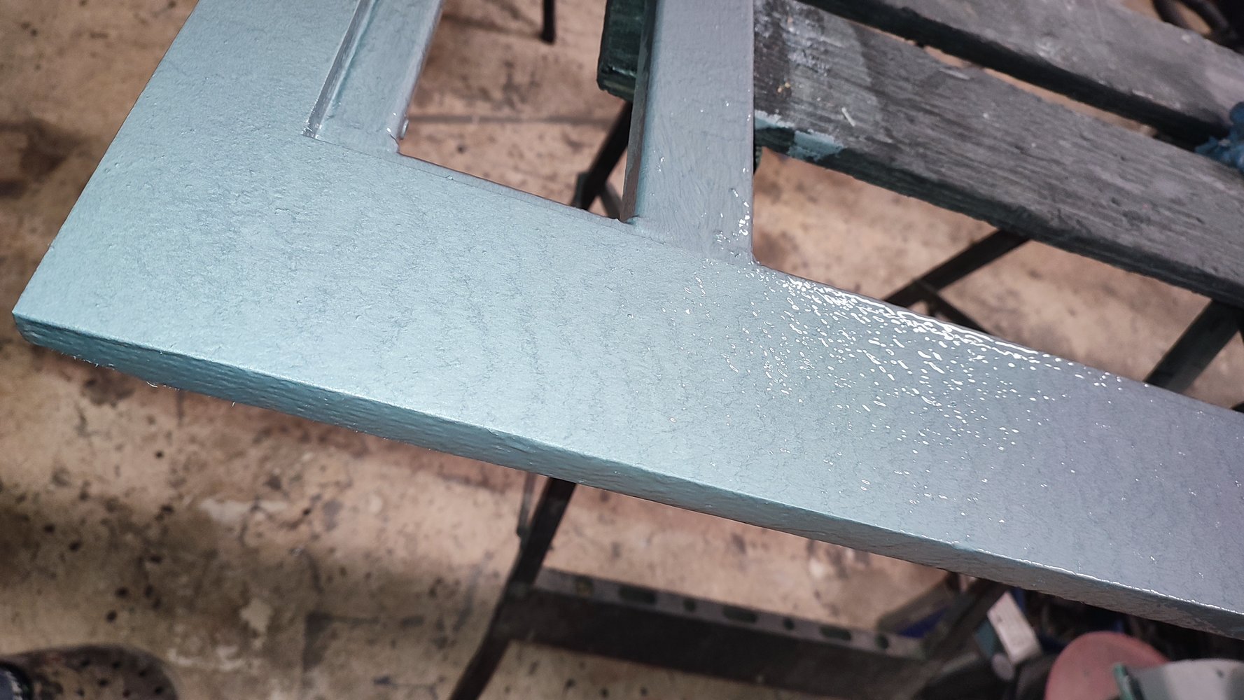

Worth noting I got a local painter in to paint the T&G. I probably would have just rollered it all but he insisted on painting with a brush. He bought very good quality paint brushes and it cost a lot to paint but he did a fantastic job, took a good while to paint, the quality of his work was spot on, finish was superb and it still looks great.
I think that using temporary spacers when installing T&G boards is a good idea in most cases, keeping in mind that wider boards will expand/contract more in actual width than narrower boards, so one should adjust spacer thickness accordingly. That said, if the moisture level in the new boards is high enough, spacers 'might' not be necessary. One could use a wood moisture meter to note the moisture level during extended periods of high relative humidity in some of the old existing (and preferably unpainted) T&G boards of the same kind of wood, and then use that as a rough baseline for comparison with the new wood's moisture level. However, since there are a number of other factors that can influence wood expansion/contraction, one might want to err on the safe side and use spacers...worst case, you just end up with somewhat larger gaps during periods of low relative humidity.I like the use of washers as spacers, possibly an old trick but new to me as a non wood worrier.
