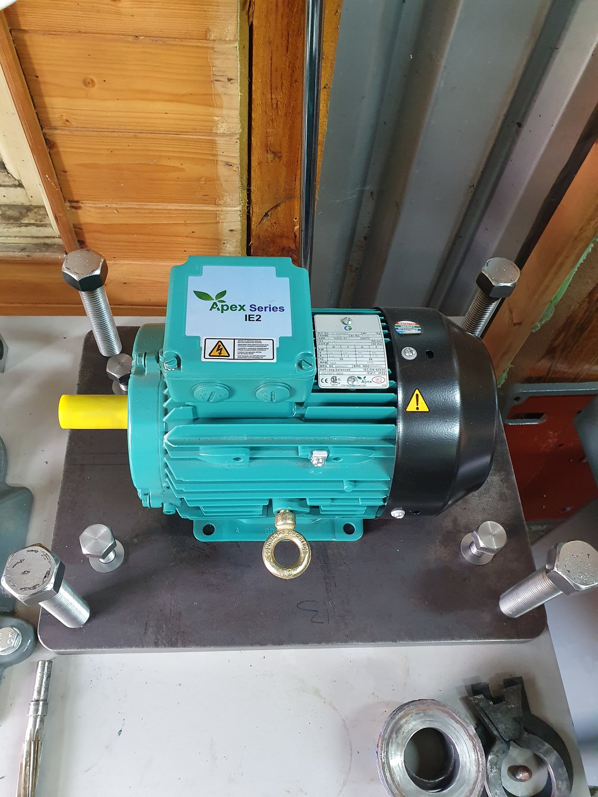

I will take em out to the next whitworth size brad.Weld em up and redrill. Preheat the plate to 150 first though or your weld will be hard.

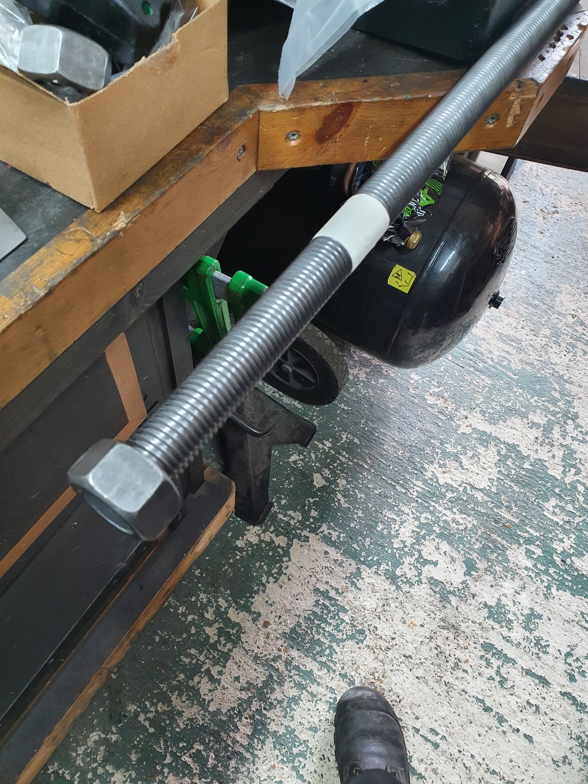

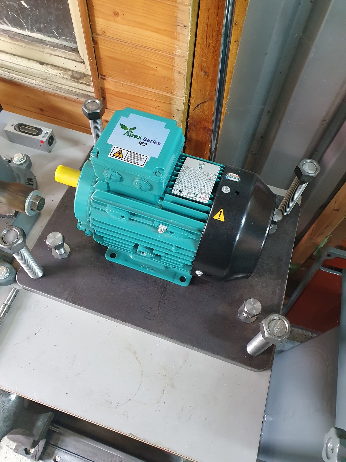

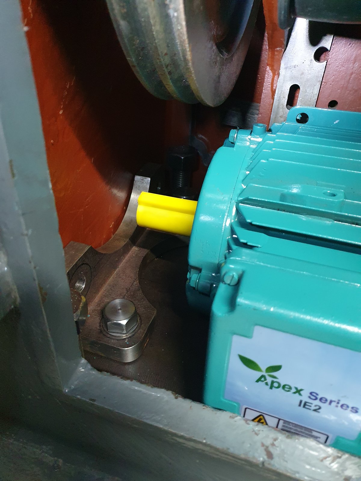

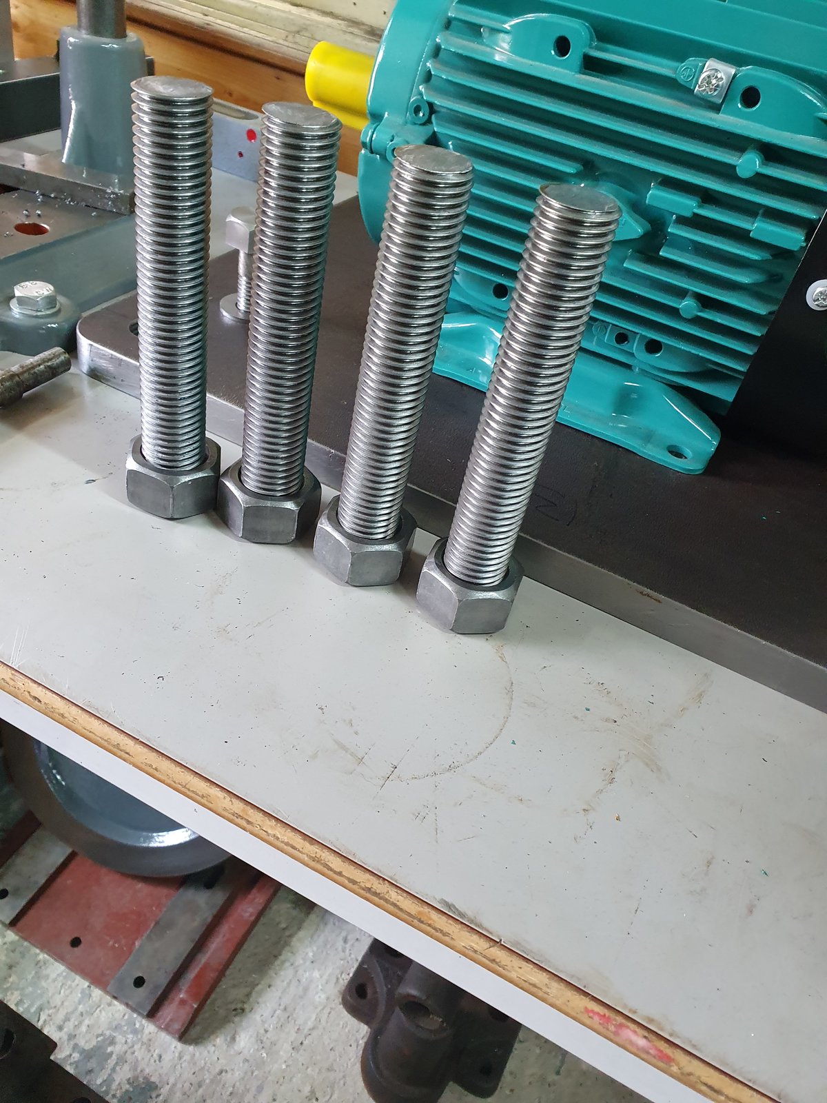

Today I am making the jacking bolts for the empire lathe motor plate .these being 1 inch whitworth. View attachment 240932 View attachment 240934
Threaded. Easier for this at the present timeThreadbar or did you turn the screws yourself?

Wouldn't want to scratch the lathe's lovely paintwork.Threaded. Easier for this at the present time
I wouldn't know how to describe myself
Lol. That was a paint brush finish. Nothing to fancy.Wouldn't want to scratch the lathe's lovely paintwork.![]()
