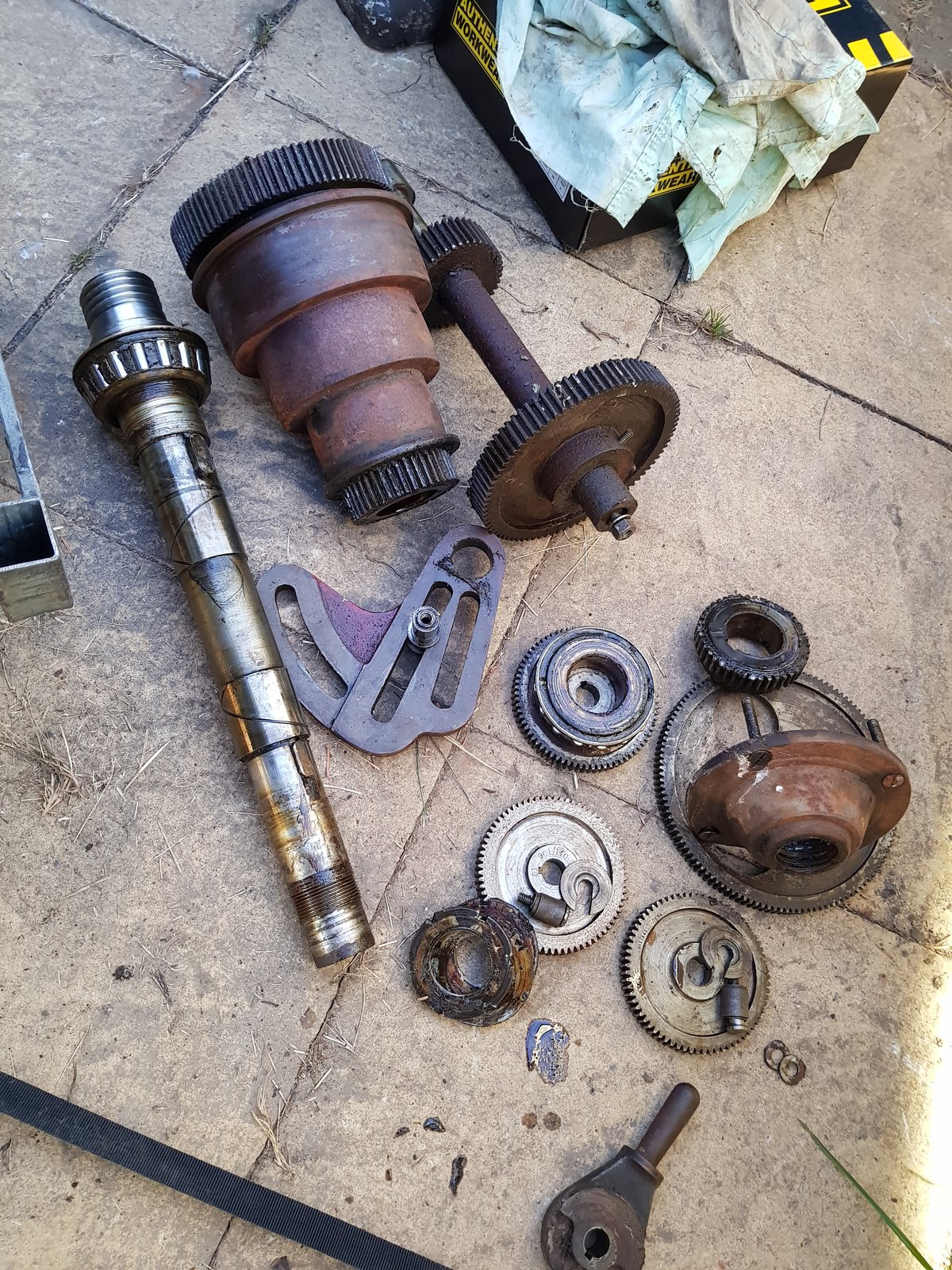

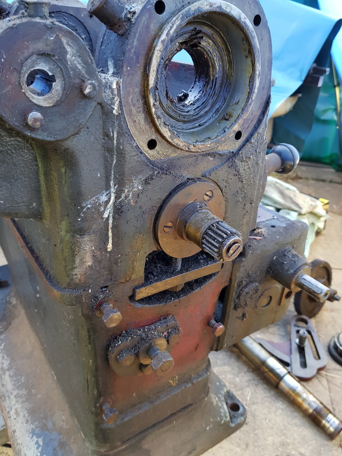

I agree. One bolt holding it on. Fk thatI've never seen that before. It doesn't look very secure or repeatable.
Yes. It's seriously tightThat looks like a bush that someone has screwed onto the spindle nose.
True. But a lot easier to get than the gamet bearings for a Colchester. It is a 127 gear.Timken bearings may be available but they won't be cheap.
Is that big gear 127 teeth?
Yes had a result. And a bonus is it has the Norton gearbox .Good point, you won't be paying the 600 Group premium. Lucky you got the gear with the machine, they can be quite hard to find if you need one for metric threading.

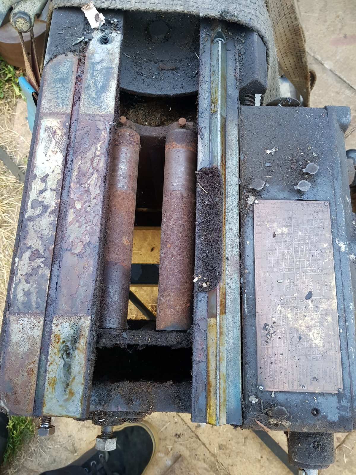

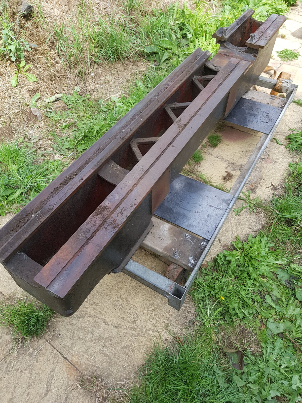

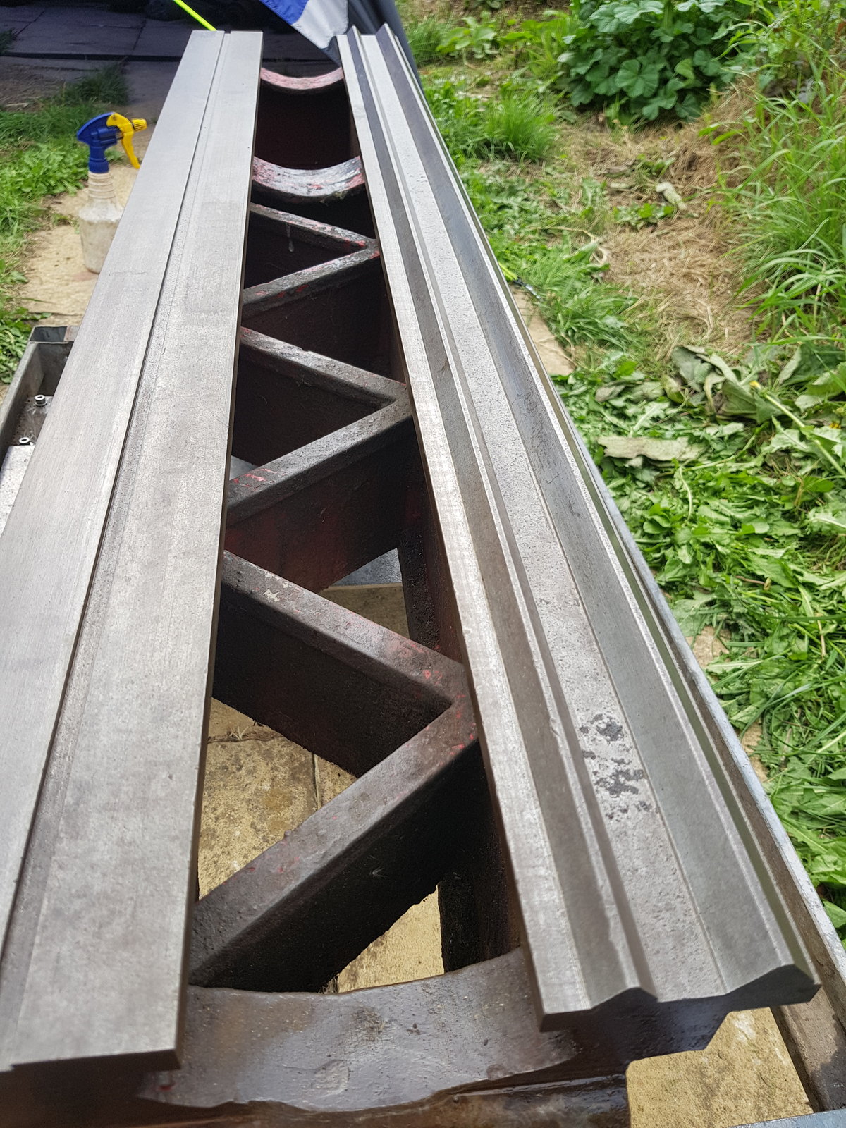

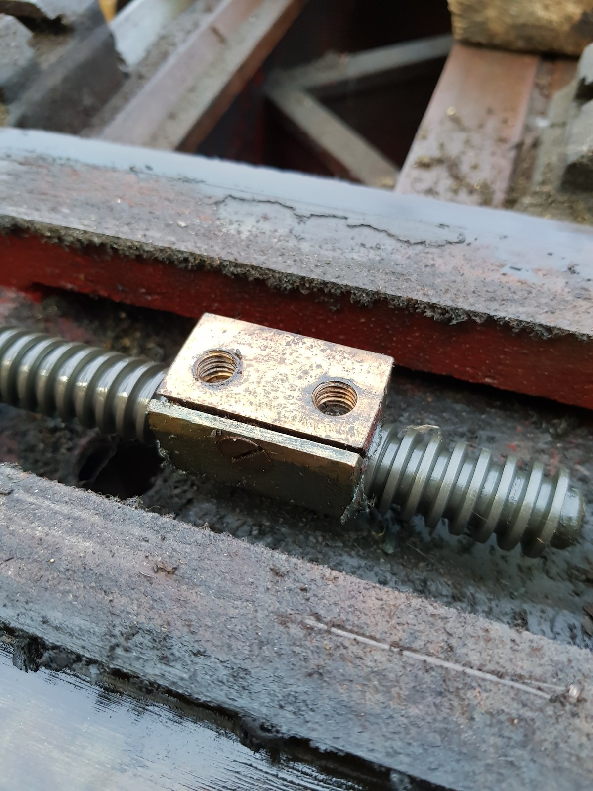

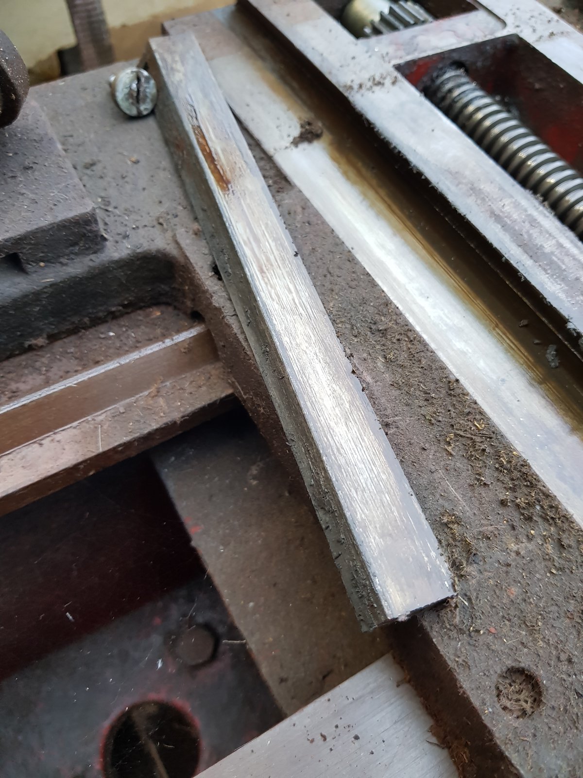

It's in good order considering it's age .Screw looks great. Slides are a bit worn at the ends but not a lot. Gib and slides need scraping.
Not much at all wrong with that under all that crap.
It is seadog. Am well chuffed to be honest. Especially what I give for it.That's looks to be in fantastic nick for an old machine.
