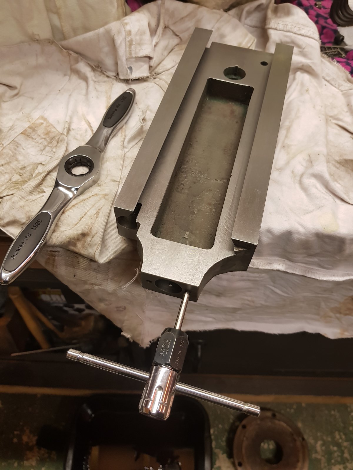

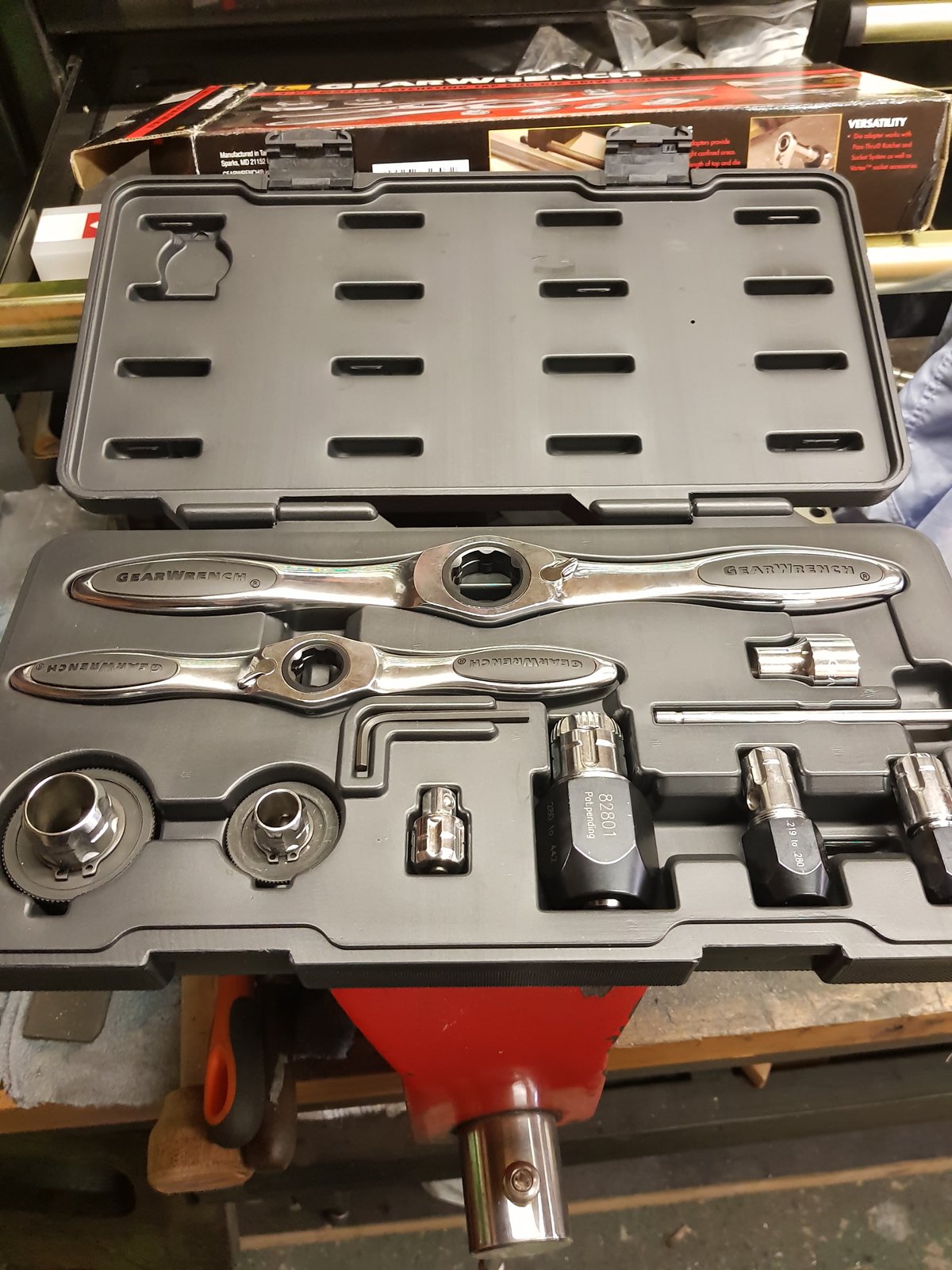

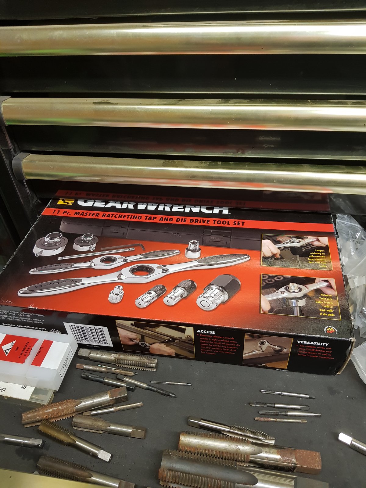

@spencer 427 Nice tap wrench, pricey I assume?
For those of you that are interested. My ratchet tap die handle set is made by gearwrench. They are great to use. I have had this set for a long while and I use them almost every day. I can't remember the price but I got them from overseas order. View attachment 158023 View attachment 158024
I think they are 150 dollars plus the shippingWow very shiny I want!
Don't look cheap though.............

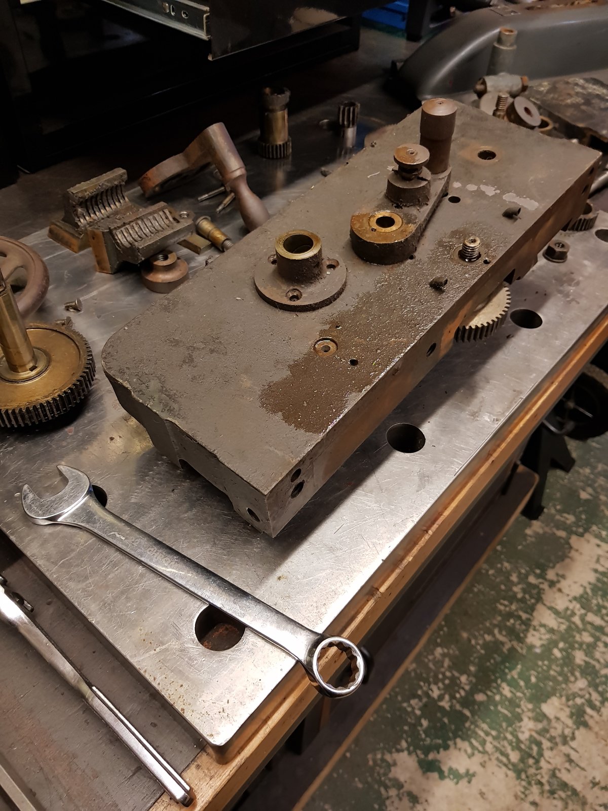

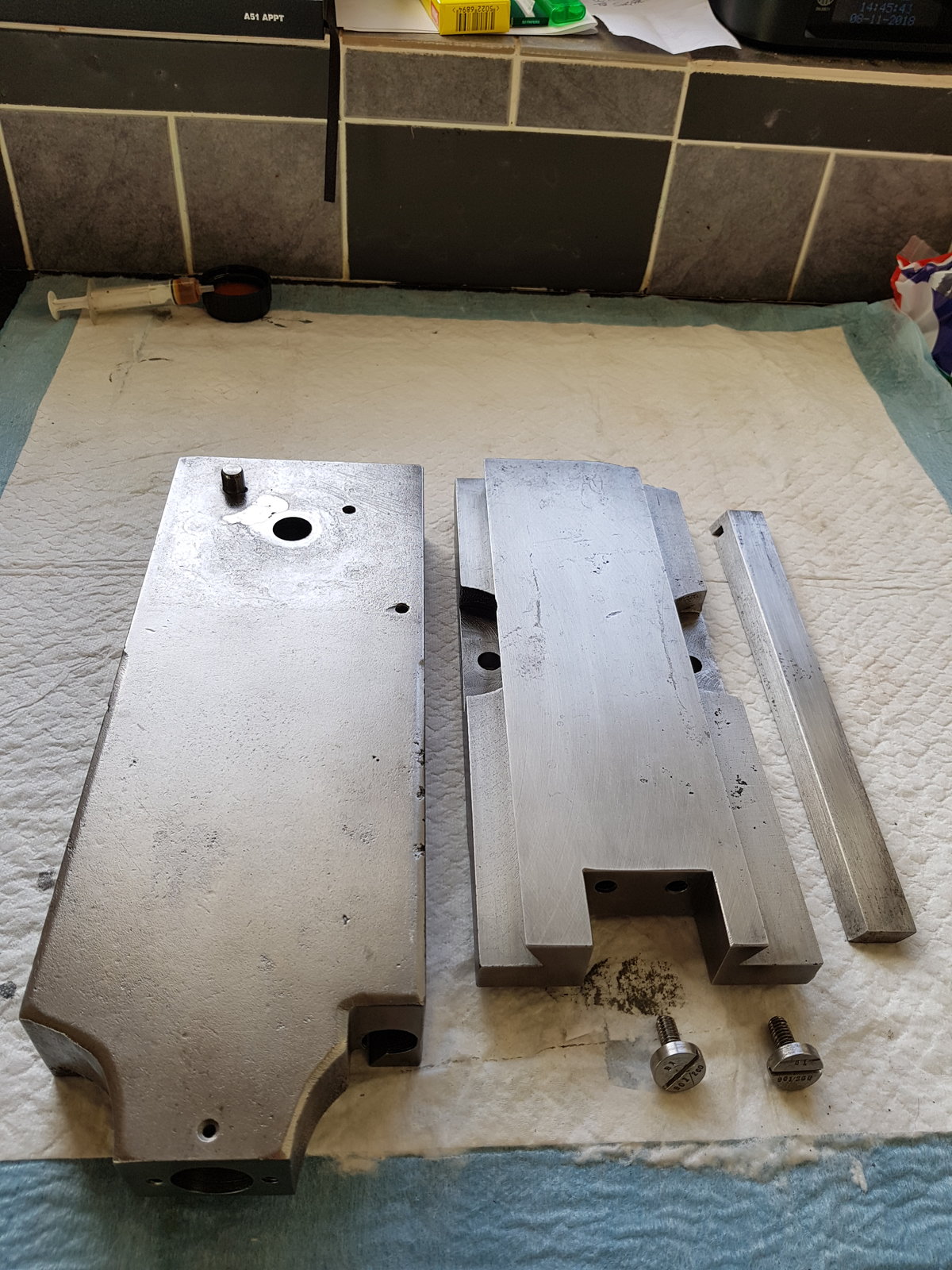

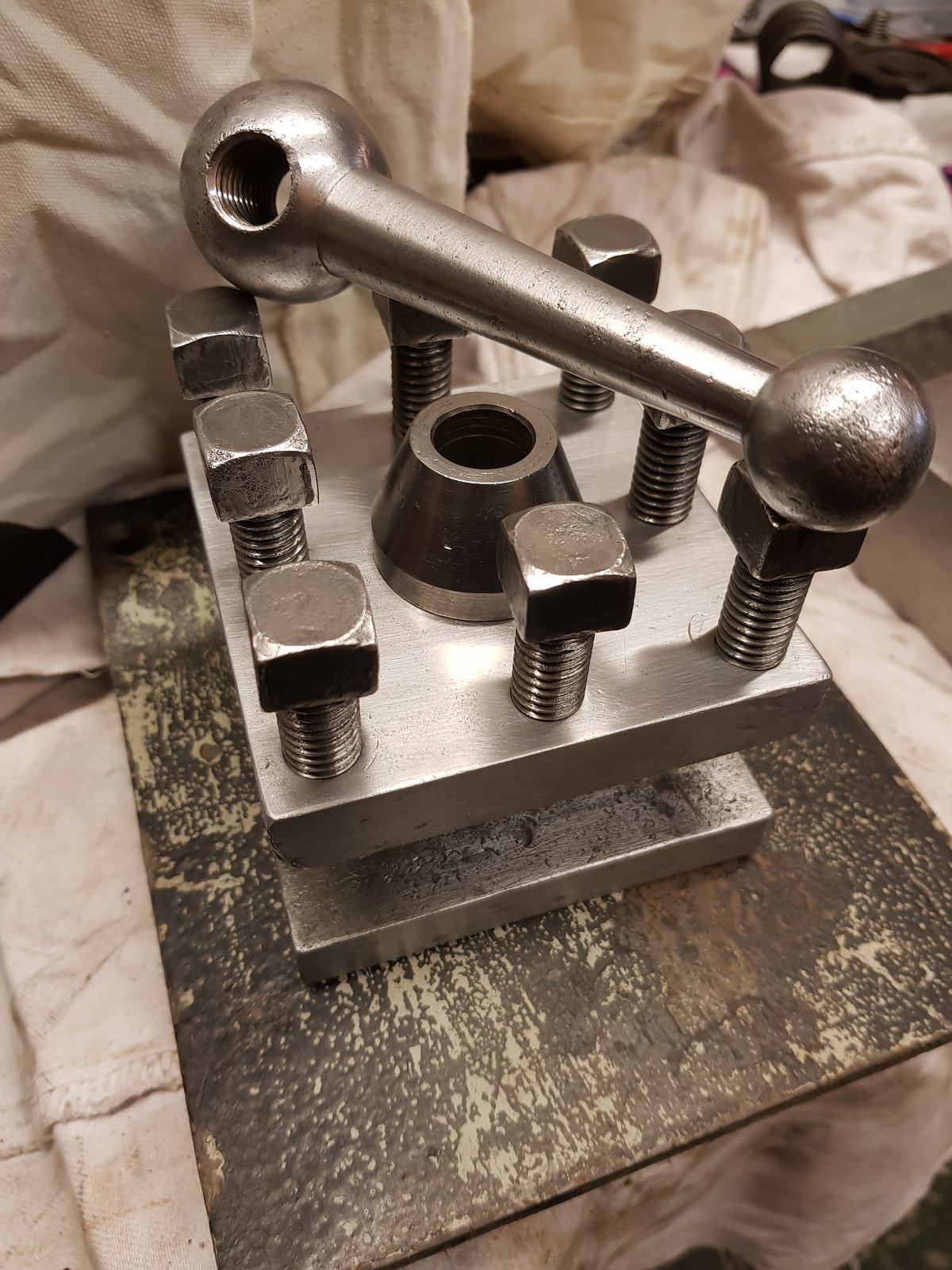

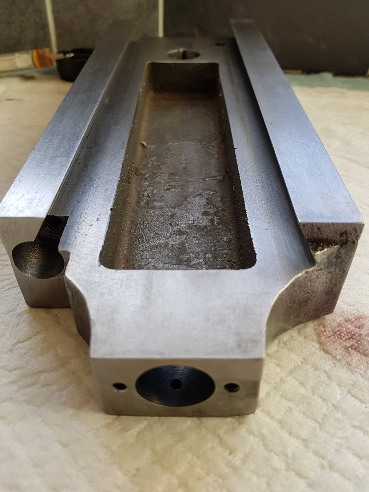

Sort of finished the toolpost. A bit more attention needed but almost done.View attachment 158032

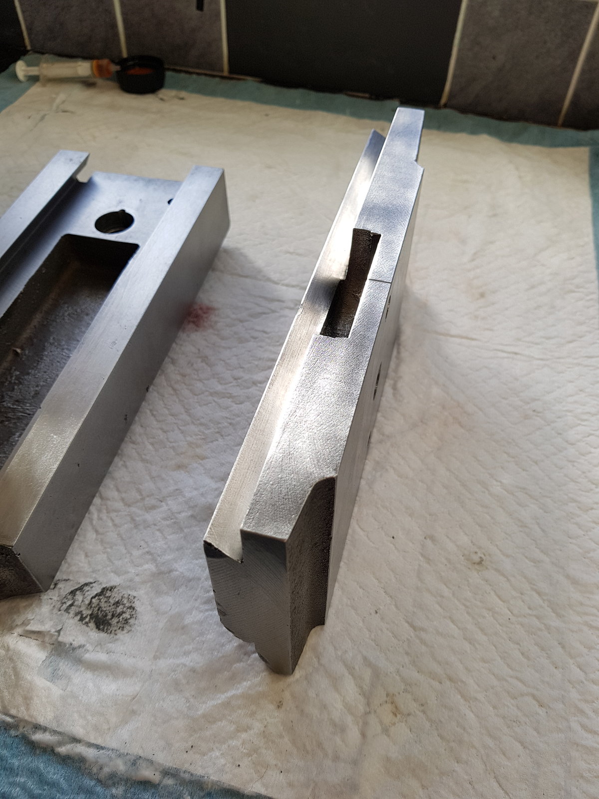

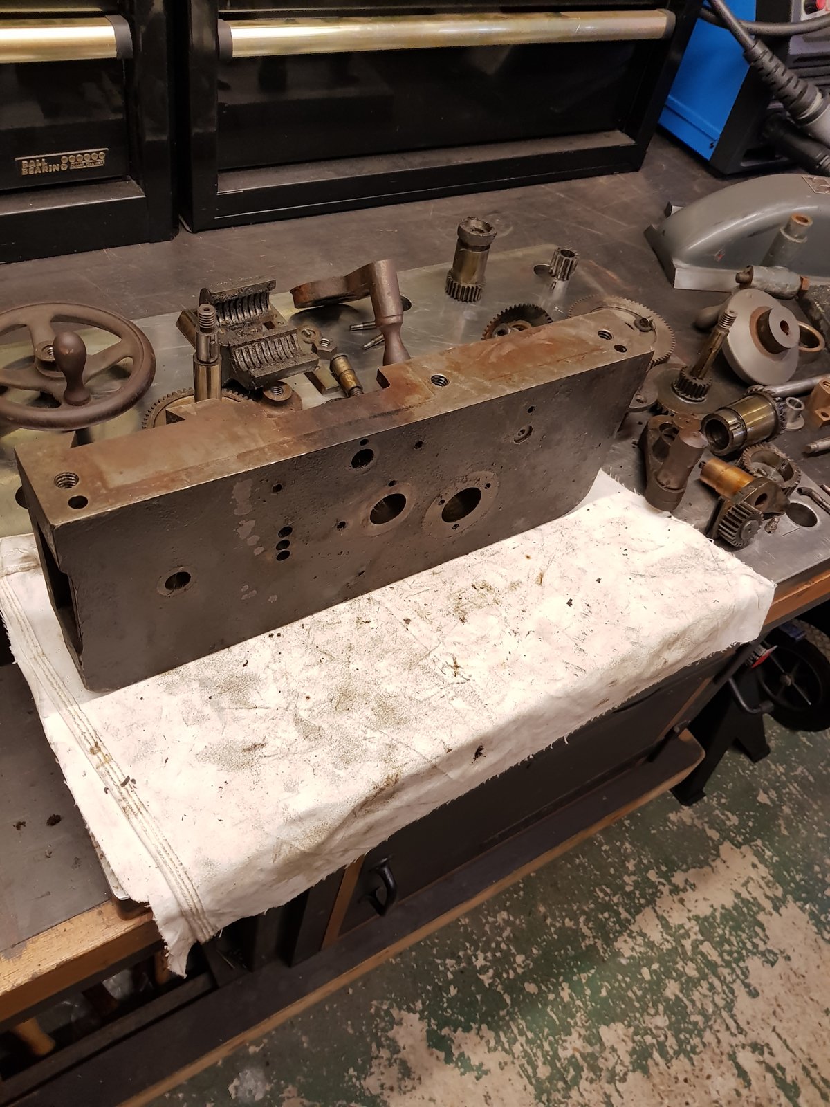

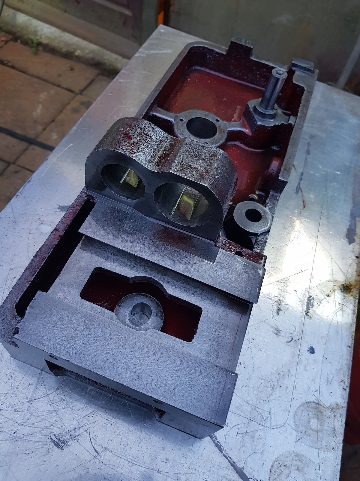

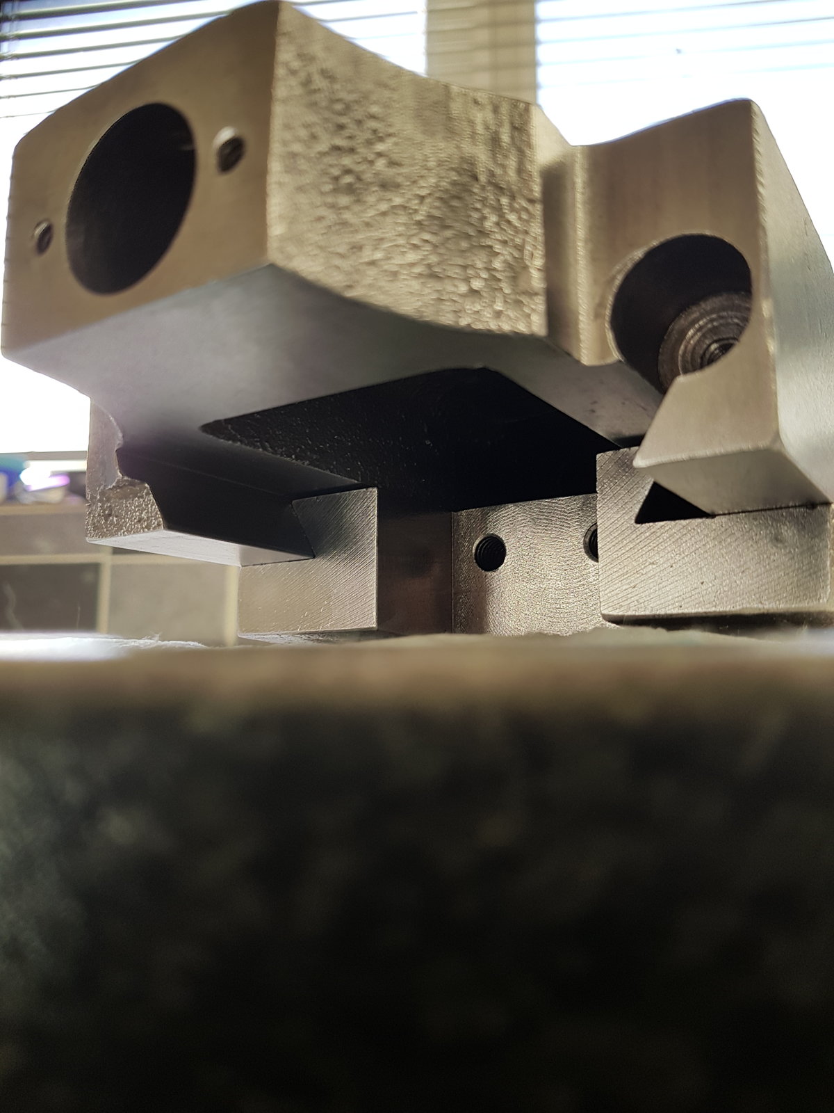

It's in good order Pete for it's age. Should be a nice job scraping them. I going to get all the other parts cleaned and ready and then I can spend the time doing themYou've still got all the machining marks in the bottom of the dovetail well. This is good because it means the face is untouched and you can use a surface gauge and indicator off that face to assess the wear on the flat bottom ways.

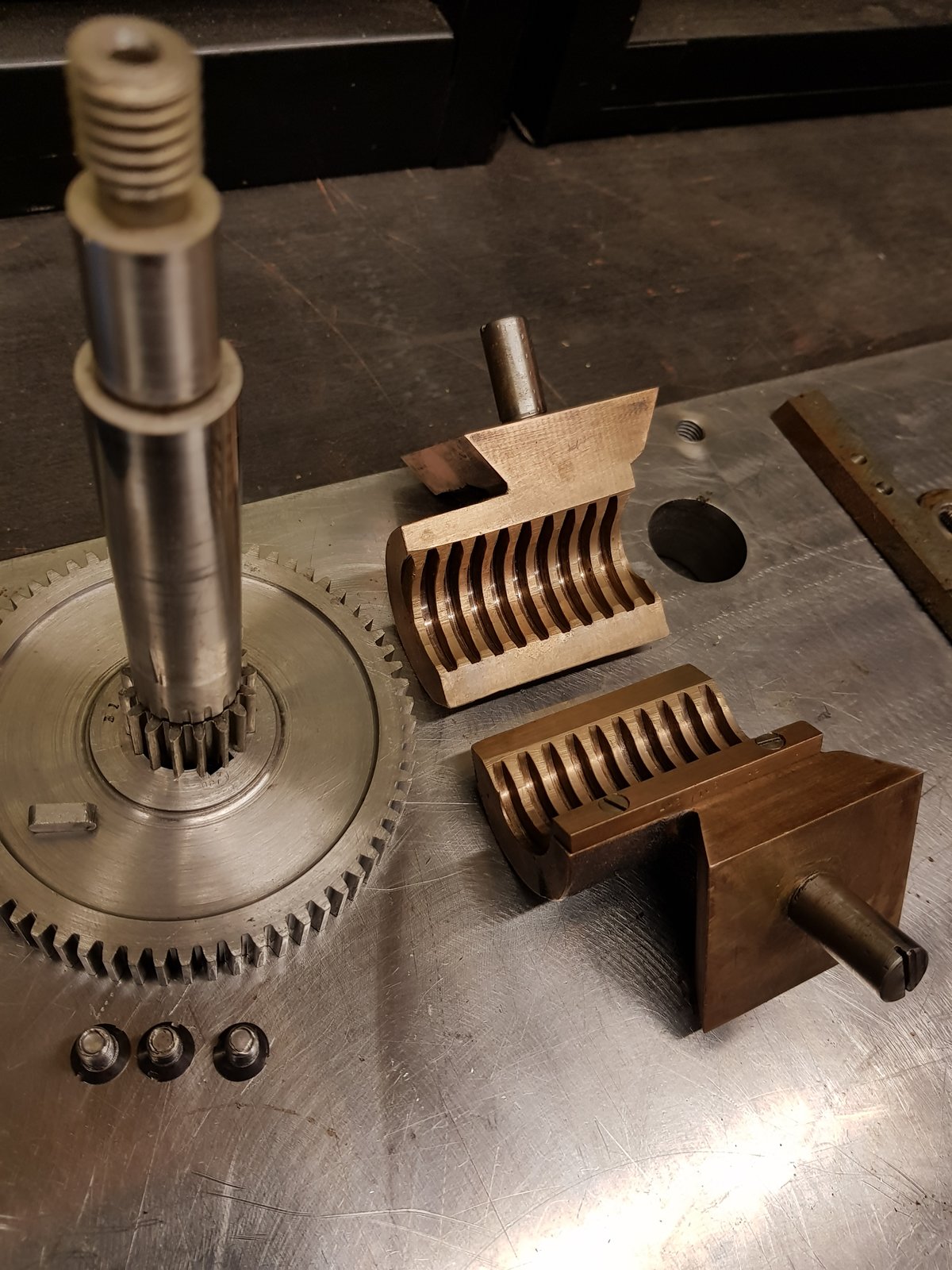

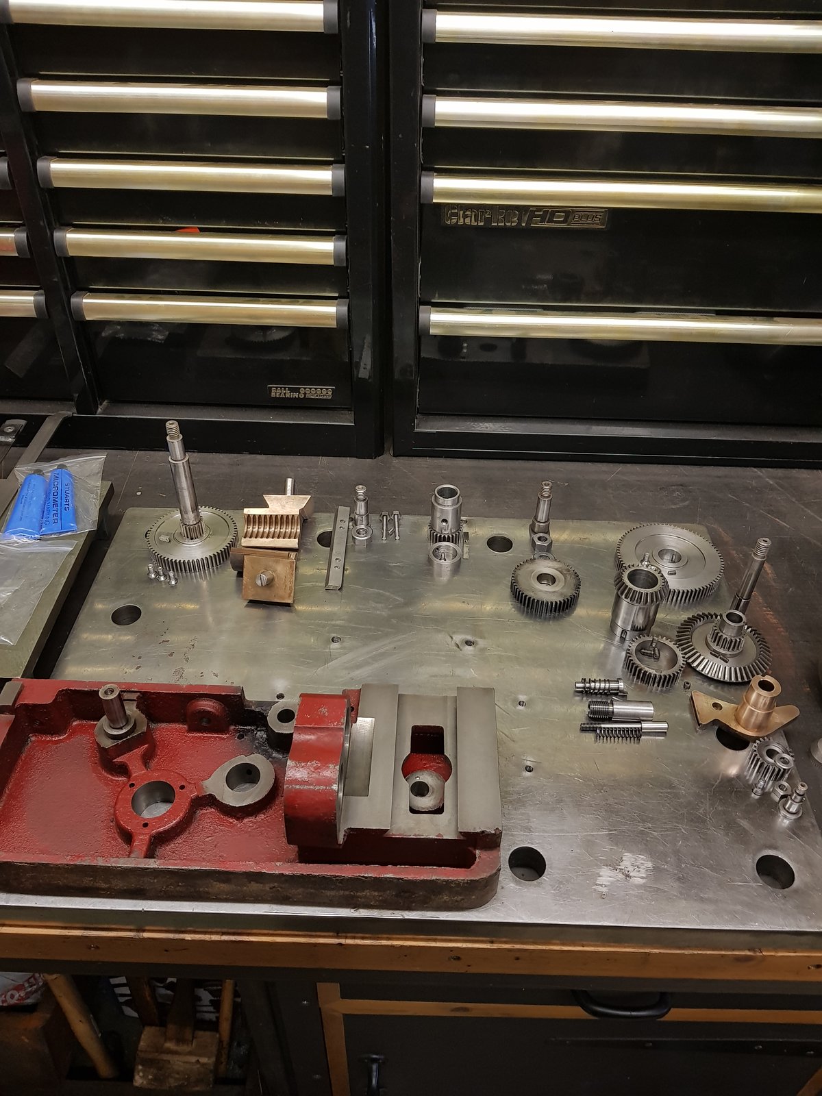

Looks like no use at all.Never seen half-nuts that looked that good without them being new.
