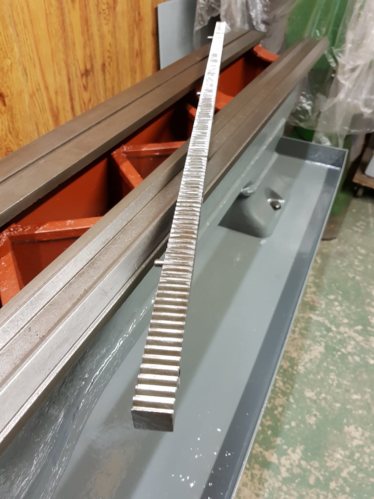

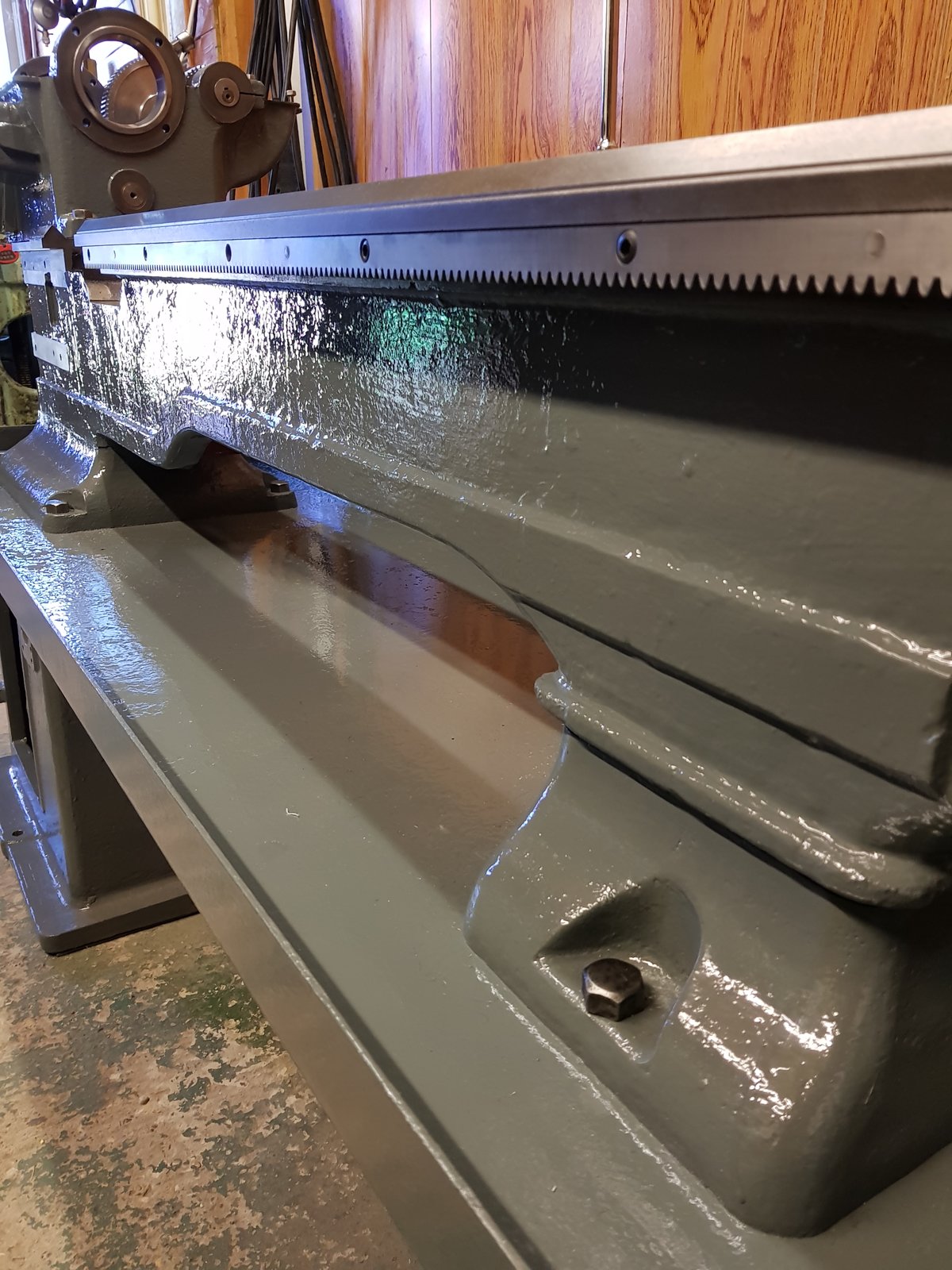

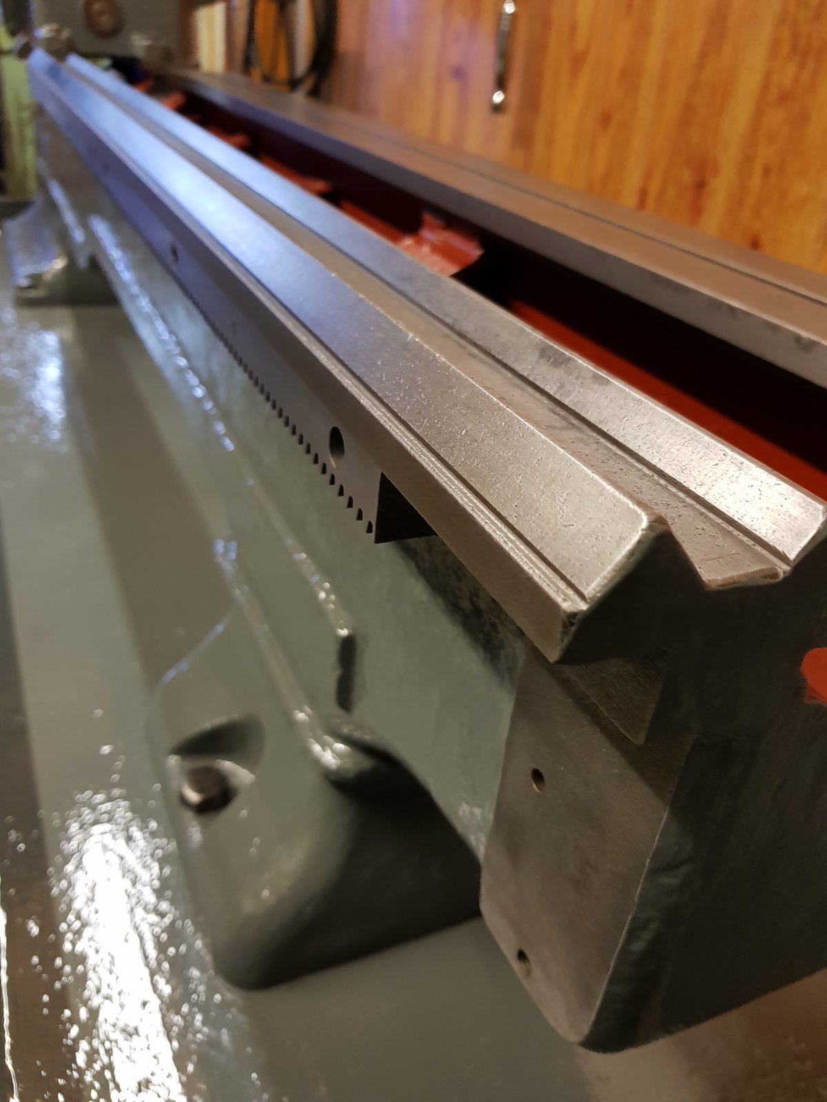

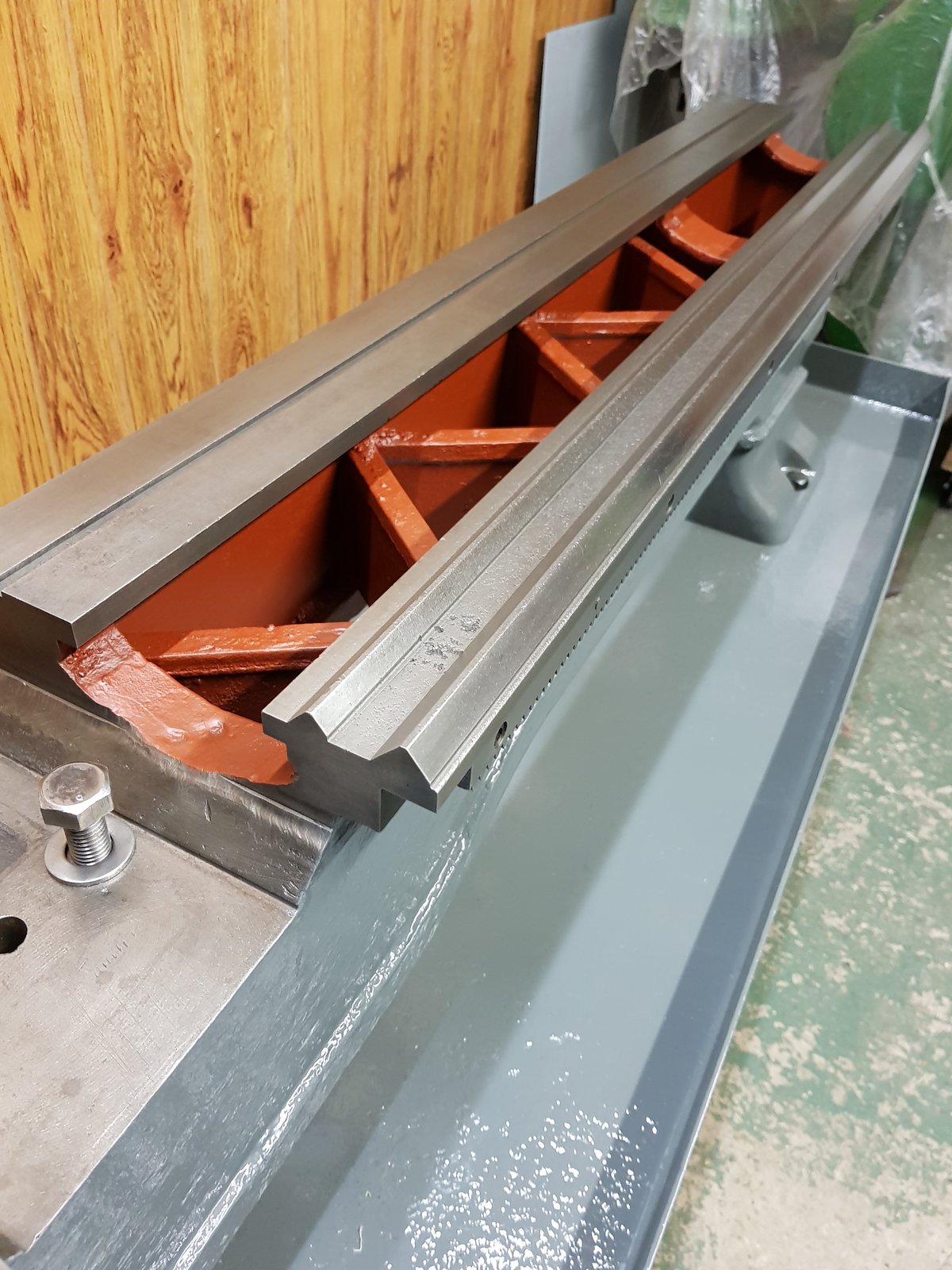

I was thinking the same thing while I hand my hands all over it.Nice rack![]()

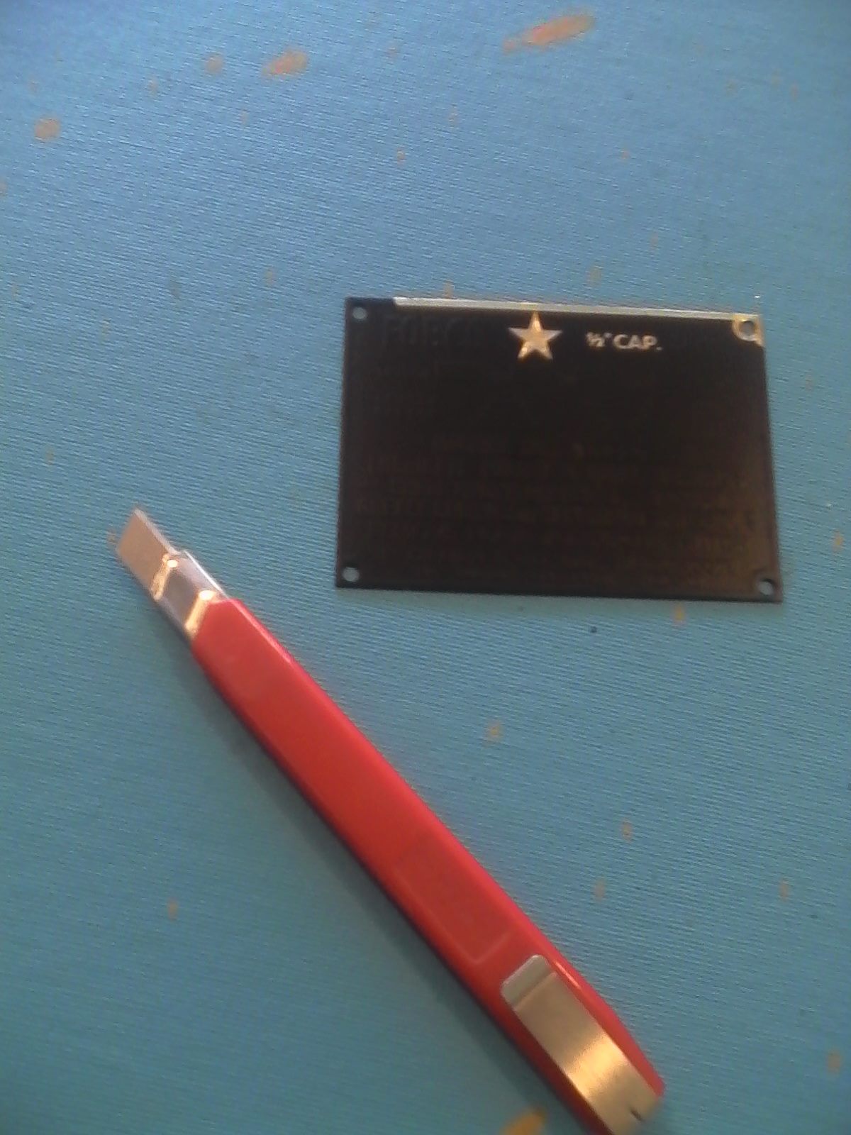

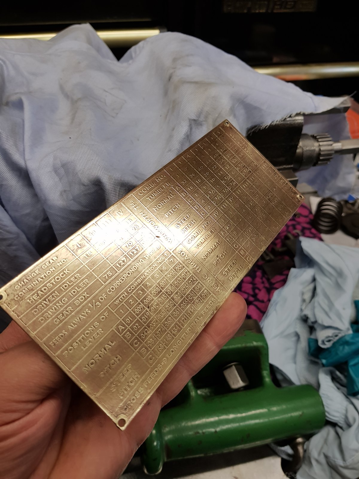

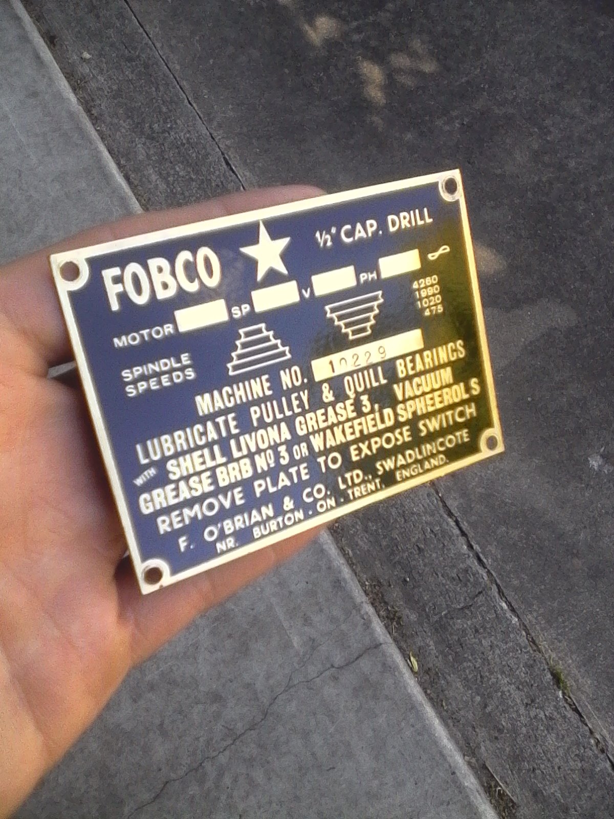

I am planning to do the same. Just getting rid of the tarnish and giving a light clean up. Then will look in to spaying itWhat's the plan for the brass plaques? I've had good success giving a uniform coat of black spray paint then slowly scraping off the raised detail with a craft knife. Give it a gloss varnish and it's good to go. Takes ages but the results are well worth it compared to just polishing, here are some from when I did the Fobco.
I am planning to do the same. Just getting rid of the tarnish and giving a light clean up. Then will look in to spaying itView attachment 155222

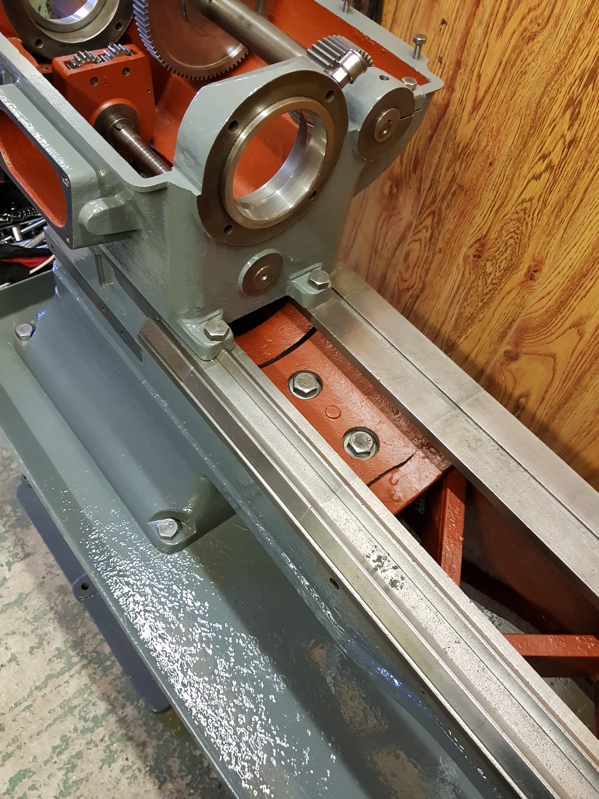

It looked the nuts a few weeks back when I saw it in piecesI can't wait to see this on Sunday![]()

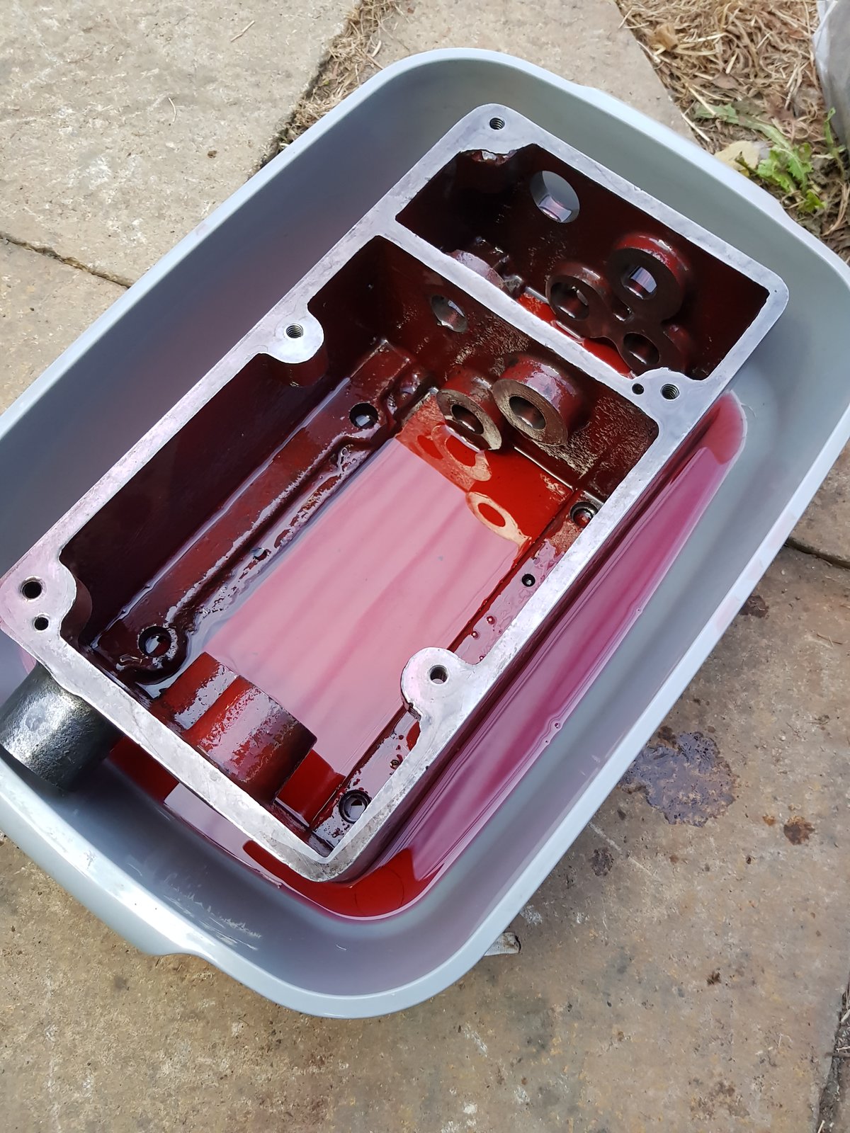

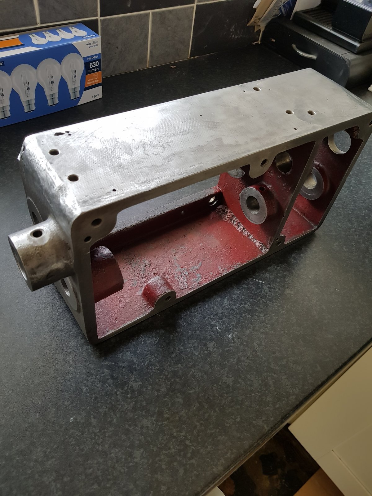

My Mrs will kill me when she realises the amount of plastic bowls I have had out the house. Still needs must.
