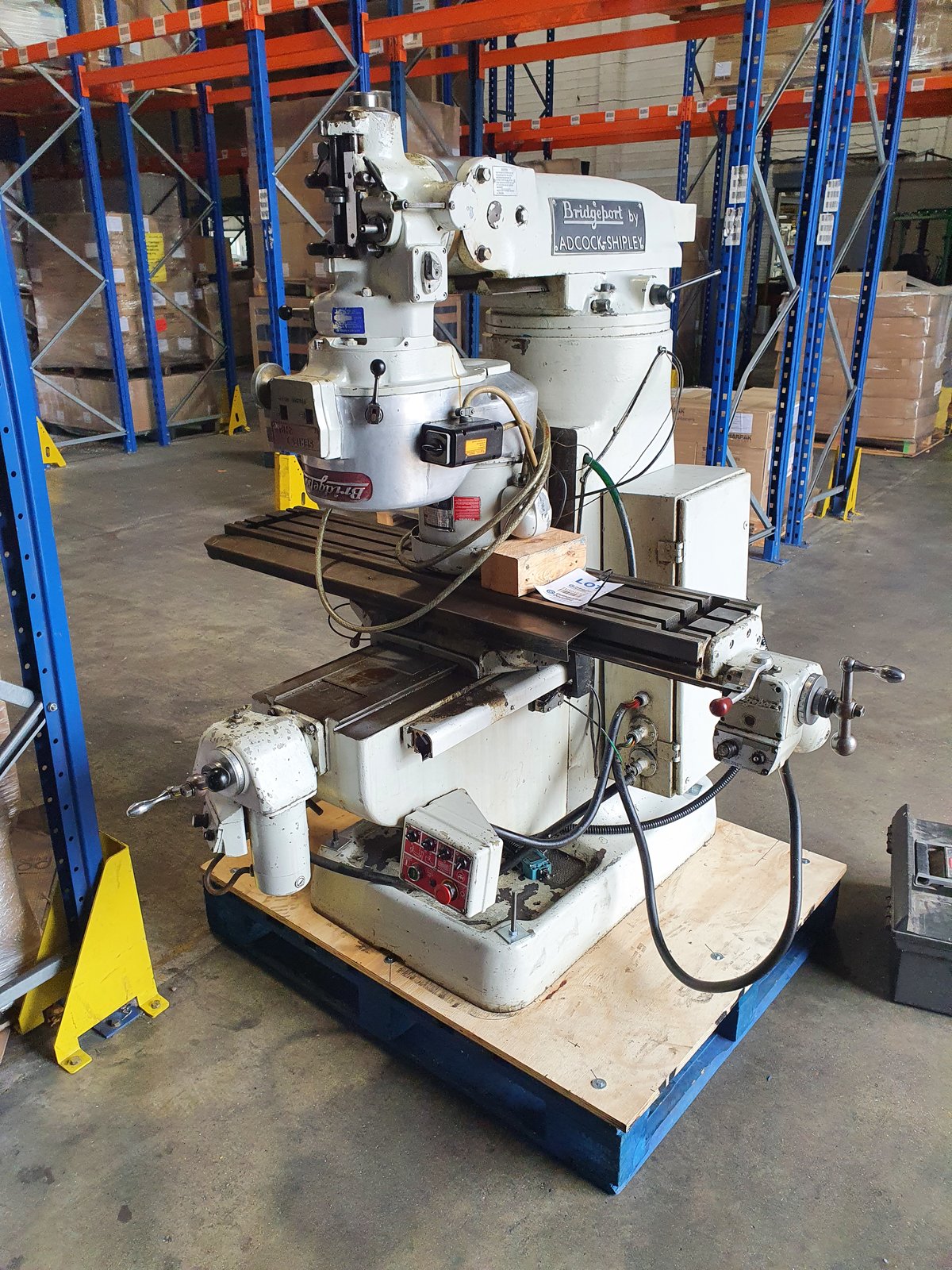

Hello everyone.
I recently acquired a Bridgeport mill from an industrial toolroom (thanks to @fizzy for the huge help with shipping and general Bridgeport advice).
Just before loading:
Anyway, I've rigged an inverter for the head which is working fine and now I'm looking at the power feed.

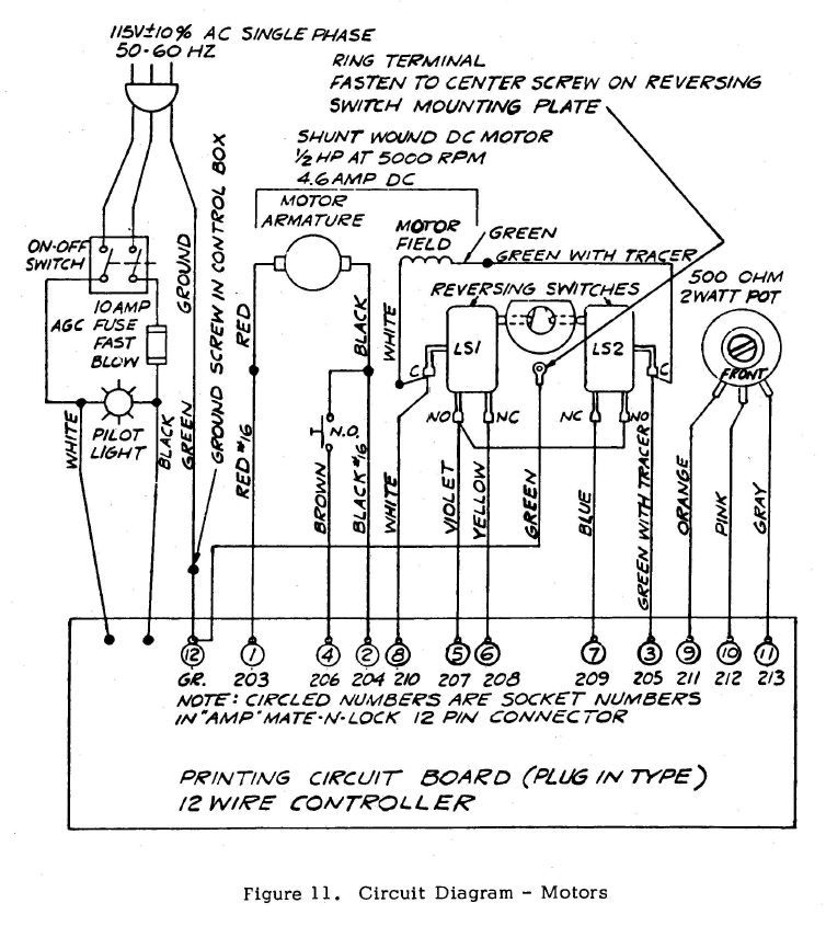

The diagram from the manual which shows the feeds running from 115v:
I've got a 2kW 110V transformer which should do both axis no problem.

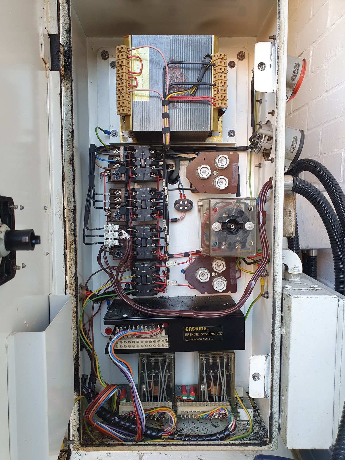

The only issues I have are; first off a sanity check incase I've got the wrong end of the stick.
Secondly, I think I've located the correct point to insert the transformer wires - the two horizontal red wires just below the centre of the pic flagged LL3 and LL1.
The box I have seems to have a fair bit more gubbins than others I've seen so if any Bridgeport experts could shed some light, I'd be most appreciative!
