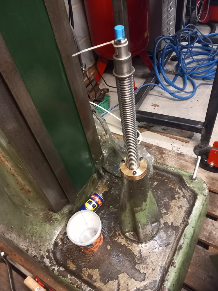

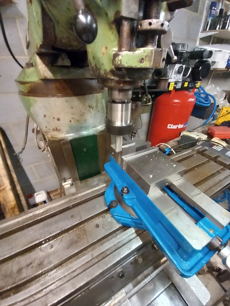

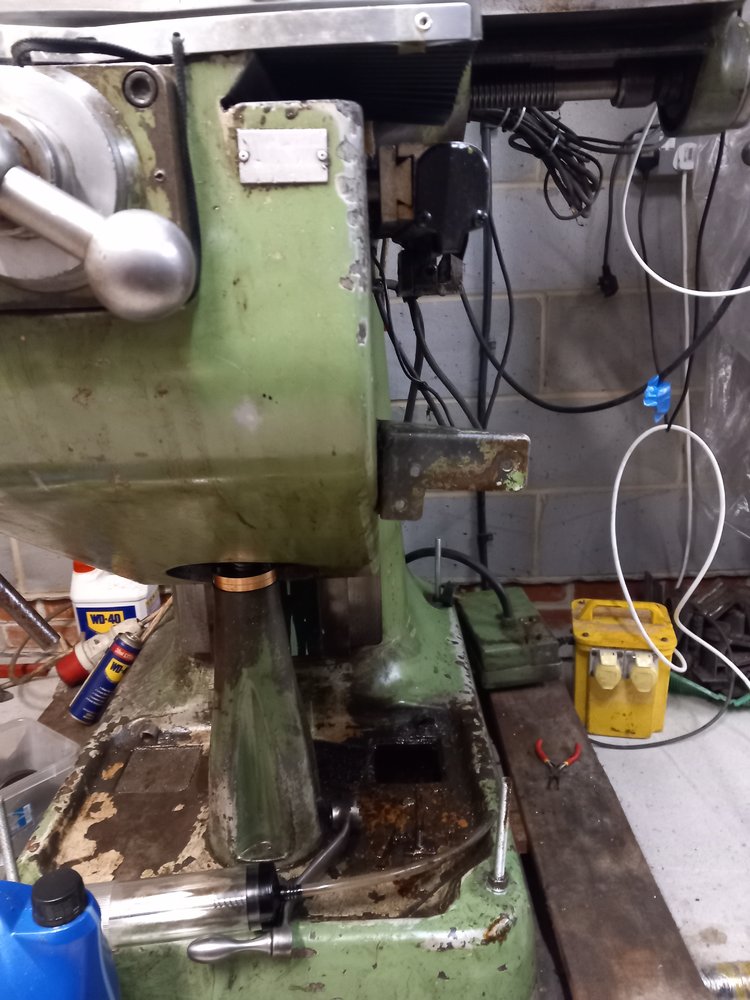

Replacement bolts for knee lifting screw. Every time I tackle a job it seems to need more parts which slows my glacial progress still further.
I also ordered some 5/16" 24 grub screws. I only needed one to replace an incorrectly dimensioned one where the grease feeds in near the top of the head.

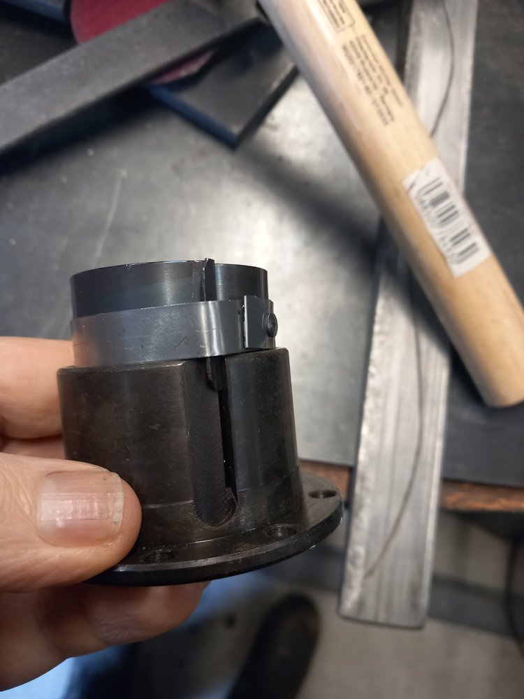

The spring case arrived today. First impressions were favourable. I was expecting a rough gash down the side. It's been done nicely though with the cut and the relief milling.

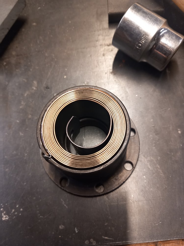

Spring tapped in no issue. A pair of pliers needed to pull off the retaining strap once the spring was three quarters of the way down.
This is where I encountered another problem.

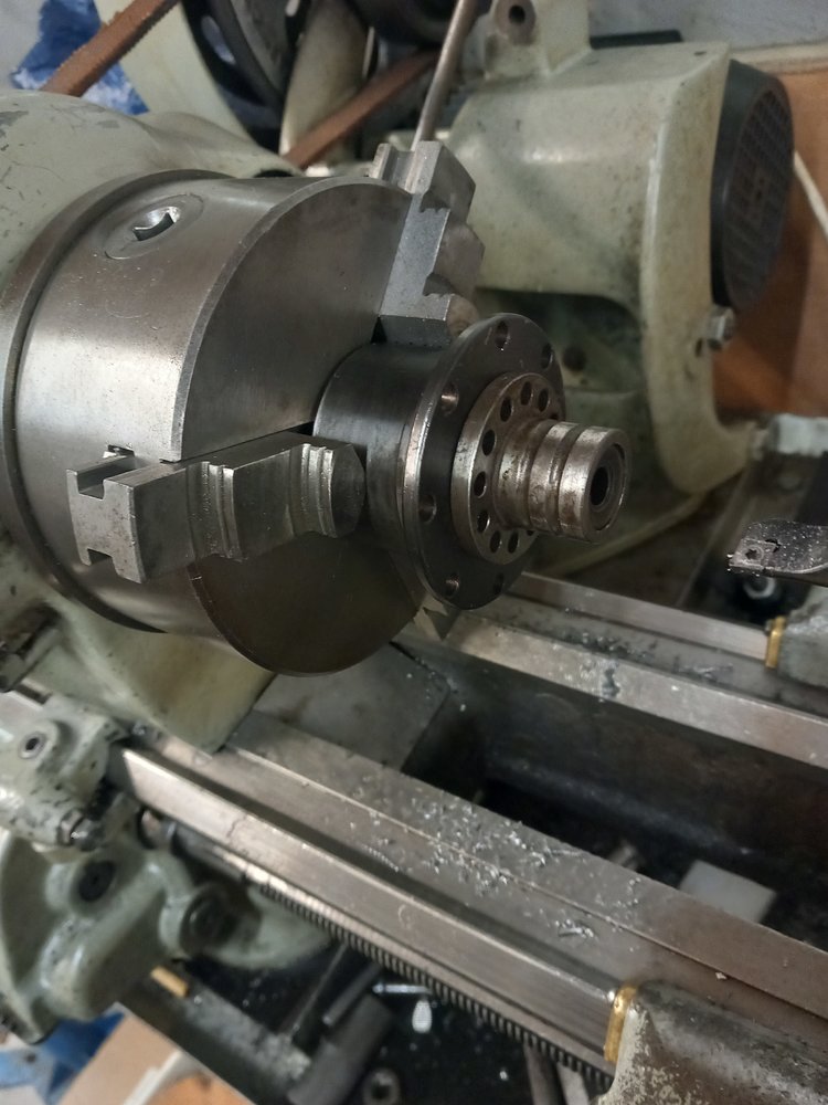

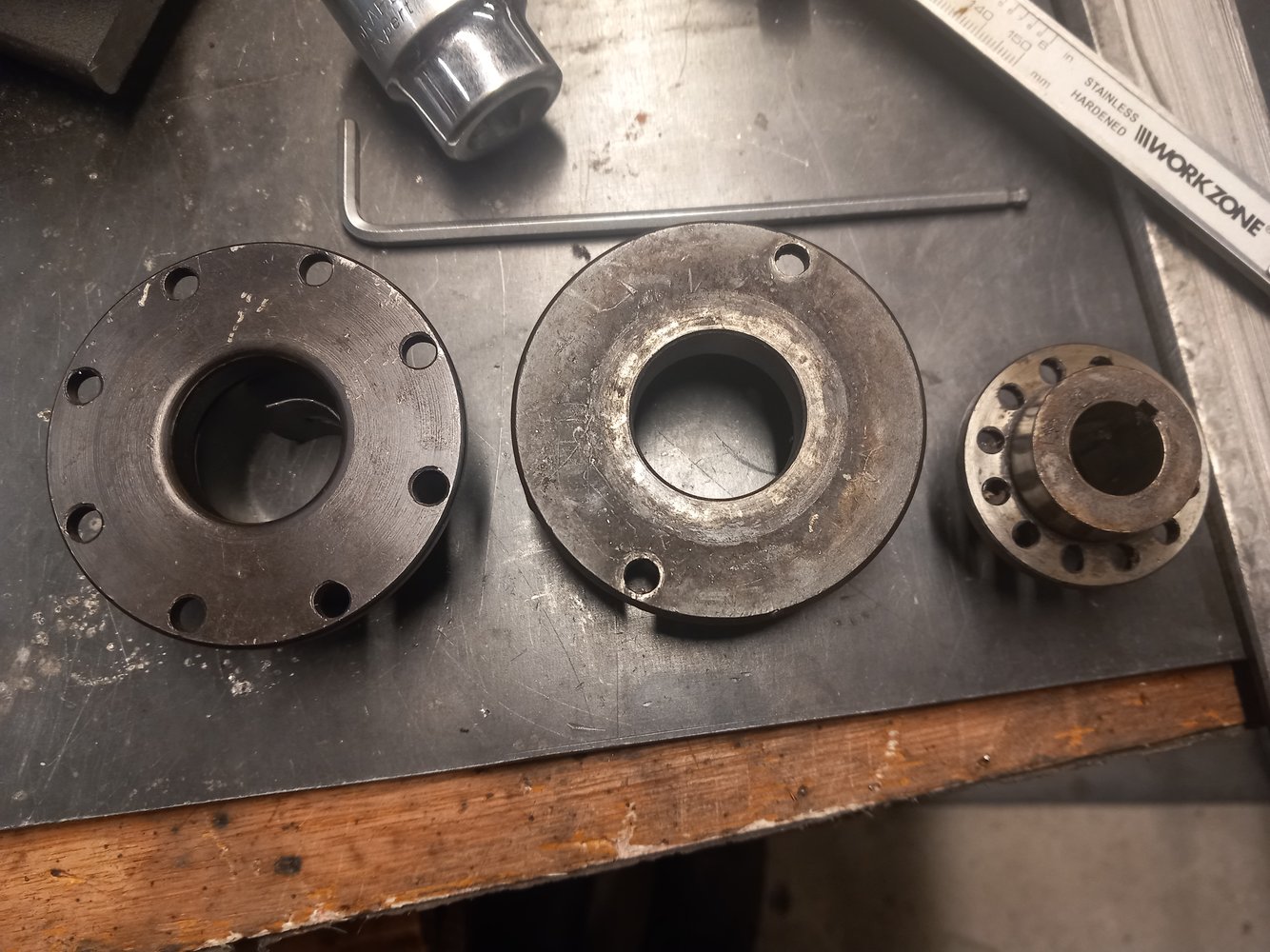

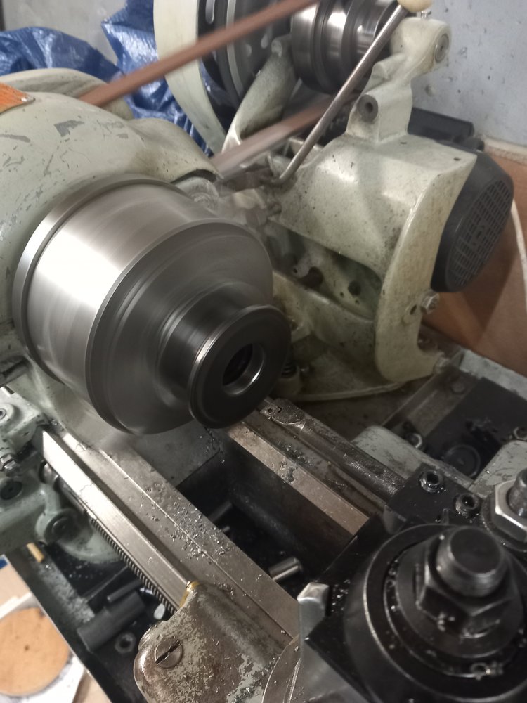

Left is the new Chinese case with the Chinese spring installed. Middle, is the original case and on the right is the part that fits in the hole in the middle. It connects the quill pinion shaft to the handle. The Bridgeport case aperture is about 28.50mm, the Chinese one is about 27.69mm depending on how my Aldi calipers are feeling. The thing on the right is 28.5mm across and doesn't fit the Chinese case.

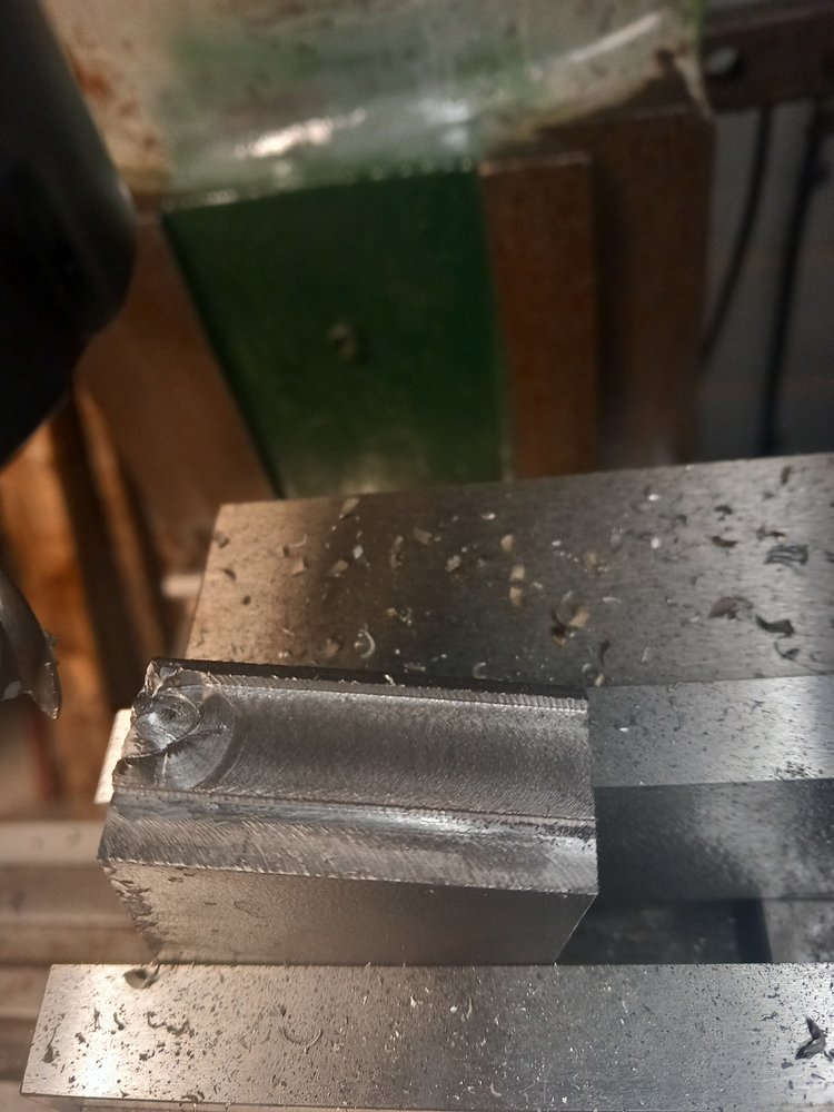

Onto the lathe. Please excuse the disgraceful amount of stick out on the tool. I do know better.
Success.
Success.
