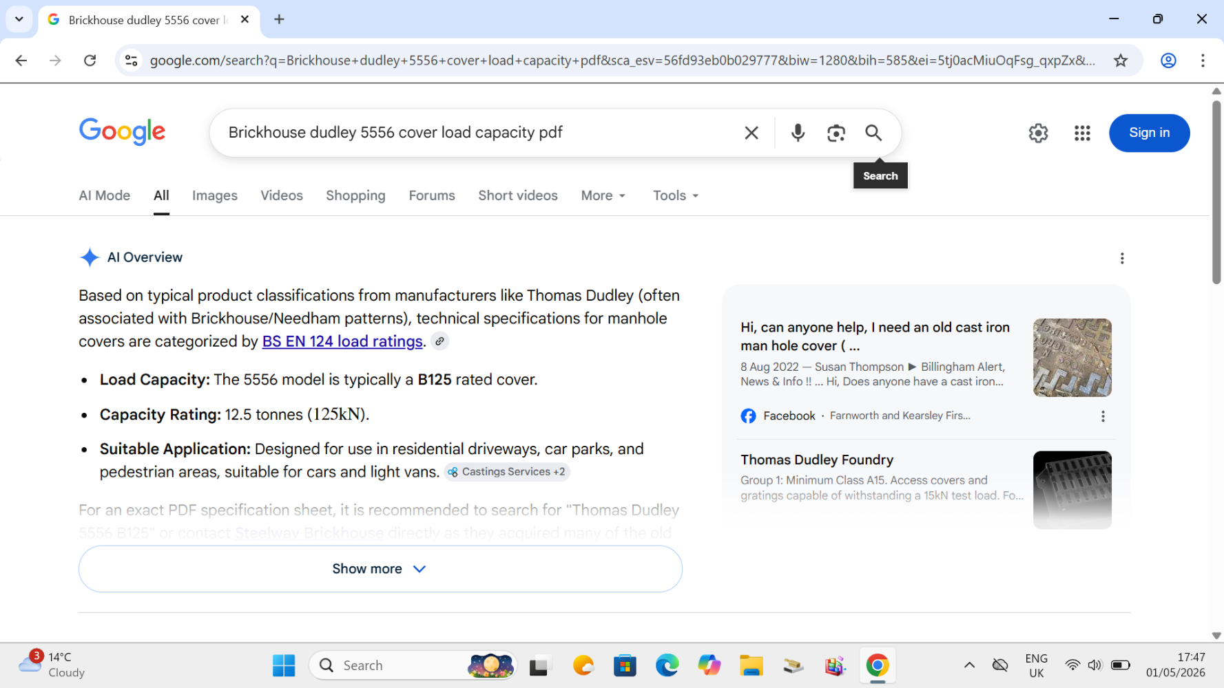

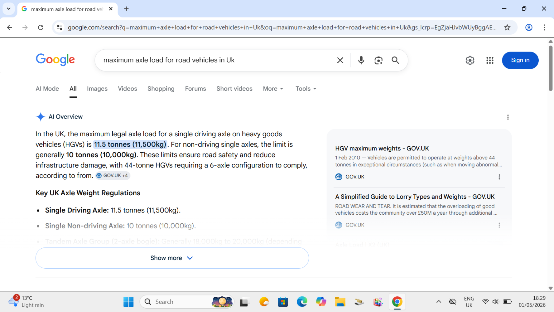

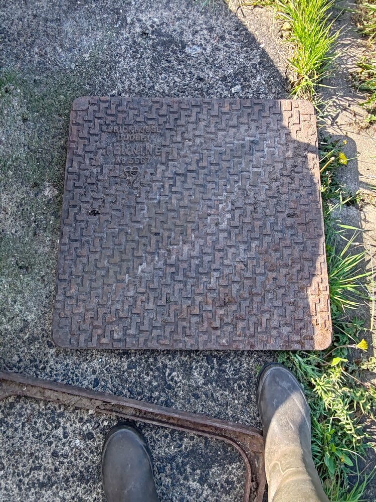

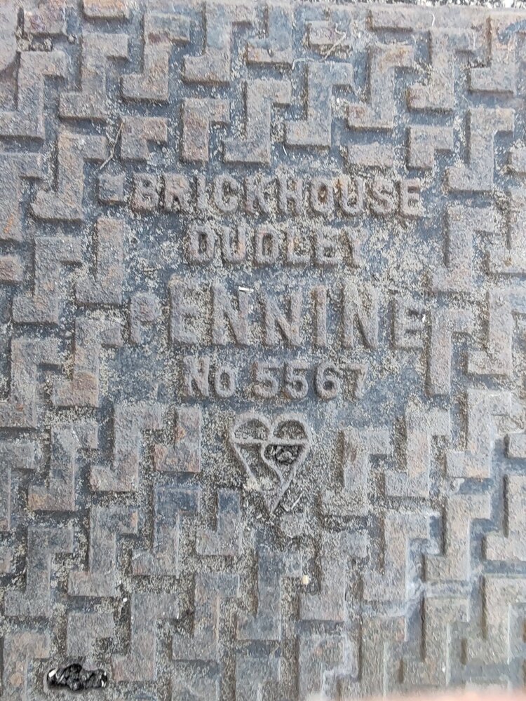

the pressed steel krap buckles with just a carAs I've got to chop some concrete out to set it in I'm thinking I might go heavier, we often have tractor/trailer combos in which can be quite weightyi have a couple on my drive and a 10tone load tipper and a skip wagon has ran over them![]()
that drain cover is only for light use not for a car or lorry its too thin
